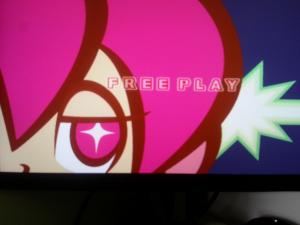

Tomkun Posted February 27, 2016 Posted February 27, 2016 Does anyone else not have Spica Adventure saving settings? Specifically I want to make it free play, but it will never seem to stick.
gigapig Posted February 27, 2016 Posted February 27, 2016 Does anyone else not have Spica Adventure saving settings? Specifically I want to make it free play, but it will never seem to stick. I think you have the luxury of being able to read Japanese. I have no idea which setting it is and could only guess. It could be two possible things. You don't have the correct exe file and an "sv" folder where the save file may be stored. Secondly and less likely, some games need an "F" drive to save game/settings data. If it's not there then it will always default back.
Tomkun Posted February 27, 2016 Posted February 27, 2016 Haha, I didn't think of that. I think I have both of those, but I'll double check later. If I tell you which option it is, would you be able to test it? Sent from my iPhone using Tapatalk
gigapig Posted February 28, 2016 Posted February 28, 2016 Haha, I didn't think of that. I think I have both of those, but I'll double check later. If I tell you which option it is, would you be able to test it? Sent from my iPhone using Tapatalk Yes sure.
Tomkun Posted February 28, 2016 Posted February 28, 2016 Many thanks! If you go into the settings menu, it should be the fourth one from the top. システム設定 (system settings) Then change the top option. There are only two, so it should be the non-default one. フリープレ (free play) The bottom menu item will exit. 戻る (back) It will ask if you want to save. Select はい (yes). Finally, the bottom menu item will reset the game. I've tried it a bunch of times, but nothing shows up in either the sv folder, or the F drive. Also, sorry to keep asking you things, but how do you stop the debug console from Half Life showing up?
Tomkun Posted February 28, 2016 Posted February 28, 2016 Never mind about the Half-Life 2 question. I found another version of the download which contains a hidedebug.vbs. Thanks to whomever made that! Now it makes me wonder if all the versions I have may be missing files and I am making things artificially hard for myself.
gigapig Posted February 29, 2016 Posted February 29, 2016 Many thanks! If you go into the settings menu, it should be the fourth one from the top. システム設定 (system settings) Then change the top option. There are only two, so it should be the non-default one. フリープレ (free play) The bottom menu item will exit. 戻る (back) It will ask if you want to save. Select はい (yes). Finally, the bottom menu item will reset the game. I've tried it a bunch of times, but nothing shows up in either the sv folder, or the F drive. Also, sorry to keep asking you things, but how do you stop the debug console from Half Life showing up? OK I have done that and it now has freeplay and the file "Spica.dat" in the sv folder. So it's possibly the exe you are using.
Tomkun Posted February 29, 2016 Posted February 29, 2016 Thanks for checking it out for me. Looks like I'm going to have to go back to the drawing board.
