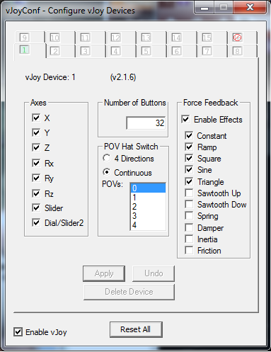

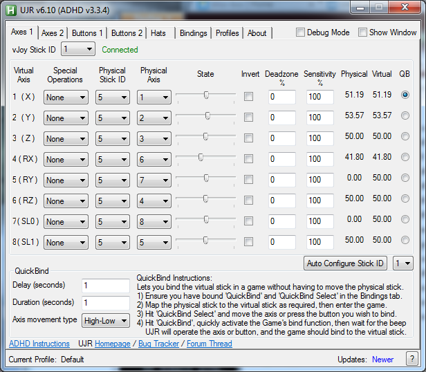

ulao Posted March 16, 2016 Posted March 16, 2016 It will work its just going to take someone with a lot of time on there hands to use the various tools that are out there. All you need is to search for "v-joystick" or "virtual joystick" and make sure it excepts multiple inputs. Once we get that, then everything maps to the v-joystick. I think the was the best one but I forget what troubles I had. https://autohotkey.com/board/topic/89279-ujr-universal-joystick-remapper-using-vjoy/ I think you need to download ujr and vjoy https://sourceforge.net/projects/vjoystick/files/latest/download update: I just gave it a test and did an auto config on joystick 1, and now I remember, it is not showing any responses. I guess ill play with it for a bit. update2: -Ahh, update: ok I got it. The problem here is that the Bliss-box shows up on some random id. I did an auto config on 5, and its working. -There is sort of an update, issue, when setting analogs you may have to click on another analog to get it to stick (like EpsxE). -Seems to be a bug that prevents RY, dial from working (or there last two 7 and 8 ). All other analogs map oik. -Also there is a limit to application, that lets you use it for certain emulators or HS's menu if that is desired. update3: There is an automatic profile switching, so I'm thinking its like xpadder where it loads the profile when the controller is in. It also lets you save profiles but I can not find where? Looks like you must also configure vjoy. This maybe the issue I'm having the the missing stuff.
ulao Posted March 16, 2016 Posted March 16, 2016 Ok ill start a mini tutorial in this reply. I'd edit it often, until I get a nice tips section. I'm no walkthru guy but I will try. tips: 1) you need to leave UJR running. 2) this is not much good for buttons use xpadder or joy2key for that. downloads main app https://autohotkey.c...per-using-vjoy/ vjoy https://sourceforge....latest/download set up vjoy. run C:\Program Files\vJoy\x64\vJoyConfig.exe this may take 20 seconds to run. Its a one time thing, this is what I did. then set up UJR ( yes 8 and 7 are broke) I'm not sure why yet? You need 8 for psx pressure (not a big deal) and 7 for psx or GC second y axis. That may be an issue for some. I think this is a bug with UJR. (ID 5 may not be right for you) The 4-play fix may help with this ID confusion. then go to the buttons. Just auto map all of the same ID. This fills out both pages. I believe at this point you can go to the axes 2 page and set up the 360. Then go to the profile tab and click enable automatic profile switching. Add a profile and name it. Then you can go to the controller in the controller panel and you will see vJoy Device. Everything you do to the port you mapped it to , show up in here. Note: I do not think you can pad 360 buttons and bliss-box button to one vjoy. Looks like they need to be one physical button to one virtual button? So it may be best to keep the xpadder set up and just use this to combine analogs. I do not have a 360 set up here so I can not try it.
