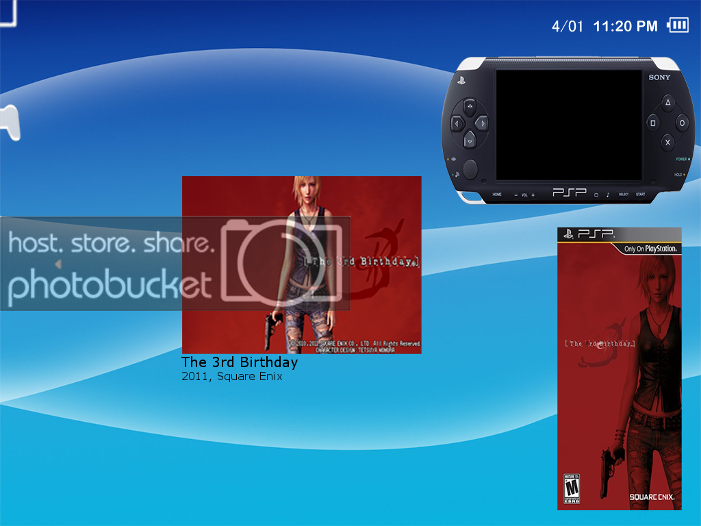

Attack_theTITANS Posted April 2, 2016 Posted April 2, 2016 I've been working on this PSP theme to make it look like the PSP XMB, and I pretty much have it the way I want it, except for one thing. I can't figure out how to make the clock. I know it should be a flash clock and I've tried for a couple of days following tutorials with no luck (I'm not much of a coder). Here's the theme with a clock mockup done in photoshop, if anyone can point me in the right direction or code a quick clock that would be great. I plan on uploading it to the "Downloads" section to share when I'm done if anyone wants to use it. Anything would help, I'm lost lol. Oh and the game info text is the same color as the PSP icons now

dark13 Posted April 2, 2016 Posted April 2, 2016 This is the code for clock and date var now:Date = new Date(); var hours = now.getHours(); var minutes = now.getMinutes(); var ampm ; if (hours >= 12) { ampm = "PM"; } else { ampm = "AM"; } if (hours > 12){ hours = hours - 12; } if (hours == 00){ hours = 12; } if (hours < 10){ hours = "0" + hours; } else { hours = hours; } if (minutes < 10){ minutes = "0" + minutes; } else { minutes = minutes; } total_txt.text = hours + ":" + minutes + " " + ampm ; var day = now.getDate(); var tday = now.getDay(); var year = now.getFullYear(); var month = now.getMonth(); var mArray:Array = ["JAN", "FEB", "MAR", "APR", "MAY", "JUN", "JUL", "AUG", "SEP", "OCT", "NOV", "DEC"]; var dArray:Array = ["Sunday", "Monday", "Tuesday", "Wednesday", "Thursday", "Friday", "Saturday"]; datetotal_txt.text = dArray[tday] + " | " + mArray[month] + " - " + day + " - " + year ; It is using 2 dynamic text datetotal_txt (date) and total_txt (clock). Set the swf to loop or the clock won't update. Probably it is better to just edit the template posted in the tutorial thread. Automatizing infopanels creation from .csv files for HTPCs themes (look at infopanel tutorial.zip on the ftp in dark13 folder) PNGs to SWFs automatized flash scripts Hyperspin Wheelset automatized template (photoshop's variables + batch) Aeon nox 4.13 W.I.P. hyperspin skin
