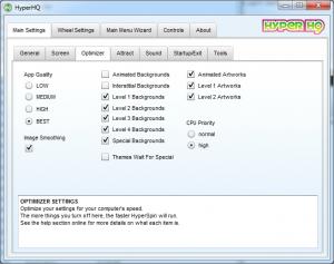

justice999 Posted March 27, 2015 Posted March 27, 2015 Sorry to bump this old thread but I was having the same issues since 2 months with HS 1.3.2.0: a very laggy hyperspin (especially when browsing themes) and multiple Hyperspin.exe processes running at the same time. My specs: [email protected]/GTX580/8Gb of RAM/Win7 64bits. Slowdown were almost fixed when I set App Quality to High instead of Best, but I was still having some and hyperspin.exe to kill from time to time. I downgraded to hyperspin 1.3.0.0 (found on EmuCR website) and so far so good! No more problem with App Quality to High. I can't believe it I would like to try the 1.3.1.0 version, can someone upload HyperHQ.exe and HyperSpin.exe somewhere? Thanks in advance.
gigapig Posted March 27, 2015 Posted March 27, 2015 Sorry to bump this old thread but I was having the same issues since 2 months with HS 1.3.2.0: a very laggy hyperspin (especially when browsing themes) and multiple Hyperspin.exe processes running at the same time.My specs: [email protected]/GTX580/8Gb of RAM/Win7 64bits. Slowdown were almost fixed when I set App Quality to High instead of Best, but I was still having some and hyperspin.exe to kill from time to time. I downgraded to hyperspin 1.3.0.0 (found on EmuCR website) and so far so good! No more problem with App Quality to High. I can't believe it I would like to try the 1.3.1.0 version, can someone upload HyperHQ.exe and HyperSpin.exe somewhere? Thanks in advance. These are my settings but I do run HS from an SSD. I will put Version 1.3.1 of HS in my folder.

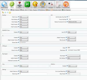

gigapig Posted March 27, 2015 Posted March 27, 2015 Mine does the same sometimes, and it's probably the last problem that really annoys me but I can't understand why. It's not just the fact that the taskbar pops up it's also that Hyperspin looses focus and I have to left click (I do have restore and click set in HLHQ btw.) So here's what I know. It may be something to do with xpadder? Also turn Hide Taskbar to false in HLHQ may help. Are you using the Startup Script? Undertows' suggestion is good but I would rather find the cause before using that method.
gigapig Posted March 27, 2015 Posted March 27, 2015 I've been looking for this post for a while and finally found it. Give this a try as well. http://www.hyperspin-fe.com/forum/showthread.php?34114-Hyperspin-loses-focus-when-exit-emulator&p=346415&viewfull=1#post346415
justice999 Posted March 27, 2015 Posted March 27, 2015 I don't know if it's related to xpadder, but that kind of problem only appear when I leave RetroArch emulator, never MAME for example, so maybe it's a module problem... I've already tried to Hide Taskbar, I dont remember that it fixed my problem, I will try it again later. I'm not using any script, I think that I've read about it, what it is exactly? Undertows' suggestion can be helpful but I dont like to hide taskbar while using Windows, maybe a script that would hide taskbar when launching HS could be nice. Thanks guys.
