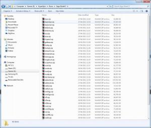

gigapig Posted August 23, 2013 Posted August 23, 2013 Here is my list of Roms. The setup is exactly the same as Mame just set global, Default Emu and rom path. yes Please post your settings.
lukebrynycz Posted August 23, 2013 Author Posted August 23, 2013 Here is my list of Roms.[ATTACH=CONFIG]31066[/ATTACH] The setup is exactly the same as Mame just set global, Default Emu and rom path. yes Please post your settings. Cheers. The only thing I have noticed, is that the roms are in the emulators root directory, instead of in a rom path like the others, but the config file DOES reflect this. Perhaps worth trying to move them to the rom directory like all other emulators and modify the ini?
