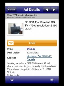

Luckydogg420 Posted December 18, 2013 Author Posted December 18, 2013 For the back glass I'm going to find a cheap 32" tv. Probably something used. I found a cheap tv. Pd $100 for it. But it turns out to be a 37". I didn't look to closely at it. I just made sure it worked, and gave them the cash. The screen is 32" wide. Will this look to big as a back box? What do you guys think. I don't see another build with a 46 PF and a 37 BB.
wowter Posted December 20, 2013 Posted December 20, 2013 [ATTACH=CONFIG]36274[/ATTACH]I found a cheap tv. Pd $100 for it. But it turns out to be a 37". I didn't look to closely at it. I just made sure it worked, and gave them the cash. The screen is 32" wide. Will this look to big as a back box? What do you guys think. I don't see another build with a 46 PF and a 37 BB. I think that a 37" mounted normally will look weird. An actual backbox is no more than about 25-26 inch wide. You could consider mounting the backbox TV in portrait mode. there have been several builds with a portrait mounted 16:9 TV as a backbox. Usually this is done by EM lovers. Here is an example: http://www.vpforums.org/index.php?showtopic=14734 By far the best option is a 30" 16:10 monitor. Unfortunately, these are REALLY expensive.
