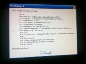

gheoss Posted November 2, 2012 Posted November 2, 2012 Hello im having a problem, maybe a kind soul can help me Ive installed and edited everything as i should i think... But im having this error I havent installed Daemon tools, should i??
