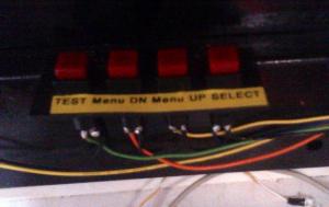

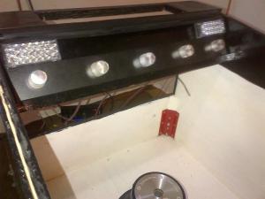

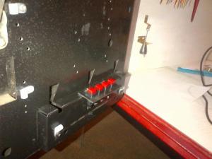

Luckydogg420 Posted January 14, 2014 Author Posted January 14, 2014 Just a few odds and ends here. I mounted the plunger module upside down under the apron. I also mounted the strobe panels and flasher bar (from Zebulon) on the back panel behind the playfield screen and I mounted the resistor board (from zeb) inside the cabinet, then soldered up the light bar connections I also made a bracket with 4 buttons for the service buttons

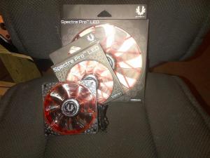

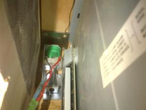

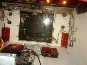

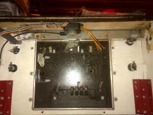

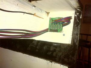

Luckydogg420 Posted January 30, 2014 Author Posted January 30, 2014 It's been very cold here in southern Ontario this month so not a lot has been done. I bought a couple fans, hopefully this will keep the machine cool I installed the replay knocker inside the backbox, it just fits behind the 32" tv. The back of the tv is on the right side of this pic and the inside on the back board is on the left. There's about an 1/8" clearance on each side. I've started placing components inside the bottom cabinet. And then I spent some time soldering up the connections to the plunger kit and finished the service buttons.

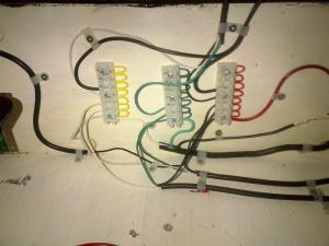

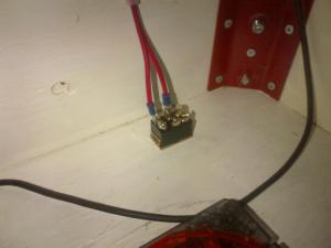

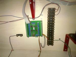

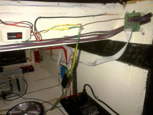

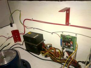

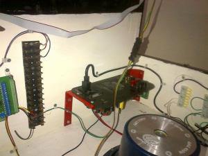

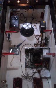

Luckydogg420 Posted February 4, 2014 Author Posted February 4, 2014 I spent some time wiring up the cabinet. I finished soldering wires together for the strobes and flashers. For the wires that cross the playfield tv I installed a quick connect. This is just a plug for a car trailer hitch lights. It was cheap from a local surplus store. On the inside left side, I placed the ledwiz with fuse holders. Although I don't have contactors yet for force feedback this will be perfect to add them later. Behind that I placed the audio amp. Along the back wall I placed the power mains. The plug wire comes in here, then runs to the front power switch and back again. There's enough room on the terminal blocks to add extra stuff in the future. The back right corner has the 2nd pc power supply and zeb's power board And here's the power switch in the normal location. Front right bottom

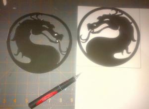

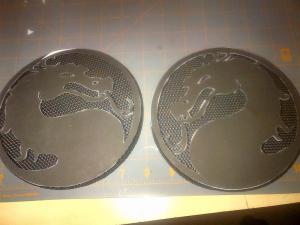

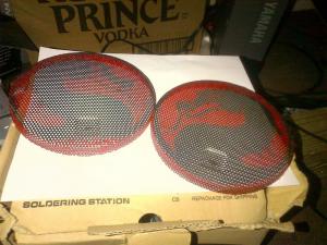

Luckydogg420 Posted February 4, 2014 Author Posted February 4, 2014 I also worked on the speaker grills. I found a picture online, resized it to proper size, made a mirror copy and printed them on sticker paper Next, I cut them out with an exacto knife and stuck them on the grills. Then I grabbed the rattle can and painted them red, to match the rest of the cab They look better in real life then they do in the pictures, but I'm not 100% satisfied with them. I'll probably touch them up with black paint. Their was some paint bleed under the sticker.

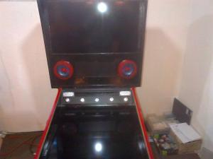

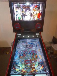

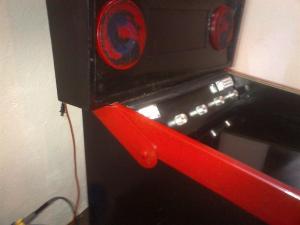

Luckydogg420 Posted February 12, 2014 Author Posted February 12, 2014 Well the easy part done. The cabinet is built. Time to let my problems shine through. Personally I think the cabinet build is the easy part. My issues begin with software. Everything had been dry fitted together earlier so I won't spend a lot of time going through it now. I just reinstalled the screens and turned it on. ....time to play some pinball. ....I mean test for problems.
RenegadeFred Posted February 13, 2014 Posted February 13, 2014 The cab looks good! How's that GT 610 card working out? Are you using it to run all three monitors?
Luckydogg420 Posted February 13, 2014 Author Posted February 13, 2014 The gt 610 can only run 2 monitors at once. I had it running the playfield by its self for a while and it sucks. This pc was bought used for a good price, so I plan to add a second graphics card. This pc can't run the on board graphics while there's a card plugged in, so I can't even test all three screens untill I get the 2nd card. With the gt610 running just the playfield, their were times that the ball would jump a cross the playfield if it was moving really fast. I only have 2 tables running in VP so far. Ghostbusters and wrath of Olympus. WOOLY playes relativity well. But GB was pretty frustrating.

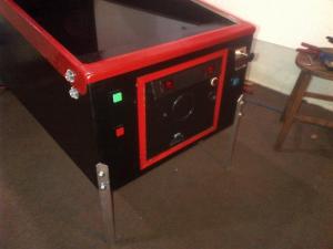

showstopper Posted February 13, 2014 Posted February 13, 2014 Very nice. Not sure if the legs should also be red? How to update HyperLaunch
Luckydogg420 Posted February 13, 2014 Author Posted February 13, 2014 Hahaha. Ya. The legs will be red. These are just temp legs until I get a set of real ones. This is just some angle aluminum that I had laying around. Their only like 16" tall. It's a little hard on the back playing hunched over
RenegadeFred Posted February 13, 2014 Posted February 13, 2014 Well.. that really sucks to hear. I actually picked up that same card last month - slowly trying to piece together a pc for a build. Are you using UVP or B2S? I'd recommend B2S as I seen a performance boost over UVP. Currently doing all testing on a dual core 1.8ghz and an ArcadeVGA 3000 card that runs VP well for the most part. Power supply isn't big enough to handle the 610. Don't loose hope yet, as there is a DirectX9 port of VP in the works. The dev seems to be pumping out fast. From what I've read there's been a nice little performance boost for a lot of people and it reduces or generally gets rid of the micro stuttering that you may be experiencing.
Luckydogg420 Posted February 14, 2014 Author Posted February 14, 2014 Don't be discouraged. The card works well enough. Last night I installed attack from mars and had a pretty wild multiball session and it seemed ok. It preformed better then the one ball on ghostbusters table. I also don't have the graphics turned all the way up yet. I'm still planning to use it for the backglass and (DMD) LCD screen. I hope to use something better for the playfield so that I can crank up the graphics performance as high as possible.
