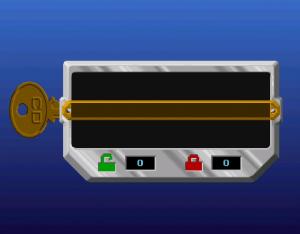

styphelus Bro,
I have downloaded your full folder and replaced mine. But in yours have many host files , which one I need to load?
I tried 2 of them but it goes to dark screen, nothing happen next if l run the game outside HQ.
I tried to run inside HQ below screen came up with game name this time on key, how to start the game?
[ATTACH=CONFIG]52208[/ATTACH]
