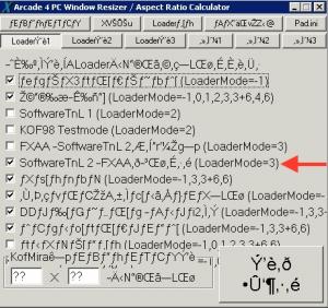

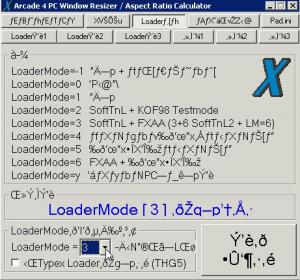

gigapig Posted October 25, 2015 Author Posted October 25, 2015 Guys is anyone aware of a fix for raiden 3? Seems to be a glitch with the ships graphics where half of the fighter jet is missing. Cant seem to find any fixes online. If you want it fixed you'll need to use Game Loader All RH and set up the TTX.ini so the loader is using something like mode 3. That mode uses Transform and Lighting which seems to fix it. If someone has their TTX.ini already set up for R3 please post it here. Thanks.

iNTiGOD Posted October 25, 2015 Posted October 25, 2015 If you want it fixed you'll need to use Game Loader All RH and set up the TTX.ini so the loader is using something like mode 3. That mode uses Transform and Lighting which seems to fix it. If someone has their TTX.ini already set up for R3 please post it here. Thanks. Thanks Mr Pig! To the rescue again!!! For those that would like to see the settings that got it working here they are for your visual pleasure. A copy of my ttx.ini file is below ;// -------------------------------------------------------------------------------------------- ;//DZÇÃçÄñ⁄ÇÕLoaderModeÇê›íËǵNjÇ∑ÅB ;//LoaderMode=-1 îƒóp + ÉtÉåÅ[ÉÄÉäÉ~ÉbÉ^Å[ ;//LoaderMode=0 íPã@î\ ;//LoaderMode=1 îƒóp ;//LoaderMode=2 SoftTnL + Kof98 TestMode ;//LoaderMode=3 SoftTnL + FXAA ;//LoaderMode=4 ÉfÉXÉNÉgÉbÉvâëúìxÇ≈ÉtÉãÉXÉNÉäÅ[Éì ;//LoaderMode=5 âëúìxïœçXëŒâûÉtÉãÉXÉNÉäÅ[ÉìÅiâÊñ âÒì]ã@î\Ç…ÇÕîÒëŒâûÅj ;//LoaderMode=6 FXAA + âëúìxïœçXëŒâû ;//LoaderMode=y í·ÉXÉyÉbÉNPCóÉê_êÍópê›íËÅiëºÇÃLoaderModeÇ≈óÉê_Ç™èdÇ¢èÍçáÇ…å¯â ǙdžÇÈǩLJímÇÍÇ‹ÇπÇÒÅj [Loader] LoaderMode=3 ;ãåTypex LoaderÇégópǵNjÇ∑Åií èÌÇÕ0ñ≥å¯Ç≈égópǵÅAÉzÉbÉgÉMÉ~ÉbÉN5ÉvÉåÉCéûÇÕ1óLå¯Ç…ǵǃâ∫Ç≥Ç¢Åj ;ÉzÉbÉgÉMÉ~ÉbÉN5à»äOÇÃÉQÅ[ÉÄÇ≈ÉLÅ[ê›íËÇÇ∑ÇÈèÍçáÇÕÅALoaderãNìÆå„Ç…ìfÇ´èoÇ≥ÇÍÇÈÅuTypex Config.exeÅvÇ≈ê›íËǵǃâ∫Ç≥Ç¢ÅB ;ÅñÉQÅ[É~ÉìÉOÉfÉoÉCÉXÇÃëŒâûèÛãµÇÕÅAãåTypex LoaderÇÃédólÇ…èÄÇ∂Ç‹Ç∑ÇÃÇ≈ ;ÅñTypeX Config.exeÇ≈ê›íËǵÇΩDžLJä÷ÇÌÇÁÇ∏ÅAÉQÅ[ÉÄíÜÇÕîΩâûǵǻǢìôÇÃïsãÔçáǙdžÇËÇ‹Ç∑ÅB ;ÅñǪÇÃèÍçáÇÕÉQÅ[ÉÄÉpÉbÉhÇïœçXÇ∑ÇÈÇ©ÅAǪÇÍÇ≈LJë ñ⁄Ç»ÇÁÇŒTypeX Config.exeÇ≈ÉLÅ[É{Å[ÉhÇÃê›íËÇäÑÇËìñǃÅAìYïtÇÃÅuÉIÉgÉÅÉfÉBÉEÉXDžLJëŒâûPad.iniÅvÇìKêÿÇ…ê›íËǵǃâ∫Ç≥Ç¢ÅB ;ÅñÉzÉbÉgÉMÉ~ÉbÉN5ÇÃÉLÅ[ê›íËÇÕÅALoaderë§Ç≈ÉäÉ}ÉbÉvçœÇ›Ç»ÇÃÇ≈ÅAê›íËïsóvÇ≈Ç∑ÅB [Loader Old] Enable=0 ;Type XånÇÃÉQÅ[ÉÄÇ≈ãNìÆéûÇÃâÊñ ÉÇÅ[ÉhÇêÿÇËë÷ǶNjÇ∑ÅB ;ëŒâûÉQÅ[ÉÄÇÕÅABattleFantasiaÅABlazBlueCSÅABlazBlueCTÅAKOFXIIÅAKOFXIIIÅASamurai Spirits SenÅASFIVÅASSFIVAEäeÉGÉfÉBÉVÉáÉìÇ≈Ç∑ÅB ;0í·âëúìxÉÇÅ[ÉhÅB1çÇâëúìxÉÇÅ[ÉhÅB [Type X] HighResolution=1 ;// -------------------------------------------------------------------------------------------- ;//DZÇÃçÄñ⁄ÇÕà»â∫ÇÃLoaderModeÇ…ëŒâûǵǃǢNjÇ∑ÅB ;//LoaderMode=-1 ;//LoaderMode=0 ;//LoaderMode=1 ;//LoaderMode=2 ;//LoaderMode=3 ;//LoaderMode=6 ;//LoaderMode=y ;ÉQÅ[ÉÄãNìÆå„ÇÃÉEÉBÉìÉhÉEÉTÉCÉYÇê›íËǵNjÇ∑ÅB ;CTRL+F11Ç©É}ÉEÉXêiÇfiÉ{É^Éìí∑âüǵÇ≈ÉEÉBÉìÉhÉEÉTÉCÉYïœçXÉcÅ[ÉãÇãNìÆèoóàÇ‹Ç∑ÅB ;Setting=1ÅiÉEÉBÉìÉhÉEê›íË1ÅjÅASetting=2ÅiÉEÉBÉìÉhÉEê›íË2Åj [Window Size] Setting=0 ;ÉEÉBÉìÉhÉEê›íË1 [Window Size 1] Width= Height= ;ÉEÉBÉìÉhÉEê›íË2 [Window Size 2] Width= Height= ;ÉEÉBÉìÉhÉEèàóùä‘äu ;LoaderãNìÆéûÇ‚CTRL+F11ÉcÅ[ÉãÇÃÉEÉBÉìÉhÉEÉTÉCÉYÉ^Éuè„Ç≈ÅAÉQÅ[ÉÄÉEÉBÉìÉhÉEÉTÉCÉYïœçXÇÃèàóùä‘äuÇê›íËǵNjÇ∑ÅiÉfÉtÉHê›íËÇÕ25msÅjÅB ;èàóùä‘äuÇ0ìôÇ…ê›íËÇ∑ÇÈéñÇ≈ÅAÉQÅ[ÉÄÉEÉBÉìÉhÉEÇÃèàóùéûä‘ÇíZèkÇ∑ÇÈéñÇ™èoóàÇ‹Ç∑ÅB ;ÉQÅ[ÉÄÉEÉBÉìÉhÉEÇÃèàóùÇ…é∏îsÇ∑ÇÈéûÇÕÅAê›íËêîílÇëùǂǵǃâ∫Ç≥Ç¢ÅB [Window Interval] Interval=25 ;// -------------------------------------------------------------------------------------------- ;//DZÇÃçÄñ⁄ÇÕà»â∫ÇÃLoaderModeÇ…ëŒâûǵǃǢNjÇ∑ÅB ;//LoaderMode=-1 ;//LoaderMode=0 ;//LoaderMode=1 ;//LoaderMode=2 ;//LoaderMode=5 ;//LoaderMode=6 ;LoaderãNìÆéûÇ…ÅAe-amuemuÇ∆iccaemuÇé©ìÆãNìÆÇµÇ‹Ç∑ÅB0ñ≥å¯ÅA1óLå¯ÅB [AutoRun] Enable=0 ;LoaderèIóπéûÇ…ÅAe-amuemuÇ∆iccaemuÇé©ìÆèIóπǵNjÇ∑ÅB0ñ≥å¯ÅA1óLå¯ÅB [AutoClose] Enable=0 ;// -------------------------------------------------------------------------------------------- ;//DZÇÃçÄñ⁄ÇÕëSǃÇÃLoaderModeÇ…ëŒâûǵǃǢNjÇ∑ÅB ;LoaderãNìÆéûÇÃÉzÉbÉgÉLÅ[èÛë‘ÇïœçXèoóàÇ‹Ç∑ÅB0ñ≥å¯ÅA1óLå¯ÅB ;ñ≥å¯èÛë‘Ç≈ãNìÆÇµÇƒÇ‡ÅAPauseÉLÅ[ÇâüÇπÇŒóLå¯Ç…Ç»ÇËÇ‹Ç∑ÅB [Hotkey] Enable=1 ;AeroÇñ≥å¯Ç…ǵǃLoaderÇãNìÆÇµÇ‹Ç∑ÅB [Aero] Enable=1 ;// -------------------------------------------------------------------------------------------- ;//DZÇÃçÄñ⁄ÇÕà»â∫ÇÃLoaderModeÇ…ëŒâûǵǃǢNjÇ∑ÅB ;//LoaderMode=-1 ;//LoaderMode=0 ;//LoaderMode=1 ;//LoaderMode=2 ;//LoaderMode=3 ;//LoaderMode=6 ;//LoaderMode=y ;òAë±ëSâÊñ ÉLÉÉÉvÉ`ÉÉéûÇÃä‘äuÇÅimsÅjÇ≈ãLèqǵNjÇ∑Åiî≠ìÆÉLÅ[ÇÕCTRL+ïœä∑ÉLÅ[Åj ;Åñó· 0.1ïbÇÕ100msÅA1ïbÇÕ1000msÅA10ïbÇÕ10000msÅjÅñmsïsóvÅAêîílÇÃÇ›ãLì¸ [FullScreen Capture] Interval=1000 ;òAë±ÉQÅ[ÉÄâÊñ ÉLÉÉÉvÉ`ÉÉéûÇÃä‘äuÇÅimsÅjÇ≈ãLèqǵNjÇ∑Åiî≠ìÆÉLÅ[ÇÕCTRL+ñ≥ïœä∑ÉLÅ[Åj ;Åñó· 0.1ïbÇÕ100msÅA1ïbÇÕ1000msÅA10ïbÇÕ10000msÅjÅñmsïsóvÅAêîílÇÃÇ›ãLì¸ [GameScreen Capture] Interval=1000 ;BGâÊëúÇÃÉXÉâÉCÉhÉVÉáÅ[ä‘äuÇÅimsÅjÇ≈ãLèqǵNjÇ∑Åiî≠ìÆÉLÅ[ÇÕCTRL+SÅj ;Åñó· 0.1ïbÇÕ100msÅA1ïbÇÕ1000msÅA10ïbÇÕ10000msÅjÅñmsïsóvÅAêîílÇÃÇ›ãLì¸ [Slideshow] Interval=5000 ;É}ÉEÉXâEÉNÉäÉbÉNòAë≈ÉRÉ}ëóÇËã@î\ÇÃçXêVä‘äuÇÅimsÅjÇ≈ãLèqǵNjÇ∑ÅiǩǻÇËûBñÜÇ»ã@î\Ç≈Ç∑Åj [Frame Advance] Interval=0 ;SilentHill: The ArcadeÉvÉåÉCéûÇÃÅAÉ}ÉEÉXç∂É{É^ÉìòAéÀã@î\ÇÃçXêVä‘äuÇÅimsÅjÇ≈ãLèqǵNjÇ∑ÅB [Rapid Fire Mouse] Delay=200 Interval=50 ;ägëÂëãÇÃÉEÉBÉìÉhÉEÉTÉCÉYÇê›íËǵNjÇ∑ÅiHomeÉLÅ[Åj [Magnifier1] Width=640 Height=480 Interval=16 ;É}ÉEÉXÉJÅ[É\Éãí«îˆägëÂëãÇÃÉEÉBÉìÉhÉEÉTÉCÉYÇê›íËǵNjÇ∑ÅiCTRL+HomeÉLÅ[Åj [Magnifier2] Width=640 Height=480 Interval=16 ;LoaderãNìÆéûÇÃBGâÊëú/ìÆâÊï\é¶ÇÃê›íËÇǵNjÇ∑ÅB0ñ≥å¯ÅA1óLå¯ÅB [BGImage] Enable=0 FileNameImage=images\bg.jpg FileNamePng=images\bg.png FileNameMovie=images\bgmovie.mp4 ;BGâÊëúï\é¶Ç»ÇÁÇŒÅu0ÅvÅABGìÆâÊï\é¶Ç»ÇÁÇŒÅu1ÅvÅAìßñæPNGâÊëúï\é¶Ç»ÇÁÇŒÅu2ÅvÇ…ê›íËǵǃâ∫Ç≥Ç¢ÅB BGMovie=0 PngPosX=0 PngPosY=0 PngSizeW=0 PngSizeH=0 ;ÉQÅ[ÉÄâÊñ äOÇÃó]îíÇ…éwíËêFÇë}ì¸ÅuInsertÉLÅ[ÅvÇÃï\é¶êFÇê›íËǵNjÇ∑ÅB [BGColor] Color=000000 ;àÍïîÇÃÉRÉiÉ~âπäyånÉQÅ[ÉÄópÇ…ÅAé¿çsÉtÉ@ÉCÉãñºÇ‚à¯êîÇíºê⁄éwíËǵǃãNìÆÇ∑ÇÈê›íËÇǵNjÇ∑ÅB0ñ≥å¯ÅA1óLå¯ÅB [Commandline] Enable=0 Run= ;âEÉNÉäÉbÉNàÍéûí‚é~ã@î\ÇÃÉÇÅ[ÉhêÿÇËë÷ǶÅB0ñ≥å¯ÅA1óLå¯ÅB [PauseMode2] Enable=0 ;LoaderãNìÆéûÇ…ç≈è¨âªÇµÇΩÉEÉBÉìÉhÉEÇÅALoaderèIóπéûÇ…ïúå≥ǵNjÇ∑ÅB0ñ≥å¯ÅA1óLå¯ÅB [Restore Window] Enable=1 ;ÉEÉBÉìÉhÉEÉÇÅ[ÉhãNìÆéûÇ…ÅAÉEÉBÉìÉhÉEògÇï\é¶ÇµÇ‹Ç∑ÅB0ñ≥å¯ÅA1óLå¯ÅB(BGìÆâÊçƒê∂éûÇ…ÉQÅ[ÉÄÇÃÉtÉåÅ[ÉÄÉåÅ[ÉgÇ™à¿íËǵǻǢèÍçáÇ…óLå¯Ç≈Ç∑)ÅB [Window Border] Enable=0 ;LoaderãNìÆèàóùå„ÅAÉQÅ[ÉÄÉEÉBÉìÉhÉEÇ∆BGâÊëúÉcÅ[ÉãÇÉZÉJÉìÉ_ÉäÉÇÉjÉ^Ç…à⁄ìÆÇµÇ‹Ç∑ÅB0ñ≥å¯ÅA1óLå¯ÅB [Move Window] Enable=0 ;É}ÉEÉXÉJÅ[É\ÉãÇ™3ïbä‘ÉAÉCÉhÉãèÛë‘Ç…Ç»ÇÈÇ∆ÅAé©ìÆÇ≈îÒï\é¶âªÇµÇ‹Ç∑ÅB0ñ≥å¯ÅA1óLå¯ÅB [Hide Mouse Cursor] Enable=1 ;òAë±ÉLÉÉÉvÉ`ÉÉÉÇÅ[Éhî≠ìÆéûÇ…ÅAÉVÉÉÉbÉ^Å[âπÇñ¬ÇÁǵNjÇ∑ÅB0ñ≥å¯ÅA1óLå¯ÅB [Shutter Sound] Enable=1 ;LoaderãNìÆéûÇ…Pad.iniÇì«Ç›çûǛNjÇ∑ÅB0ñ≥å¯ÅA1óLå¯ÅB [Padini] Enable=0 ;ÉEÉBÉìÉhÉEÉÇÅ[ÉhãNìÆéûÇÃÇ›ÅAÉJÉEÉìÉgÉAÉbÉvÉ^ÉCÉ}Å[Çï\é¶ÇµÇ‹Ç∑ÅB0ñ≥å¯ÅA1óLå¯ÅB [Timer] Enable=0 ;LoaderãNìÆéûÇ…ÅAï€ë∂ǵÇΩâπó ê›íËDžǵNjÇ∑ÅBLoaderèIóπéûÇ…ÇÕå≥ÇÃâπó Ç…ñflǵNjÇ∑ÅB ;âπó ê›íËÇÃï€ë∂ÇÕÅAÉ}ÉEÉXç∂É{É^ÉìâüǵǻǙÇÁÉzÉCÅ[ÉãÉ{É^Éìí∑âüǵÇ≈Ç∑ÅB [Volume] Enable=1 Setting=100 ;ÉAÉXî‰åvéZã@ÅAàÍî‘âEë§ÇÃÉAÉXî‰ÇîCà”ÇÃêîílÇ…ê›íËèoóàÇ‹Ç∑ÅB [Calculator] CalcWidth=16 CalcHeight=10 ;// -----------------------------ëŒêÌÉzÉbÉgÉMÉ~ÉbÉN5ä÷åWÇÃê›íË----------------------------------- ;ÉfÉtÉHÉãÉgÇ≈ï\é¶Ç≥ÇÍÇÈñÉêùÉ{Å[ÉhÇÃÉTÉCÉYÇê›íËǵNjÇ∑ÅB0è¨ÅA1íÜÅA2ëÂÅB [Mahjong Board] Size=1 ;ÉfÉtÉHÉãÉgÇ≈ï\é¶Ç≥ÇÍÇÈñÉêùÉ{Å[ÉhÇÃBGÉJÉâÅ[Çê›íËǵNjÇ∑ÅBãÛóìÇ≈ÉfÉtÉHÉãÉgÅB ;6åÖÇÃÉJÉâÅ[ÉRÅ[ÉhÇì¸óÕǵǃâ∫Ç≥Ç¢ÅB000001Ç≈ìßñæÅA000000Ç≈çïÅAFFFFFFÇ≈îíÅBÅñredÅAgreenÅAblueÅAyellowìôÅAêFÇíºê⁄éwíËÇ≈LJç\ǢNjÇπÇÒÅB Color=000001 ;é©ìÆÇ≈ñÉêùÉ{Å[ÉhÇãNìÆÇµÇ‹Ç∑ÅB0ñ≥å¯ÅA1óLå¯ÅB Autorun=1 ;é©ìÆãNìÆÇ∑ÇÈç€ÇÃñÉêùÉ{Å[ÉhëIëÅB0ñÉêùÉ{Å[ÉhÇÃÇ›ÅA1ñÉêùÉ{Å[ÉhÅ{É^ÉbÉ`ÉpÉlÉãÅB MahjongBoard=1 ;// ------------------------------- ;Ç»ÇÒÇøÇ·Ç¡ÇƒÉ^ÉbÉ`ÉpÉlÉãçÏê¨ ;ÉfÉtÉHê›íËÇÕÉtÉãHDÉÇÉjÉ^ópÅiÉQÅ[ÉÄÇÃÉEÉBÉìÉhÉEÉTÉCÉYÇÕ1440x1080ÅjÅB ;îv1ǬÇÃïùÅB PaiWidth=95 ;îv1ǬÇÃçÇÇ≥ÅAëSëÃÇÃçÇÇ≥ÅB PaiHeight=120 ;AÅ`MîvëSëÃÇÃïùÅB PaiAllWidth=1235 ;AÅ`MîvëSëÃÅAç∂Ç©ÇÁÇÃâ°à íuÅB PaiAllX=278 ;AÅ`NîvëSëÃÅAè„Ç©ÇÁÇÃècà íuÅB PaiAllY=900 ;NîvÅAç∂Ç©ÇÁÇÃâ°à íuÅB PaiNX=1547 ;É^ÉbÉ`ÉpÉlÉãÇÃìßñæìxÅBí èÌÇÕ1Åiê›íËîÕàÕ1Å`255ÅjÅñÉ^ÉbÉ`ÉpÉlÉãçÏê¨éûÇÕ150ìôÅAîºìßñæèÛë‘Džǵǃâ∫Ç≥Ç¢ÅB Transparent=50 ;// -------------------------------------------------------------------------------------------- ;Half Life 2 SurvivorêÍópê›íË ;// -------------------------------------------------------------------------------------------- ;ÉQÅ[ÉÄÉvÉåÉCíÜÇ…ÅuHomeÅvÉLÅ[Ç≈ÉtÉåÅ[ÉÄÉJÉEÉìÉ^Å[ÇÃï\é¶/îÒï\é¶ÇÃêÿÇËë÷ǶÅB ;GraphicLevel= ;0 Normal ÅñÉfÉtÉHÉãÉg ;1 High ÅñêFÅXÇ∆ÉOÉâÉtÉBÉbÉNÇ™ã≠âªÇ≥ÇÍÇ‹Ç∑ÅiêÖÇÃï\åªÇ‚îΩéÀÅAÉIÉuÉWÉFÉNÉgÇÃóéÇ∑âeÇ‚ÉfÉBÉeÅ[ÉãÅAÉAÉjÉ\ÉgÉçÉsÉbÉNÉtÉBÉãÉ^ÉäÉìÉOx16ìôÅXÅj ;2 Very High Åñ1Ç…â¡Ç¶ÇƒÅA4XAA [HL2] GraphicLevel=0 ;FullScreenMode= ;0 ÅñÉEÉCÉìÉhÉEÉÇÅ[ÉhÅiGraphicLevelñ‚ÇÌÇ∏ÅAÉ`ÉÖÅ[ÉgÉäÉAÉãÉÄÅ[ÉrÅ[ÇÃçƒê∂Ç™èoóàÇ‹Ç∑Åj ;1 ÅñÉtÉãÉXÉNÉäÅ[ÉìÉÇÅ[ÉhÅiGraphicLevel=1à»è„ÇæÇ∆É`ÉÖÅ[ÉgÉäÉAÉãÉÄÅ[ÉrÅ[Ç™çƒê∂Ç≥ÇÍÇ‹ÇπÇÒÅj FullScreenMode=0 ;StartupMode= ;0 ÅñÉfÉtÉHÉãÉg ;1 ÅñÇ»ÇÒÇøÇ·Ç¡ÇƒÉlÉVÉJÉÇÅ[ÉhÅiï\å¸Ç´ÉlÉVÉJÇóLå¯Ç…ǵNjÇ∑ÅBhl2.exeÇÃê⁄ë±Çãñâ¬ÇµÇ»Ç¢Ç∆ïsãÔçáóLÇËÇ‹Ç∑Åj StartupMode=0 ;// -------------------------------------------------------------------------------------------- ;Half Life 2 SurvivorêÍópê›íËDZDZNjÇ≈ ;// -------------------------------------------------------------------------------------------- ;// -------------------------------------------------------------------------------------------- ;//DZÇÃçÄñ⁄ÇÕà»â∫ÇÃLoaderModeÇ…ëŒâûǵǃǢNjÇ∑ÅB ;//LoaderMode=-1 ;//LoaderMode=5 ;ÅñLoaderMode=-1ê›íËéûÇ≈ÇÕÅAUseSpeedHack=1Ç∆ïπópÇ∑ÇÈéñÇ≈ÅAÉQÅ[ÉÄíÜÇÃÉtÉåÅ[ÉÄÉåÅ[ÉgÇ™ÇÊÇËà¿íËÇ∑ÇÈâ¬î\ê´Ç™Ç†ÇËÇ‹Ç∑ÅB ;ÅñâπäyånÉQÅ[ÉÄÇ≈âπÉYÉåÇ∑ÇÈèÍçáÇÕÅuLimit=59.654ÅvÇÃêîílÇí≤êÆÇµÇƒâ∫Ç≥Ç¢ÅB [FPS] Enable=1 Limit=59.654 Show=1 Interval=75 PosX=10 PosY=10 ;Tetris The Grand Master 3êÍópê›íË ÅñÉQÅ[ÉÄÉXÉsÅ[ÉhÇ™ë¨Ç¢èÍçáÅu1ÅvÇ…ê›íËÇ∑ÇÈéñÇ≈60fpsDžǵNjÇ∑ÅB FrameLimitter=1 ;// -------------------------------------------------------------------------------------------- ;//DZÇÃçÄñ⁄ÇÕà»â∫ÇÃLoaderModeÇ…ëŒâûǵǃǢNjÇ∑ÅB ;//LoaderMode=-1ÅióLå¯Ç…ǵǻǢéñÅj ;//LoaderMode=1 ;//LoaderMode=2 ;//LoaderMode=3 ;//LoaderMode=4 ;//LoaderMode=5ÅióLå¯Ç…ǵǻǢéñÅj ;ÅñÅñÅñÅñÅñDZÇÃê›íËÇÕàŸï˚ê´ÉtÉBÉãÉ^ÉäÉìÉONewÅiAnisoVersion=1ÅjëIëéûÇÃÇ›óLå¯Ç≈Ç∑ÅñÅñÅñÅñÅñ ;DZÇÃê›íËÇÕÅAíÜâÿContraÅAHalf Life2ÅAKOF MIRAÅAYokushinÅAex-boardånÇ≈ÇÕñ≥å¯ÅB ;Åñí èÌÇÕñ≥å¯èÛë‘Ç≈égópǵÅALoaderMode=-1Ç∆5à»äOÇÃLoaderModeê›íËéûÇ…ÅAÉQÅ[ÉÄÉXÉsÅ[ÉhÇ™ë¨Ç¢èÍçáÇÃÇ›óLå¯Ç…ǵǃâ∫Ç≥Ç¢ÅB ;ÅñǩǻÇËÇÃûBñÜã@î\Ç≈ÅAFPSlimit=60Ç…ê›íËǵǃLJ60ÉtÉåÅ[ÉÄÇ…Ç»ÇÁǻǢâ¬î\ê´Ç™Ç†ÇËÇ‹Ç∑ÅB ;êîílÇÃïœçXÇÕÅAä¬ã´Ç…çáÇÌÇπǃìKãXïœçXǵǃâ∫Ç≥Ç¢ÅB [TTX] EnableFPSLimit=1 FPSlimit=60.00 ;// -------------------------------------------------------------------------------------------- ;//DZÇÃçÄñ⁄ÇÕà»â∫ÇÃLoaderModeÇ…ëŒâûǵǃǢNjÇ∑ÅB ;//LoaderMode=-1 ;//LoaderMode=3 ;//LoaderMode=6 ;á@ ÉAÉãÉJÉiÉnÅ[Ég2êÍópê›íËÅB UseDDrawColorEmulate=1 UseDDrawAutoBlt=0 ;áA äeÉQÅ[ÉÄã§í ê›íËÅB UseSpeedHack=1 SpeedHackMultiple=10 WindowMode=1 Border=1 ;áB âΩåÃÇ©Kof98Ç≈ÇÕÅu1ÅvDžǵǻǢÇ∆ãNìÆèoóàÇ‹ÇπÇÒÅiEx-BoardånÇ≈ÇÕÅu1ÅvÇ…Ç∑ÇÈÇ∆ãNìÆèoóàǻǢÉQÅ[ÉÄǙdžÇËÇ‹Ç∑Åj ShowFps=1 ;áC ÇŸÇfiÇÁÉvÉåÉCéûÇ…ÅuCTRL+F11ÅvÉEÉCÉìÉhÉEÉTÉCÉYïœçXÉcÅ[Éãè„Ç≈É}ÉEÉXÉJÅ[É\ÉãÇëÄçÏâ¬î\DžǵNjÇ∑ÅB UseCursorSet=1 ;// -------------------------------------------------------------------------------------------- ;//DZÇÃçÄñ⁄ÇÕà»â∫ÇÃLoaderModeÇ…ëŒâûǵǃǢNjÇ∑ÅB ;//LoaderMode=3 ;á@ Fxaaã@î\ÇÕáAÇ∆îrëºégópÇ≈Ç∑ÅBáAÇégópÇ∑ÇÈèÍçáÇÕÅu0ÅvDžǵǃâ∫Ç≥Ç¢ÅB0ñ≥å¯ÅA1óLå¯ÅB UseFxaa=0 ;FxaaóLå¯éûÇÃÉVÉÉÅ[ÉvÉlÉXÇã≠í≤ǵNjÇ∑ÅB0ñ≥å¯ÅA1ÉÇÅ[Éhá@ÅA2ÉÇÅ[ÉháA Sharpen=0 ;áA óLå¯Ç…Ç∑ÇÈÇ∆ÅAAMDä¬ã´Ç≈ÉTÉÄëMÇÃïsãÔçáÇèCê≥ǵNjÇ∑ÅBWin7 x64ä¬ã´Ç≈RaidenIIIÇÃïsãÔçáLJèCê≥ǵNjÇ∑ÅB ;ÉtÉåÅ[ÉÄÉåÅ[ÉgÇ™à¿íËǵǻǢèÍçáÇÕÅuUseSpeedHack=1ÅvÇ…Ç∑ÇÈéñÇÇ®ä©ÇflǵNjÇ∑ÅB ForceSoftwareTransform=1 ;// -------------------------------------------------------------------------------------------- ;//DZÇÃçÄñ⁄ÇÕà»â∫ÇÃLoaderModeÇ…ëŒâûǵǃǢNjÇ∑ÅB ;//LoaderMode=-1ÅiÉRÉiÉ~âπäyånÉQÅ[ÉÄÇÃÇ›Åj ;//LoaderMode=5 ;DZÇÃê›íËÇÕÅAíÜâÿContraÅAHalf Life2ÅAKOF MIRAÅAYokushinÅAex-boardånÇ≈ÇÕñ≥å¯ÅB ;DZÇÃÉIÉvÉVÉáÉìÇÕäÓñ{ìIÇ…ÉRÉiÉ~âπäyånÉQÅ[ÉÄêÍópÇ≈Ç∑ÅBÅñType XÇ≈ÇÕàÍïîÇÃÉQÅ[ÉÄÇ≈ÇÃÇ›ê≥èÌÇ…ã@î\ǵNjÇ∑ÅB ForceDisplayRefreshRate=0 DisplayRefreshRateHz=60 ForceDisplaySize=0 DisplayMode=1 DisplayWidth=1920 DisplayHeight=1080 ;// -------------------------------------------------------------------------------------------- ;//DZÇÃçÄñ⁄ÇÕà»â∫ÇÃLoaderModeÇ…ëŒâûǵǃǢNjÇ∑ÅB ;//LoaderMode=-1 ;//LoaderMode=1 ;//LoaderMode=2 ;//LoaderMode=3 ;//LoaderMode=4 ;//LoaderMode=5 ;//LoaderMode=6 (OldÇÃÇ›) ;DZÇÃê›íËÇÕÅAíÜâÿContraÅAHalf Life2ÅAKOF MIRAÅAYokushinÅAex-boardånÇ≈ÇÕñ≥å¯ÅB AnisoVersion=0 ForceAnisotropicFiltering=0 MaxAnisotropy=16 SlowMode=0 BugFixMode=1 PixelShaderLimit=4096 ;Åñbeatmania IIDX 18ÅA19ÅAÉ|ÉbÉvÉì19Ç…ì‰ÇÃê¸ÅHǙdžÇÈèÍçáÅuAnisoVersion=0ÅvÅuForceAnisotropicFiltering=1ÅvÇ…ê›íËÇ∑ÇÈéñÇ≈ì‰ÇÃê¸ÇÕè¡Ç¶Ç‹Ç∑ÅB ;// -------------------------------------------------------------------------------------------- ;//DZÇÃçÄñ⁄ÇÕà»â∫ÇÃLoaderModeÇ…ëŒâûǵǃǢNjÇ∑ÅB ;//LoaderMode=-1 ;//LoaderMode=0 ;//LoaderMode=1 ;//LoaderMode=2 ;//LoaderMode=3 ;//LoaderMode=6 ;ècånÉVÉÖÅ[ÉeÉBÉìÉOÉQÅ[ÉÄÇ∆Sound VoltexÇÃÇ›Åu0ÅvÇ…ê›íËÇ∑ÇÈéñÇ≈ÅAé©ìÆâÊñ âÒì]ã@î\Çñ≥å¯âªèoóàÇ‹Ç∑ÅB-1é©ìÆÅA0ñ≥å¯Åi1óLå¯Çí«â¡ó\íËÅj Rotate=-1 ;// -------------------------------------------------------------------------------------------- ;//DZÇÃçÄñ⁄ÇÕà»â∫ÇÃLoaderModeÇ…ëŒâûǵǃǢNjÇ∑ÅB ;//LoaderMode=2ÅB0ñ≥å¯ÅA1óLå¯ÅB ForceWindowed=1 ForceSoftwareTnL=0 KofTestmode=0 ForceAniso=0 ;// -------------------------------------------------------------------------------------------- ;//DZÇÃçÄñ⁄ÇÕà»â∫ÇÃLoaderModeÇ…ëŒâûǵǃǢNjÇ∑ÅB ;//LoaderMode=6ÅB ;DZÇÃê›íËÇÕÅAKOF MIRAÅAYokushinÅAex-boardÅiAH2ÅjÇ…ÇÕñ¢ëŒâûÅB ;ÅñWindowSizeÇÃèäÇ…çÇÇ¢êîílÇì¸óÕÇ∑ÇÈéñÇ≈ÅAÉQÅ[ÉÄãNìÆéûÇÃâëúìxÇëÂïùÇ…è„Ç∞ÇÈéñÇ™èoóàÇ‹Ç∑ÅB ;ÅñScreenSizeÇÃèäÇ…çÇÇ¢êîílÇì¸óÕÇ∑ÇÈéñÇ≈ÅAÉQÅ[ÉÄãNìÆéûÇÃâëúìxÇëÂïùÇ…è„Ç∞ÇÈéñÇ™èoóàÇ‹Ç∑ÅB ;ÅñFixAspectRatioÇ™1ÇæÇ∆ÅAÉtÉãÉXÉNÉäÅ[ÉìãNìÆéûÇ…ÉAÉXÉyÉNÉgî‰Çà€éùǵNjÇ∑ÅB0ñ≥å¯ÅA1óLå¯ÅB ;ÅñAntiAliasMode=0Ç™ÉIÉtÅAAntiAliasMode=1Ç™FXAAÅAAntiAliasMode=2Ç™SMAAÅB ;ÅñForceFPS=60ÅBå©ÇƒÇÃí ÇËÅAÉtÉåÅ[ÉÄÉåÅ[ÉgÇÃè„å¿Ç≈Ç∑ÅB ;ÅñStretchModeÇÕägëÂéûÇÃÉtÉBÉãÉ^Å[Çê›íËèoóàÇ‹Ç∑ÅB ;Åñ2 BilinearÅA3 Bicubic (PS2.0)ÅA4 Lanczos (PS3.0)ÅA5 FXAA+BilinearÅiÉfÉtÉHÉãÉgÇÕBilinearÅjÅB WindowSize=1024x768 ScreenSize=1920x1080 FixAspectRatio=0 AntiAliasMode=0 ForceFPS=60 StretchMode=3 DDraw2D3D=1 DrawFPSText=0 FPSTextSize=32 EnableExternalDll=0 DisableFullScreen=1 ;// -------------------------------------------------------------------------------------------- ;//DZDZǩÇÁâ∫ÇÕê›íËïsóvÇ≈Ç∑ ;// -------------------------------------------------------------------------------------------- UseEffect=1 ProxyLibrary=d3d9b.dll DX9Converter=d3d9.dll Others=0 MAME High Score Tutorial For HyperSpin

gigapig Posted October 26, 2015 Author Posted October 26, 2015 iNTiGOD, looks like you need the English version of that config tool Anpanman, tells us you're troubles.
iNTiGOD Posted October 26, 2015 Posted October 26, 2015 iNTiGOD, looks like you need the English version of that config tool Anpanman, tells us you're troubles. So i've been doing it the hard way the entire time? F me MAME High Score Tutorial For HyperSpin

gigapig Posted November 15, 2015 Author Posted November 15, 2015 Mr Pig any chance linking the English version of Game Loader All RH? Thanks in advance I don't think there is such a thing although there is a file you can change to help you use the config tool. Place this Language.ini file in C:\Users\iNTiGOD Rulez\AppData\Roaming\Game Loader All RH. You can then run the Game Loader Config.exe from within the game folder and it should be in English. You can also press Ctrl-F11 to use it in game to make adjustments. Language.zip If you want to try to understand the TTX.ini a little more here are the read me's that I translated a few years ago. If you need more let me know. Game Loader Readme.zip
iNTiGOD Posted November 16, 2015 Posted November 16, 2015 I don't think there is such a thing although there is a file you can change to help you use the config tool. Place this Language.ini file in C:\Users\iNTiGOD Rulez\AppData\Roaming\Game Loader All RH. You can then run the Game Loader Config.exe from within the game folder and it should be in English. You can also press Ctrl-F11 to use it in game to make adjustments. Language.zip If you want to try to understand the TTX.ini a little more here are the read me's that I translated a few years ago. If you need more let me know. Game Loader Readme.zip Thanks buddy!! Nice detailed response for me. I was trying to set this up without this and it was close to impossible. Queue the Benny Hill Theme music MAME High Score Tutorial For HyperSpin
