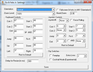

gigapig Posted January 14, 2014 Posted January 14, 2014 You may have seen this already, but using this wrapper does not require the use the Fix it Felix Jr script MacklinB kindly mentioned. Just point to the FIFJ.exe www.hyperspin-fe.com/forum/showthread.php?30313-Fix-it-Felix-Junior-has-been-uh-FIXEDG
twistedsymphony Posted January 14, 2014 Author Posted January 14, 2014 I have tried using that wrapper already. it's one of the two wrappers that I mentioned trying in my first post. it's fantastic in terms of modifying the game for things like freeplay and control mapping, but it doesn't help my focus problem :-/

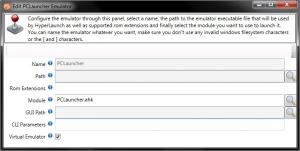

twistedsymphony Posted January 15, 2014 Author Posted January 15, 2014 Getting Fix-It Felix to appear in your MAME wheel as simple as adding an Alternate Emulator entry to the Games section of MAME in HyperLaunch HQ. When you add an entry, make sure Game=fixitfelixjr (or whatever you called your game name) System=PC Games and Emulator=PCLauncher. I was able to follow your guide until this step right here... Under "System" the only option it lets me select is "MAME"... similarly "MAME" and "Global" are the only two systems listed on the left hand column... I decided to check out ghutch92's guide on setting up the "PCLauncher" system Did you try updating mame to a version newer than 0.146? Also check out my signature for a guide. I went to your guide here: http://www.hyperspin-fe.com/forum/showthread.php?29481-How-to-install-HyperSpin&p=294281&viewfull=1#post294281 I completed step one but step 2 didn't work: 2.) Now set PCLauncher as your default emulator by clicking on the magnifying glass to the right of the default emulator field and selecting PCLauncher [Global] in the popup window. the Magnifying glass is grayed out and will not let me select it.

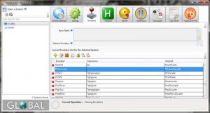

ghutch92 Posted January 15, 2014 Posted January 15, 2014 I was able to follow your guide until this step right here... Under "System" the only option it lets me select is "MAME"... similarly "MAME" and "Global" are the only two systems listed on the left hand column...I decided to check out ghutch92's guide on setting up the "PCLauncher" system I went to your guide here: http://www.hyperspin-fe.com/forum/showthread.php?29481-How-to-install-HyperSpin&p=294281&viewfull=1#post294281 I completed step one but step 2 didn't work: the Magnifying glass is grayed out and will not let me select it. You can't change it in global , I'll update the guide to reflect this. In your case since pclauncher is not the main emulator for the mame system skip step 2. Because of this you will need to highlight your mame system and select the big tab Games -> Alternate Emulators. Click the green + sign. You should get a popup window asking for game. Click on the magnifying glass for that field and select the game that needs the alternate emulator to run (ffjr in your case). To see it in this list, it needs to already be added to your system games' database. Since Fix-It-Felix Jr. should already be in this system leave the system field blank. Select PCLauncher for your emulator, hit the save button and continue the rest of the steps in the guide. How to Install HyperSpin and more RocketLauncher HyperSpin Startup Script
twistedsymphony Posted January 15, 2014 Author Posted January 15, 2014 You can't change it in global , I'll update the guide to reflect this.In your case since pclauncher is not the main emulator for the mame system skip step 2. Because of this you will need to highlight your mame system and select the big tab Games -> Alternate Emulators. Click the green + sign. You should get a popup window asking for game. Click on the magnifying glass for that field and select the game that needs the alternate emulator to run (ffjr in your case). To see it in this list, it needs to already be added to your system games' database. Since Fix-It-Felix Jr. should already be in this system leave the system field blank. Select PCLauncher for your emulator, hit the save button and continue the rest of the steps in the guide. ok I did that and following the rest of the instructions I get this error (attached) when I try to launch fix it felix. I looked around for Daemon_tools but couldn't find anything. Now that HyperSpin is pointing to HyperLaunch instead of MAME I'm once again having the problem where it occasionally locks up when selecting games, or even when it doesn't it hangs for several seconds before launching.

ghutch92 Posted January 15, 2014 Posted January 15, 2014 ok with Daemon Tools off I was getting another error about not being able to launch a .ahk file... so I changed the .akh reference in the code MacklinB had me setup in the PCLauncher.ini to my FIFJ.exe instead and IT WORKED... and when I quit fix it felix it goes back to HyperSpin properly.As for what I mean when it hangs... here's a bit more description: I can navigate the MAME wheel fine, changing games and what not, everything runs smoothly and responsively. When I deicde I want to play a game I push the select button... however instead of launching the game, HyperSpin keeps playing the sounds and animations as if I never pushed the button... I timed it and it continues to do it's thing for 5 whole seconds... and then after 5 seconds the screen will go black for about 2 seconds... and then the game will actually load. I realize it's only a few seconds but it makes the whole experience feel... broken. No one likes an interface that doesn't respond to inputs. If I don't use hyper launch ... the instant I push the button to select a game the HS interface disappears and MAME loads the game in the blink of an eye. post your troubleshooting log, and I'll see if you can knock down the load time without using the fade-in feature. How to Install HyperSpin and more RocketLauncher HyperSpin Startup Script
