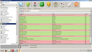

kaz321123 Posted January 20, 2014 Posted January 20, 2014 Pac-Man Pack Theme (5.4MB): https://mega.co.nz/#!iwIRnBRQ!XinLKk...c25SI8HfPvXlC8 Pac-Man Pack xml (work in progress) (rev4): https://mega.co.nz/#!yhQllB5A!IP7C3Rw0WKeRdv98CHDLSFbDFtMbeK2kmtroAyXwiJs This little project is going ok so far. My goal is to have a ton of just pac-man games in one 'system'. If you look at the image here-I have a section named: "Pac-Man pack" Each of the games you see launch through hyperlaunchhq and hyperspin. I basically make significant use of 'alternate emulators' and point other emulator's rom paths additionally to my pac-man pack-where I have roms that are named with numbers like 0001 Atari 2600 Pac-Man. This numbering scheme is used to keep them in nice order on the hyperlaunchhq screen. Image edited: (1-22-2014) -Kaz

kaz321123 Posted January 20, 2014 Author Posted January 20, 2014 Yes-it was a good bit of data entry for the database xml Each game needed its own 'alternate emulator'. And each system (such as Atari 5200) had to point to another folder that contained a rom (I kept all the pac-man roms in one folder for easy renaming later on). I had to pick the right numbers so the list showed up correctly and in order. Tedious is the right word to describe it, however-now I can have a nice list of pac-man games to play from instantly-and the list stays up when I exit out, for instant access to another pac-man game.

kaz321123 Posted January 20, 2014 Author Posted January 20, 2014 The hyperspin part of it is non-existent...and those category names look awful in Hyperspin itself. It clumps together all the *** names. It is hilarious also cuz I have a program called: Hyperspeech-and it tries to sound out the asterixes. I have to name pac-man like: pacman (or it won't say the word right either) It is possible to not have the category names-but then I'd have to write out: Atari 2600 Pac-Man, instead of just 'pac-man'. One way looks nice in Hyperlaunchhq-but ugly in hyperspin. And vice versa

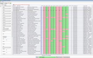

horseyhorsey Posted January 21, 2014 Posted January 21, 2014 I'll try to guide you a bit, I try and keep it short & sweet. Use Dons HyperSpin tools for a nice visual way of doing this. Say I wanted to make a codemasters section I could use the list generator (as above). I've used a filter there on Amstrad CPC xml , codemasters. Can add whatever ones you like to an export list. Ctrl + A to select all and right click and add to export list. Or select one by one. By genre, its all there. Then I could go into Spectrum or whatever and repeat this. You could use the list splitter tool here for manufacturer but just trying to show you that it can be done by picking & choosing. This is the worst example by the way (purposely) to use rom mapping because roms from spectrum & amstrad are named the same (mine are anyway), and that will not work, but should save you before you try the same. ----------------------------------------------------------------------------------------------- Try make some pacman xmls from systems. Save all of these separate. Keep the separate ones, name them by system and also make a new system by merging them with dons merger tool. This merged one is what will appear in HLHQ. I have a script somewhere or even somewhere posted on this forum and will load them up and make a games.ini for rom mapping, and that's it, no renaming roms and all that gash but this list may stay red if you run out of folders to add in hlhq. Probably will be easier to read the system exe tag from the merged in script. I'll find her. Weed Me! HS App: HLM-Check Beta: PinXCheckTunes: http://soundcloud.com/vade/mistys-mind-horse-mix HyperSpin Multiplayer - Take Your Cab online
