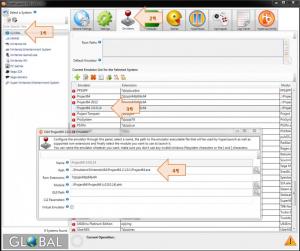

I am trying since 4 days a functioning HyperSpin system to install. after I've read a lot and partly also studied hours of video instructions, I could SNES (snes9x) and Sega Genesis / 32X (fusion561) successfully implemented without problems.
keymapper (Xpadder profiles) and all videos emumovies from my account, I was able to implement.
However, I have the biggest problems with the project 64 system (version 1.6.1 or 1.7.0.49). even with the associated ahk-Modules I could, after trying many, many hours, do not take into operation.

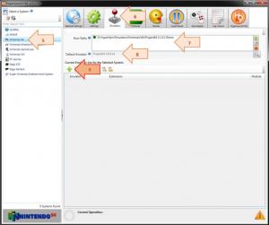

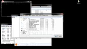

Problem: HS or HLHQ launch a N64 rom -> project64 start and ask for a rom (open rom prompt). I manage not to find a remedy. even after I have updated all modules with the module updater.
I tried various settings which are described in ahk modules notes:
-new install project64 1.6 with 1.6.1 patch
-SelectGameMode 1 or 2 or default (ahk-module 1.6.1)
-On loading a ROM, go to fullscreen (checked)
-Enable CPU (checked)
-Start Emulation when rom is opened (checked)
-System registry (can't find dword for my problem: rom open prompt)
When I use the full rom-path with Ctrl+V insert in this window and confirm by pressing enter, the emulator starts in fullscreen as it should
I'm at the end and are perplexed :vollkommenauf:
I ask for advice. Logs are attached.

16:14:36:992 | MD |     INFO  | +0     | Module WinWait - Waiting for Open ahk_class #32770
16:15:06:997 | MD |   DEBUG1  | +29999 | GetActiveWindowStatus - Title: D:\HyperSpin\HyperLaunch | Class: CabinetWClass | State: 0 | X: 313 | Y: 98 | Width: 831 | Height: 918 | Window HWND: 0x60242 | Process ID: 5824 | Process Path: C:\Windows\explorer.exe
16:15:07:321 | MD |   DEBUG1  | +328   | ScriptError - Playing error sound: error6.mp3
16:15:10:817 | MD |    ERROR  | +3494  | There was an error waiting for the window "Open ahk_class #32770". Please check you have the correct version emulator installed for this module, followed any notes in the module, and have this emulator working outside your Frontend first. Also turn off Fade to see if you are hiding your problem.
16:15:10:829 | HL |     INFO  | +34789 | Main - Module ended, exiting HyperLaunch normally

bribbon I have the same problem! after appear the selection of the rom i get this message:
"There was an error waiting for the window "Open ahk_class #32770". Please check you have the correct version emulator installed for this module, followed any notes in the module, and have this emulator working outside your Frontend first. Also turn off Fade to see if you are hiding your problem."
after search lot the only issue I found is the language of windows (Spanish) but I try to change in the *.ahk file but its seems to be good because have a variables for each language
I use the same emus and combinations than you, I hope someone help us!

Honestly made me(?) the GUI design of hyperlaunchHQ probably more confused than helped.
The whole time I have the Project64 emu added at the wrong place in HLHQ and tried without success to take operational.
I tried to reach the most logical to me. I have added and configured the emulator always right in the emulator 'tab'. That was wrong!
The configuration is much easier - if you know how ..
1. Open HLHQ
1. Global (left side)
2. Tab: Emulators (know you see all modules that HLHQ provides)
3. Search module: Project64 2.0.0.14
4. Edit it with the path to your emu (v2.1.0.1 works well without special editing the module)
5. Switch to Nintendo 64 (left side)
6. Tab: Emulators
7. Add Rom path
8. Important selection-> Default Emulator: Project64 2.0.0.14
9. NOT ADD a emu with the plus -button directly..
a big help was the manual of ghutch92 (thank you man!).
the opposite of the numerous outdated threads and post here in the forum. In relation to the new HLHQ software and their handling of the new ahk-files setup, haves misguided me this unfortunately more. Please consider it for the full guide.
perhaps one could in future versions the GUI design in this regard remodel a bit.
see the second picture: arrow 9 -> this plus button enticed to become downright depressed:pcguru:
