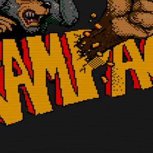

Running MAMEUIFX 172 and currently using GLSL as the shader type.
Everything works great for both Horizontal and Vertical games except for a few Bally-Midway games.
They display differently than the rest. They look like GLSL is doubling the number of shader lines making to many "pixels" on screen all squished together. Doesn't matter which specific shader (HQ, MQ or LQ Geom. Lottes etc...) they all squish to tight.
It only happens on certain Bally-Midway games in the '80 - '84 range.
Spy Hunter, Xenophobe, Rampage, Arch Rivals, Blasted, Discs of Tron, Max RPM etc...

Edit: I think I see what you're talking about on the horizontal games like rampage and xenophob. I tried to get a good screenshot but it looked like crap, so here's an even crappier explanation :teehee:: It looks kinda like a plaid pattern where there are 6-7 horizontal scanlines close together, then a big gap, then another 6-7, etc.

Yeah, your description seems to match mine. Like it is crushing the pixels/scanlines close together incorrectly and making a weird, tight pattern.

Are you referring to this? Does the same on 0.174 BTW.
post-2819-0-67807900-1464815847_thumb.jp
Also tried Spyhunter but that was OK, it was also the same using both video modes that the game has.
Have a go changing "Unevenstretch" to 0, it seemed to make it better.

Yep. That's it Giga.
Wonder when this glitch happened. They used to look fine using GLSL. Pretty sure 169 looked fine, so maybe just since the MAME/MESS merge?

Spyhunter is definitely not OK on my 174. Does the same thing. Turning off uneven stretch seems to really mess up the size and aspect of some games I tried too.
I also tried setting up HLSL for these games, but that also skews the scanlines and pixels as well.
I also found that the game Aaaarg and some Namco System22 games have the same problem.

This issue is still around in 175, but Jezze updated one of the HLSL files to get these games to work.
They do need their own individual HLSL settings though. So I set that up and can now just copy/paste an ini for any game with the issue.
I still can't get Rampage to render right, even with the decreased scanline height.  :pardon:

Yes, Rampage is one of the games that doesn't display right with GLSL. Like Aaarg and Blasted. Spy Hunter 2 & Arch Rivals and a bunch of others. You can get them to work right with HLSL but it takes special half-settings.

Why I asked Griffin yesterday which GLSL shader he was using is because I tested the no curve shader and it looks better, the curve causing it to be uneven.
You can name your ini file after the driver (mcr3) or create per game ini's for the likes of spy Hunter.
I'll attached a vertical version of the shader.
