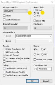

gigapig Posted May 17, 2016 Posted May 17, 2016 Weird, I thought it was pretty clear unless you use a different plugin but it should be the same.
mosaiclive Posted May 17, 2016 Author Posted May 17, 2016 Yeah, mine does not look like that. I wish it was that obvious on mine! You guys probably think I'm blind or something. As I probably said in another thread, I didn't initially set this system up. Someone built it for me, since I really didn't know the first thing about hyperspin, MAME, etc. and haven't used a PC since Windows '95(!). I'm only running into "problems" because I'm picky and want to change/customize everything. I'm getting the impression that the person who set it up liked all their emulators to run stretched since nothing on this system was set to 4:3. I've been having to change everything myself. I think some of the emulators are maybe older version where the settings aren't so easy to see.
mosaiclive Posted May 17, 2016 Author Posted May 17, 2016 Here's a bit more info: I'm running Demul x86 v0.56. When I launch the emulator from Hyperspin/Emulators/Sega Namoi/Demul, I get a Sega Dreamcast emulator that just has one page of video options (screen resolutions only, no aspect ratio options). Gigapigs picture says "Demul Direct 3D11 Graphics Configuration"- am I looking in the wrong place or does he just have a totally different version? Sorry for all the questions- there's a lot to wrap your head around with all this stuff!
boomerps2 Posted May 27, 2016 Posted May 27, 2016 The module defaults the aspect ratio to 4:3 with no option in Rocketlauncher to adjust that. There is a line in the module you have to adjust and every game will be 16:9 widescreen.
