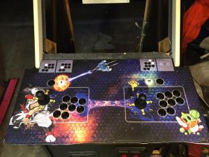

Okay, so here is my take on this.  I don't necessarily plan to add any console games, just using MAME.  I have an 8 button layout (see photo) and am using the X-Arcade control board.  What I like about the layout might be specific to the X-Arcade control board.  Allow me to explain.  If I am playing any game that is not SNK/NEO GEO the buttons work as expected.  When I launch a Neo Geo game the buttons change, buttons 1-3 no longer work and button 7 becomes button 1 button 4 is 2, 5 is 3 and 6 is 4.  Because of the configuration I installed my buttons in, it perfectly mimics (not 100% but enough for me :) )the Neo Geo arcade layout and I love it.
