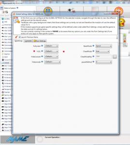

There should be a setting in HLHQ under "edit Global module settings " to switch it on.
HyperLaunch would then inject that setting into the cfg or ini, where I think you'll find the settings to change the scanlines look.

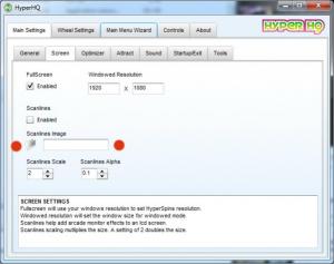

under HyperHQ i am under the main settings under (screen tab) where i enabled it and the scanlines scale is at 2 - scanlines alpha is set at .01
i still see no difference. Suggestions?
Please look at attached file.

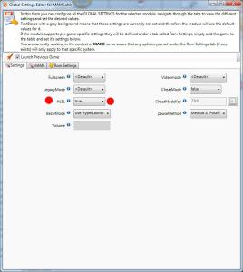

I said HLHQ (Hyperlaunch HQ) if your using that.

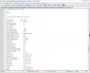

The setting is here. You can change it to true.
The above should be enough to switch it on, but I think the main settings for mame HLSL are in the Mame ini folder.
Then you would need to try to do it in the Mame ini folder, see the screen shot in my previous post, I have marked what you need to change.

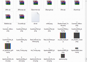

Scanlines for MAME need to be enabled within MAME. it's in default game options. you may need to browse to the artwork folder for them. They are not enabled by default.
For anyone who needs it here is my Mame.ini. I'd like to thank potts43 for the wonderful hlsl settings. I never really liked it before, until I got these settings.
The paths will be wrong for you, and the only section you need for this, are in this section in the ini " DIRECT3D POST-PROCESSING OPTIONS"
I've put the mame.ini in my ftp folder as well. /Upload Here/gigapig/Mame

Those settings will produce this effect.
VFiBvam.jpg[/img]
You will probably need to turn it on in HLHQ as well.
VFiBvam.jpg[/img]
[ATTACH=CONFIG]39749[/ATTACH]
Where are you getting "crt_slot_mask.png" from? I don't have that in my artwork folder.
Can you kindly upload it to your FTP folder?
Thanks!
Thanks!
It's in /Upload Here/gigapig/Mame/Scanlines
OK thanks, I found it.

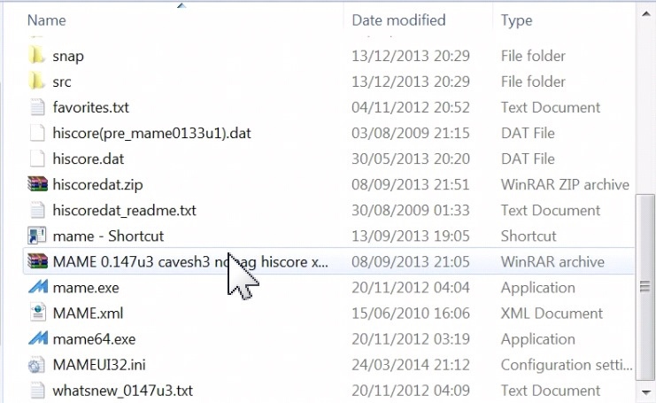

I have just downloaded an older version of Mame, version 0.147 x64, to see the folder structure. Your right, there is no ini folder in that version, nor in version 0.152, so i assume that the ini folder is either added by the user or used in other versions of Mame, other than the command line version.
However there is a hlsl folder, mine has an hlsl.ini file with the same settings, so the may have to create that ini inside the hlsl folder and enable it.
I'm not sure of the history or why things are different, perhaps someone else knows, or I'll have to do some reading.

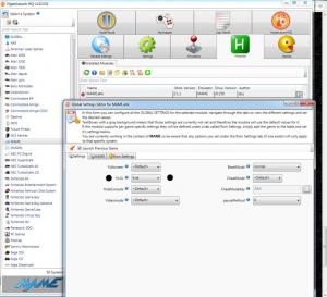

Sorry I'm not sure what your asking, do you want scanlines or do you want them off?
If you want them off then you must change the setting below in HLHQ to false. Changing settings in Mame will make no difference.
[ATTACH=CONFIG]52556[/ATTACH]
Thanks that worked
