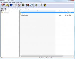

Open up the rom file and take a look inside. It should look like this:

So hooray. Brolly, thanks, your advice fixed the immediate problem. I unzipped the roms, and added lha as a rom extension in HL so the LHA file is now being passed to the emu.
