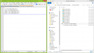

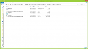

thatman84 Posted October 7, 2016 Posted October 7, 2016 So I have done some LIMITED testing with 3 games in gdi format Tony Hawks Tony Hawks 2 Dance Dance Revolution The .gdi file WORKS with Hyperspin and Reicast and can be named to match the Sega Dreamcast.xml Method 1: So first off you can convert .gdi format games to chd format and that worked with Dance Dance. (It also reduces the size of the game by a bit which is good on storage) It took about 5mins to do on my i3 laptop while downloading through FTP and transfering some files to USB at the same time WARNING Backup you games before converting to chd as I dont know of a way to return them (although I believe there is a way to do it) There are programs out there somewhere to do this when the game is in .zip or .7z format but I could not find one My simple single unzipped manual method is here To do this you need the chdman program from any recent MAME install 1. Place the chdman.exe in the folder with you .gdi game 2. Create a .txt file with the following text (EXACTLY as below) for /r %%x in (*.gdi) do chdman -createcd "%%~nx " "%%x.chd" 3. Save this .txt file as chdbatch.bat 4. Place your chdman.exe, chdbatch.bat, GAMENAME.gdi & associated .bin/.raw files in the same folder (you can run the .bat in the directory of all game folders but it's going to take a while!) 5. Run (double click) the .bat file and wait for the conversion to finish 6. You will be left with a GAMENAME.chd 7. Do this for all your games and make sure you add chd to your extensions in the Sega Dreamcast.ini file Method 2: Renaming the .gdi and associated track files is possible BUT its limited and very specific which means you will have to custom rename EVERY single track file for ALL games and also rename them WITHIN the .gdi text file The track files dont seem to like any spaces in their name within the .gdi file (I only tested 2 games) This means you cant rename by the .gdi file name/gamename entry in the database The process is similar to bin/cue if you are familiar. 1. Match all your .gdi files to the gamename entries in the database like you normally do with ALL roms 2. Rename ALL the track files for that game DONT USE SPACES (i tested and ' worked in the name not sure on other special charcters) I guess you can use ANY naming format you like. (for Tony Hawks & Tony Hawks 2 I used thpstrack01.bin thps'2track01.bin) 3. Open the .gdi file with Notepad++ 4. Change/match all the track file names in the .gdi file to match your renamed track files Now you can place EVERY track and gdi file in one folder and launch from hyperspin If you only have a few games it could be ok. I ONLY TESTED 2 so far and cant decide what to do so will leave it for now Hyperspin 2.0 Latest Download Hyperspin 2.0 Documentation -------Pre Hyperspin 2.0 Below---------- HS Android Overview & Install HS Android Base Pack Download My Tutorials
