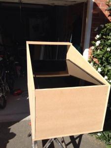

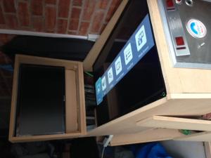

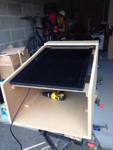

r3nvl Posted March 16, 2014 Author Posted March 16, 2014 Ok, so it all sort of went to pot. I just couldn't live with a 32" screen for the play field. Ive been out and bought a 40" LED Toshiba. Had to build a new cab (of course) and it fits perfectly. There is a good amount of bezel all around the screen. And by that i mean an equal amount. Didn't want to decade it as it came with 5 yr warranty! Ive also got a nice coin door fitted and have installed it flat to leave space for flashers etc. What do we think so far?? I think the angle is too steep. Now do i just cut it down in size, or angle the TV a bit???
Luckydogg420 Posted March 16, 2014 Posted March 16, 2014 I think in my build I angled the screen 6 or 7 deg toward the player. I prefer it over a horizontal mount and think it looks better then mounting on top of the cabinet sides. The new tv should be way better. Looking good so far.

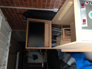

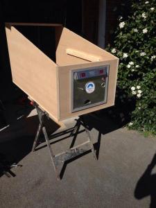

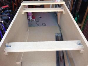

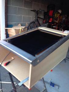

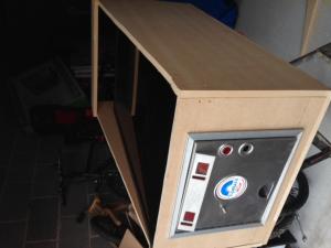

r3nvl Posted March 18, 2014 Author Posted March 18, 2014 So, cut down the cab, so that the angle is much lower. Test fitted both screens, with coin door and make sure viewing angles were ok on the screen. Pics attached. Not sure why they are on the p*ss.... GRRR To view, do this...
richie_jones Posted March 22, 2014 Posted March 22, 2014 Cutting down the cab made no difference to the angle though...I'd definitely angle it up a bit
r3nvl Posted March 24, 2014 Author Posted March 24, 2014 Ill check it out. Im deffo rebuilding the back box as I'm not happy with it. Ive agreed to buy a DMD + PinDMD2, so will build it with that in mind.
