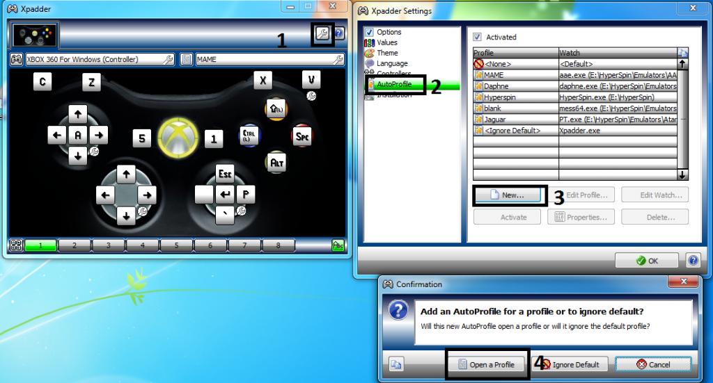

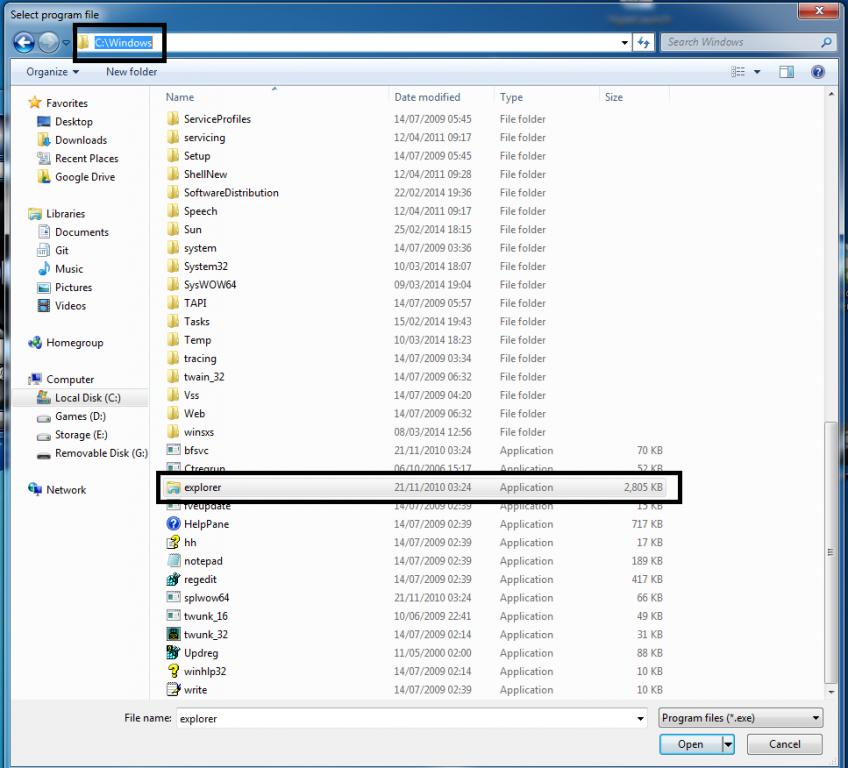

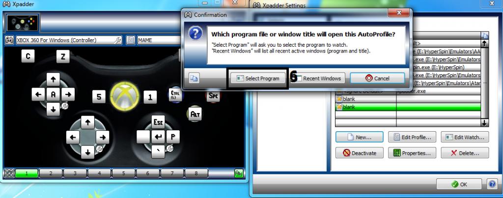

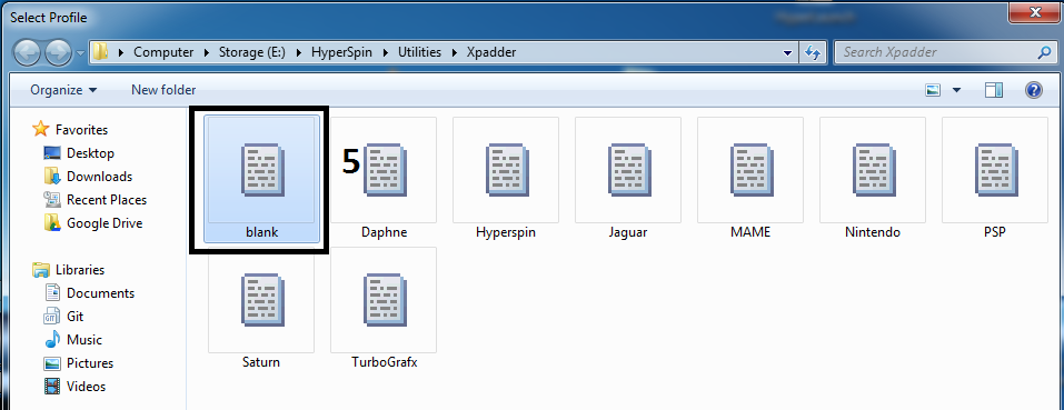

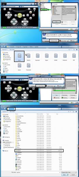

Shermo Posted March 10, 2014 Posted March 10, 2014 I just use xpadders built in auto profile. Have a blank profile with back button set to escape (which needs to be held for 5 secs to activate) set it for all emus you are going to use the emus input and set it for explorer.exe so it uses blank instead of hyperspin config. I found it easier using this method Sent from my XT1032 using Tapatalk

Shermo Posted March 10, 2014 Posted March 10, 2014 As soon as you click anywhere on desktop it will go to the blank profile Xpadder profile for blank with escape key set to hold for 7 seconds, Use for all you emus that you have configured the input in the emu's https://mega.co.nz/#!zBFhARLA!OZmpuuhO747s8dviupHMMAC09c6prraMaUVHX9qV7IU

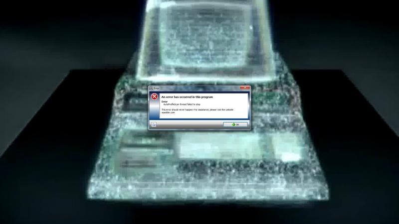

Duckie Posted March 17, 2014 Author Posted March 17, 2014 ok i will look into those links later... oh and the error message...i cant just reproduce it...it just happens. Now i got it after the 3rd time i restarted hs. First 2 no problem...3rd time this error

sparkywallnut Posted March 17, 2014 Posted March 17, 2014 [ATTACH=CONFIG]39317[/ATTACH][ATTACH=CONFIG]39318[/ATTACH][ATTACH=CONFIG]39319[/ATTACH][ATTACH=CONFIG]39320[/ATTACH]As soon as you click anywhere on desktop it will go to the blank profile Xpadder profile for blank with escape key set to hold for 7 seconds, Use for all you emus that you have configured the input in the emu's https://mega.co.nz/#!zBFhARLA!OZmpuuhO747s8dviupHMMAC09c6prraMaUVHX9qV7IU Thank you for this! I've been trying like hell to get xpadder to work through hyperlaunch but I was having some trouble getting xpadder to switch profiles while in Hyperspin. This method worked like a charm for me. The only thing I don't understand is how you have Mame working with xpadder? Did you have to make a profile for each game? That would be crazy! Lol I so wanted xpadder to work through hyperlaunch, I just don't understand what I was missing. I'm using the latest hyper launch, modules, emulators and the version of xpadder is the same one in the tutorial that's floating around here. Anyway, thanks again! [sIGPIC][/sIGPIC]

ghutch92 Posted March 18, 2014 Posted March 18, 2014 I've honestly have never seen the auotprofilescan error so I do not know how to fix it. Try deleting the xpadder settings file in the same file as xpadder.exe and see if this helps. It should be a .ini file if I correctly recall. How to Install HyperSpin and more RocketLauncher HyperSpin Startup Script
