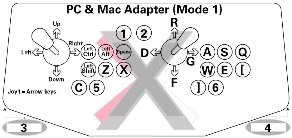

ro1and Posted October 31, 2016 Share Posted October 31, 2016 Hello, I am having trouble with configuring the tank stick to play Genesis games. I'm using retroarch. I press the F1 button and configure the button and everything looks great except the 2 player down joystick. Whenever I press the joystick down, it changes the screen to a small screen and the sound crackles. How can I change this?? What is it that I'm doing wrong? Please help. Link to comment Share on other sites More sharing options...
32assassin Posted October 31, 2016 Share Posted October 31, 2016 you are not doing anything wrong you are only experiencing the suckage of a Tank Stick very easy to see this, Retroarch Service keys mapped to your buttons Full Screen toggle = F another problem --> if you use the nesptoia core (NES) don't press 5 or you will load your 5th save state. , I don't use Retroach so its not something I can help you with but you can disable the service keys in Retroach Link to comment Share on other sites More sharing options...
thenoob Posted October 31, 2016 Share Posted October 31, 2016 I literally Just went through this this morning , It's the player 2 down key input that the tankstick has programmed into it. You need to change it in the hotkey section of retroarch and all will be fine!! Can't wait to build a cp Link to comment Share on other sites More sharing options...
