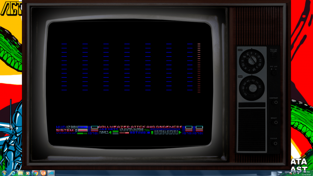

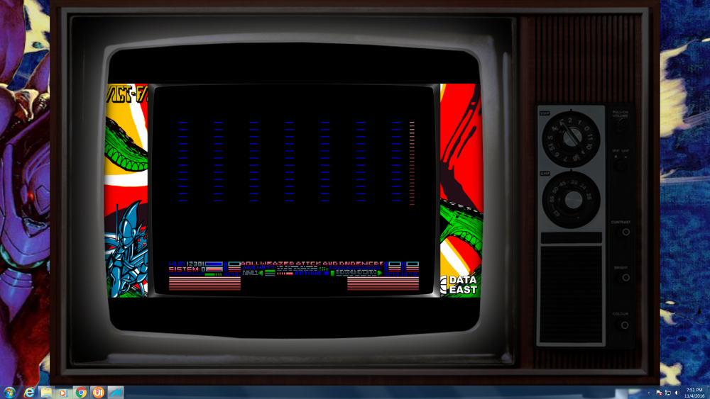

SpykSaturn Posted November 4, 2016 Author Posted November 4, 2016 Ok I am sorry I keep adding stuff but I did an experiement and I can say with absolute certainty now that rocketlauncher is recoanizeing and not recognizing my bezel and its own as a bezel within a bezel. Confused yet? I am going to attach some pictures that will either blow your mind or tell you exactly what the heck is going on. So the first shot is when view is cropped using the MAME video options and the second shot is when its switched to full. It's almost like its choosing a bezel, using it as a backround, then adding its own bezel because it doesn't detect a bezel, and then putting the bezel I am actually choosing inside of its own bezel. I still don't know whats going on
