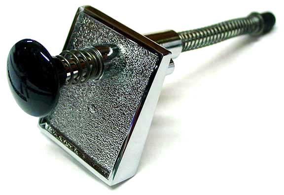

an analog input for your
ALl for $20  +  analog ($10 slide potentiometer )  or  digital ($40 TAOS TSL 1410R CCD linear array sensor ) plunger input hardware
link and a 3D printed mounting bracket is available in the Pinscape website.
