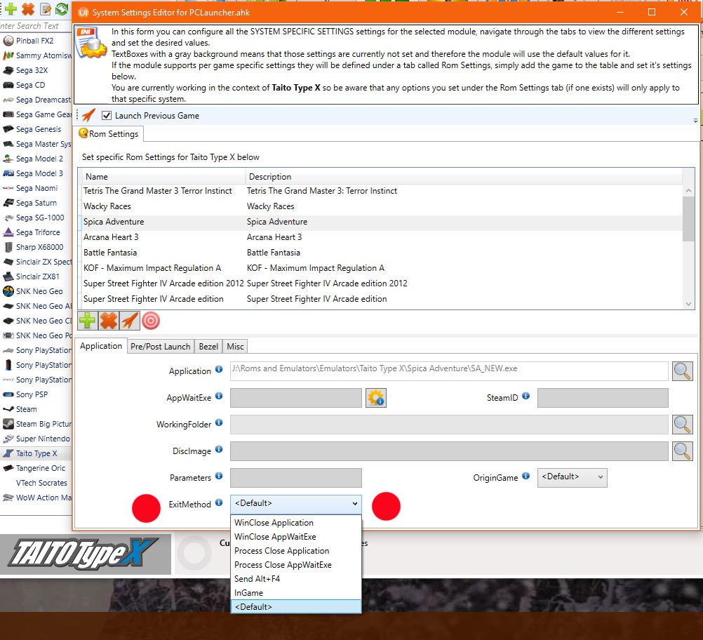

gigapig Posted December 2, 2016 Posted December 2, 2016 Question which will rule out your exit keys or if it's just TTX. Does your exit method work on other systems? Also in the module settings for TTX you can chang the exit method. There are around four choice for example send alt-f4, so try a different one.
acpowell Posted December 2, 2016 Author Posted December 2, 2016 1 hour ago, Metalzoic said: Well one thing I see is that you have both the 2 and 3 keys selected as exit, but you have it set to a single keypress instead of double. That's my guess If I understood it properly Single means you are pressing the buttons once and double means you press them twice like a double click. 13 minutes ago, gigapig said: Question which will rule out your exit keys or if it's just TTX. Does your exit method work on other systems? Also in the module settings for TTX you can chang the exit method. There are around four choice for example send alt-f4, so try a different one. I did not set it in the module itself just globally. It does with with Demul with no issues. I will add it to the module directly and see how it goes.
bleasby Posted December 2, 2016 Posted December 2, 2016 as giga said, you need to set the exit method that works for each taito type x game independently. There is not a universal solution for that, that is why this setting exists. Also, please delete either the 2&3 or the 3&2 exit key combination. You just need one of them set and I don't know if adding the second one will result in the desirable behavior. When asking for help for RocketLauncher, POST ON THE RLAUNCHER.NET FORUMS! Also, please post your RocketLauncher.log with logging level set to troubleshooting in pastebin (set the log level in RocketLauncherUI, global system > General Settings -> RocketLauncher). Ass. Bleasby - RocketLauncher Development Team.
acpowell Posted December 2, 2016 Author Posted December 2, 2016 Sorry I didn't say this earlier. I did play with the exit methods and none of them worked. I will test removing one of the "duplicate" entries. I had them both in there because demul was giving me issues originally and that was one of my troubleshooting methods.
