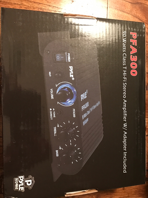

mafiafan123 Posted June 4, 2017 Posted June 4, 2017 I had a similar one and then switched to this one I went through 3 though as build quality on these amps suck unfortunately Sent from my iPhone using Tapatalk
