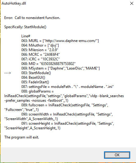

johnny50 Posted September 30, 2017 Author Posted September 30, 2017 I followed the instructions to a T on the hyperlinks website. I get this error:
volumetric Posted September 30, 2017 Posted September 30, 2017 Not sure, looks like it can't find startmodule. Are you using rocketlauncher or hyperlaunch? If you're using RL could be that Hyperspin isn't connected to RL properly. Can you post your HS log?
