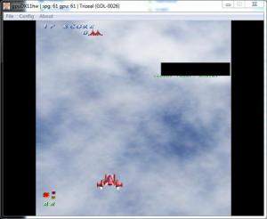

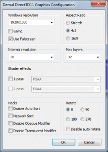

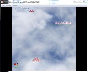

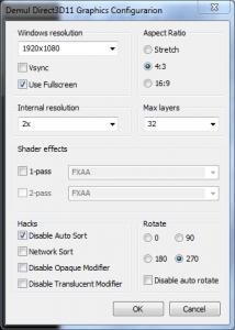

gigapig Posted May 5, 2014 Posted May 5, 2014 I'm not sure hows right, I think because of the way the hack is labelled it's confusing. Here is "Disable Auto Sort" Checked Here is "Disable Auto Sort" unchecked It lucky that these settings can be made on a per game basis.
Trnzaddict Posted May 5, 2014 Posted May 5, 2014 I'm not sure hows right, I think because of the way the hack is labelled it's confusing.Here is "Disable Auto Sort" Checked [ATTACH=CONFIG]40850[/ATTACH] [ATTACH=CONFIG]40851[/ATTACH] Here is "Disable Auto Sort" unchecked [ATTACH=CONFIG]40852[/ATTACH] [ATTACH=CONFIG]40853[/ATTACH] It lucky that these settings can be made on a per game basis. Thankyou. I knew I wasn't going crazy. If it's labelled incorrectly in the emulator and and checking disable auto sort actually turns it on, then that is yet another major bug in Demul. And yea I agree with the post a couple above about the way the emu continues it's retarted development and it's dx issues. Sadly, the Demul devs seem very arrogant and just do as they please and barely release updates. I am......Machine
