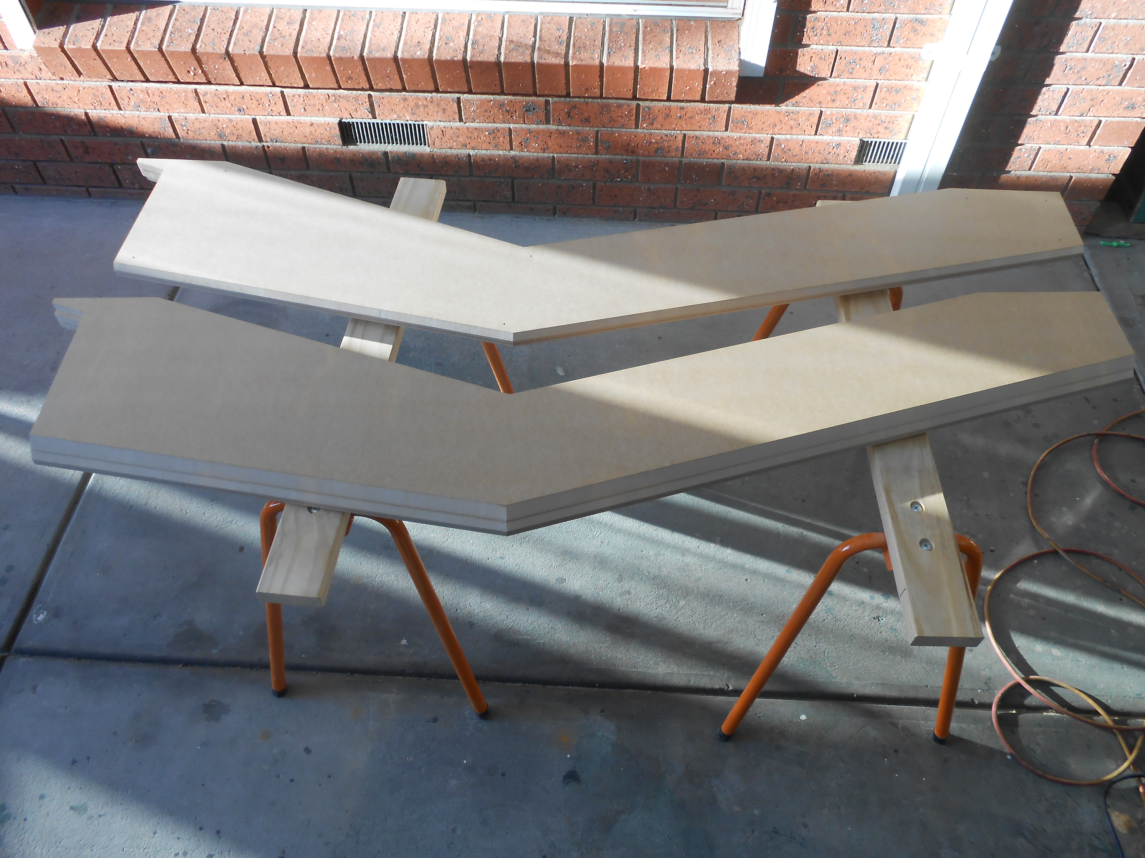

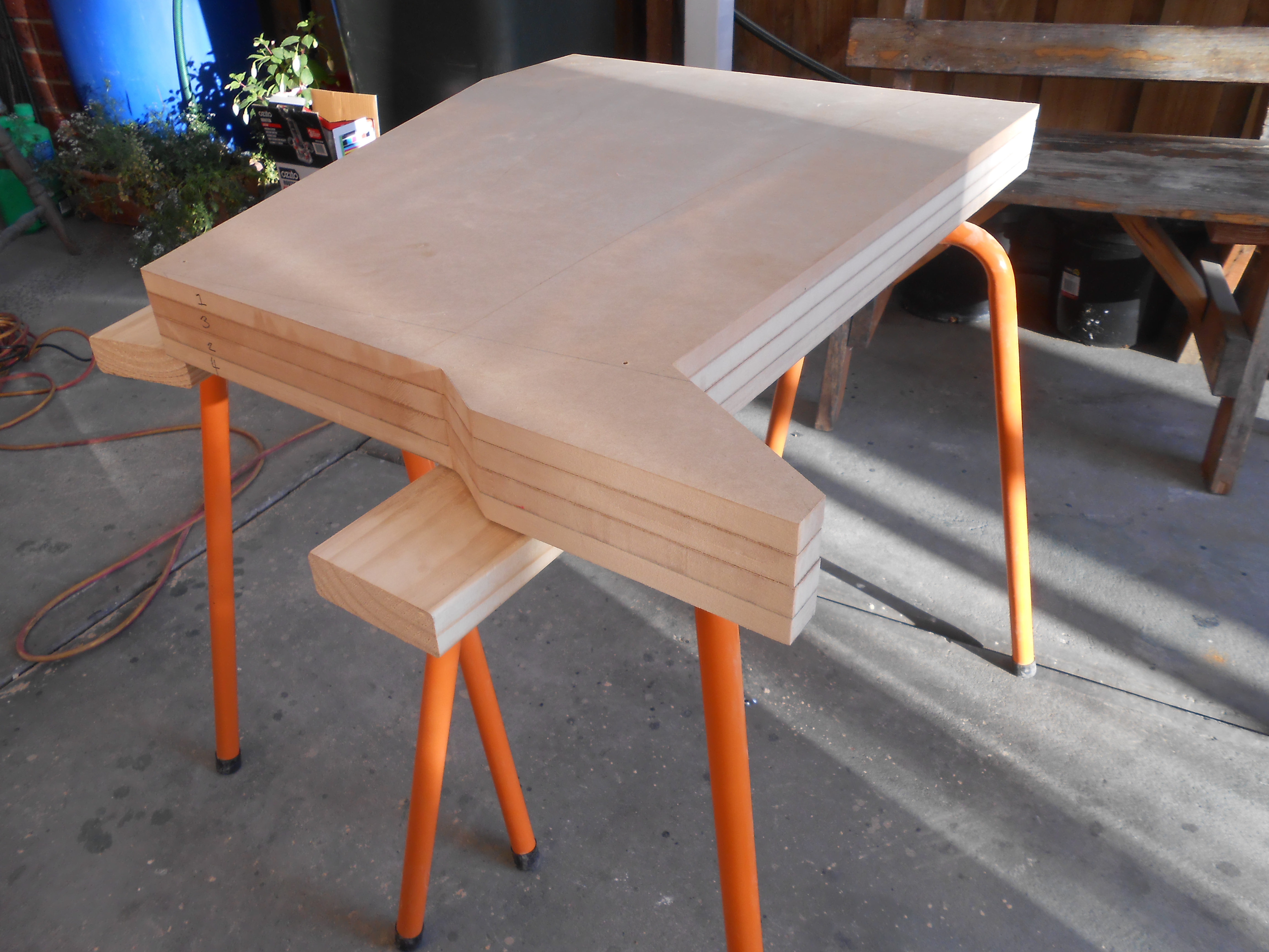

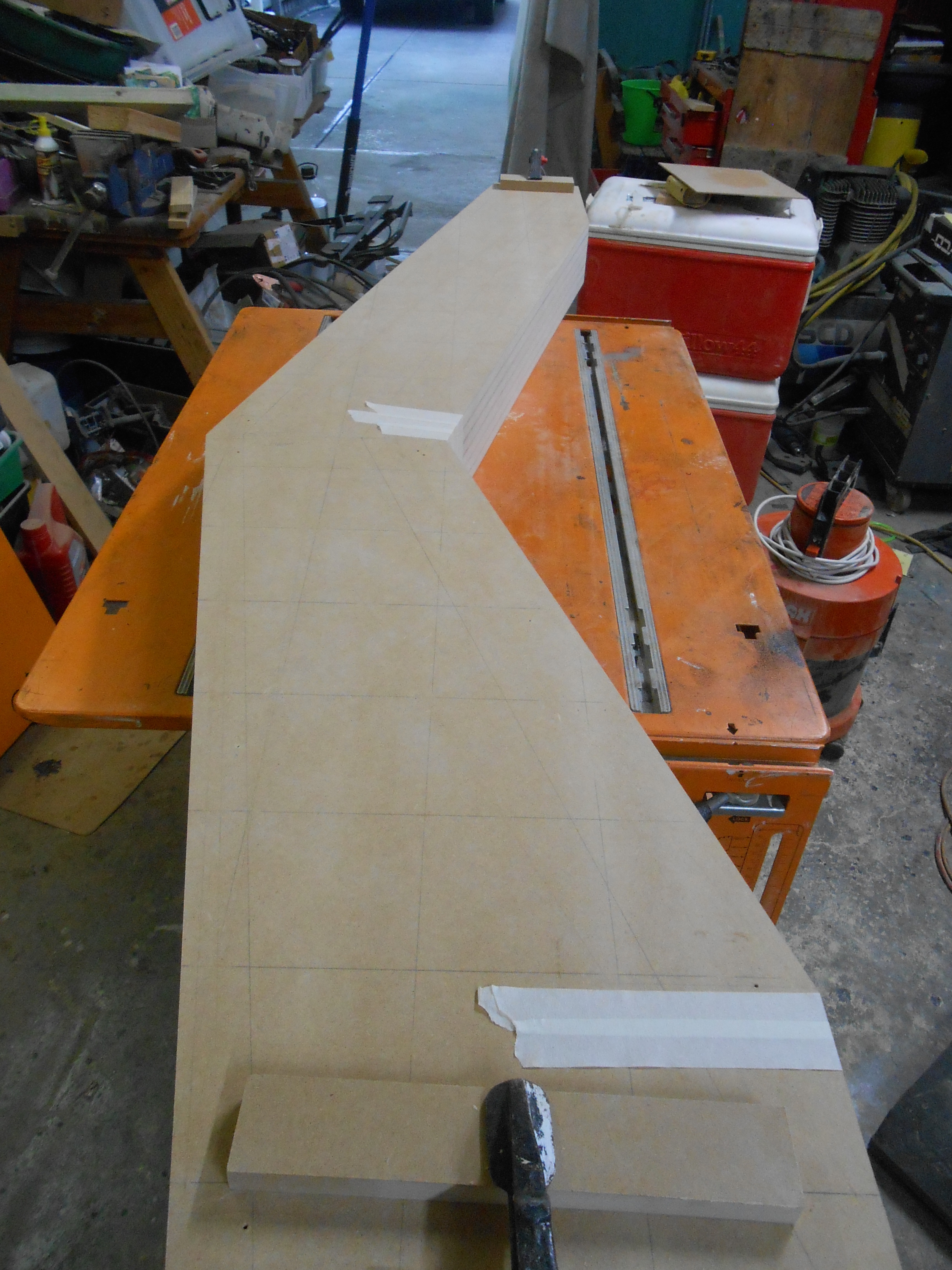

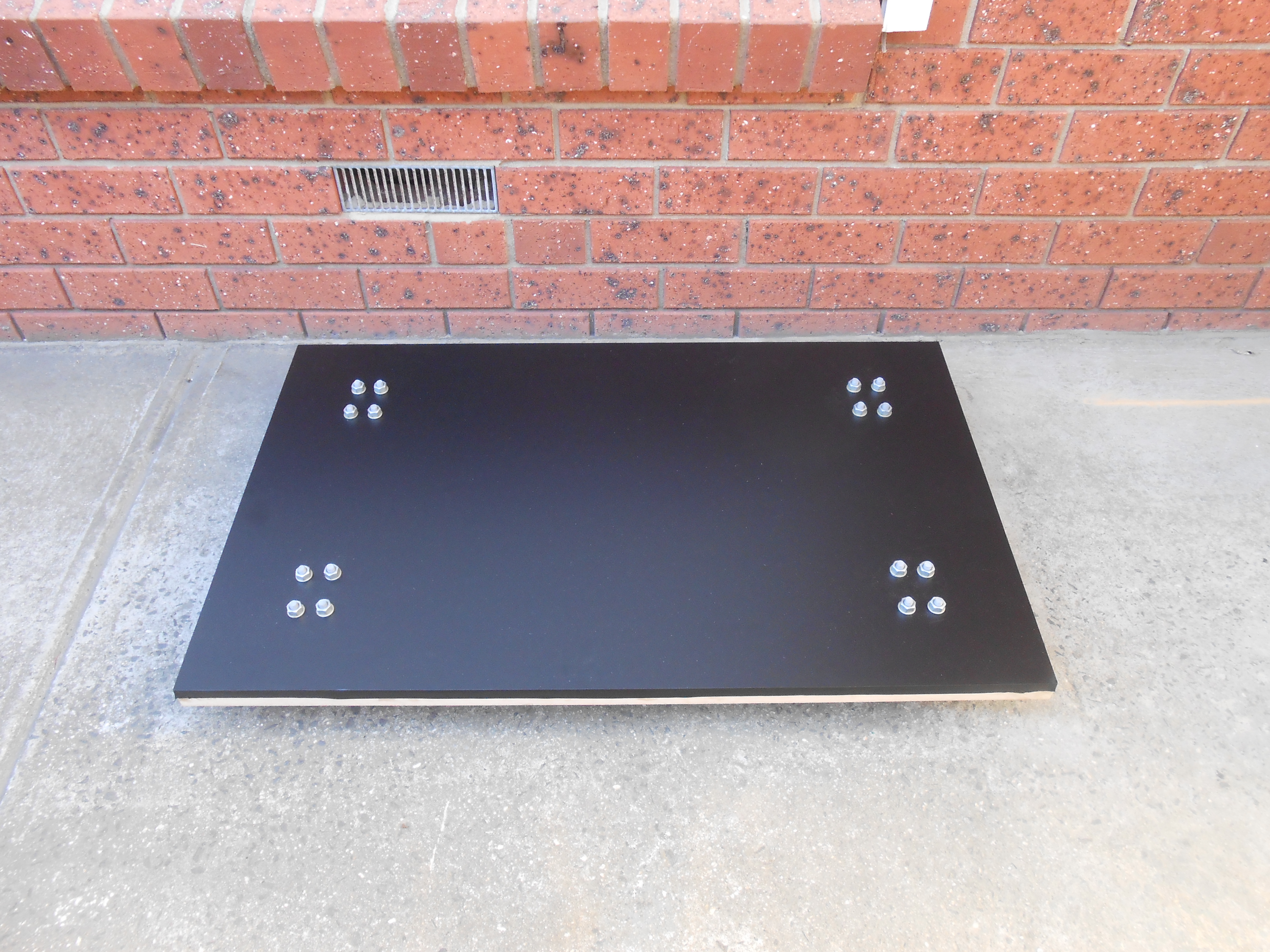

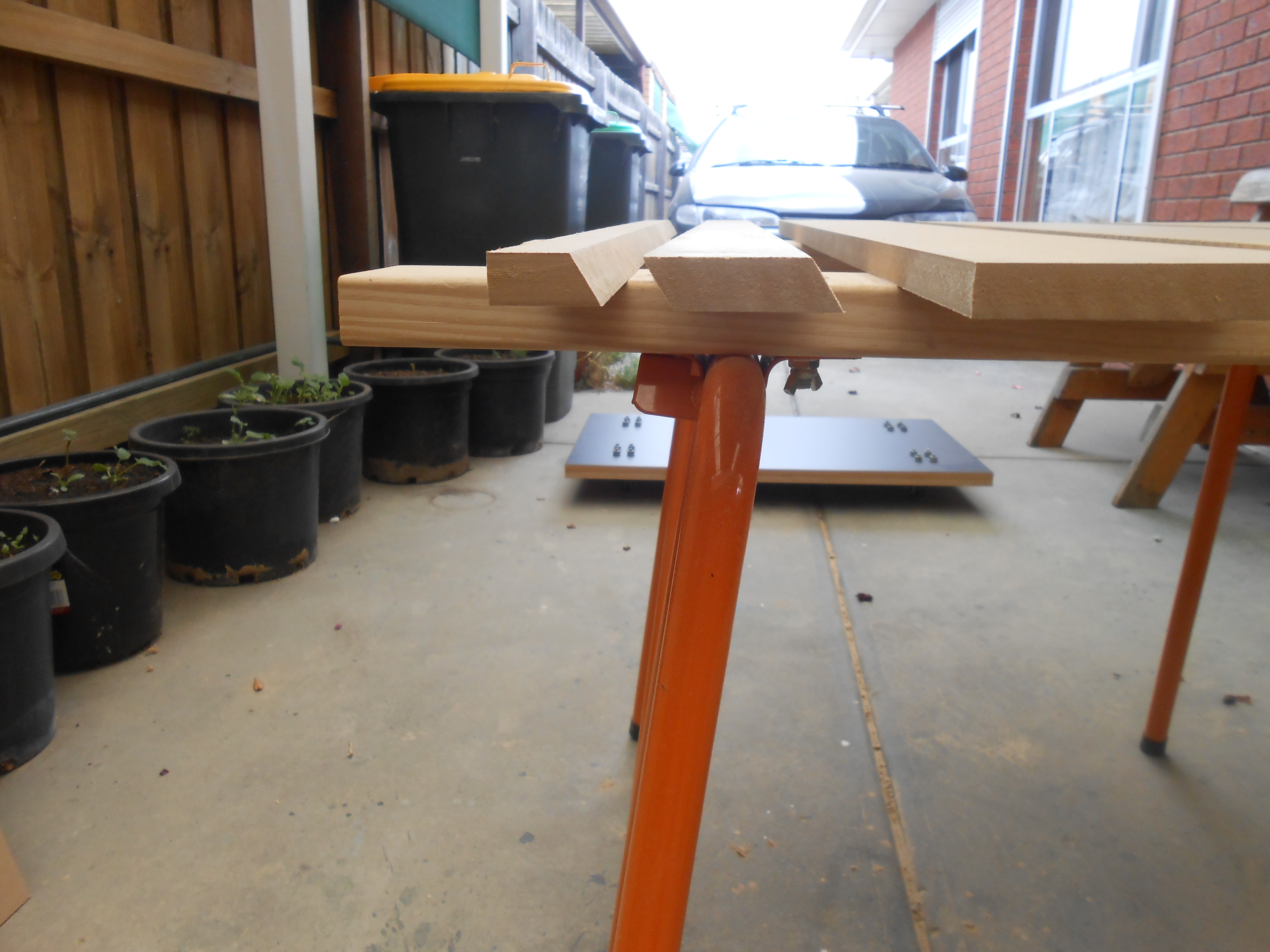

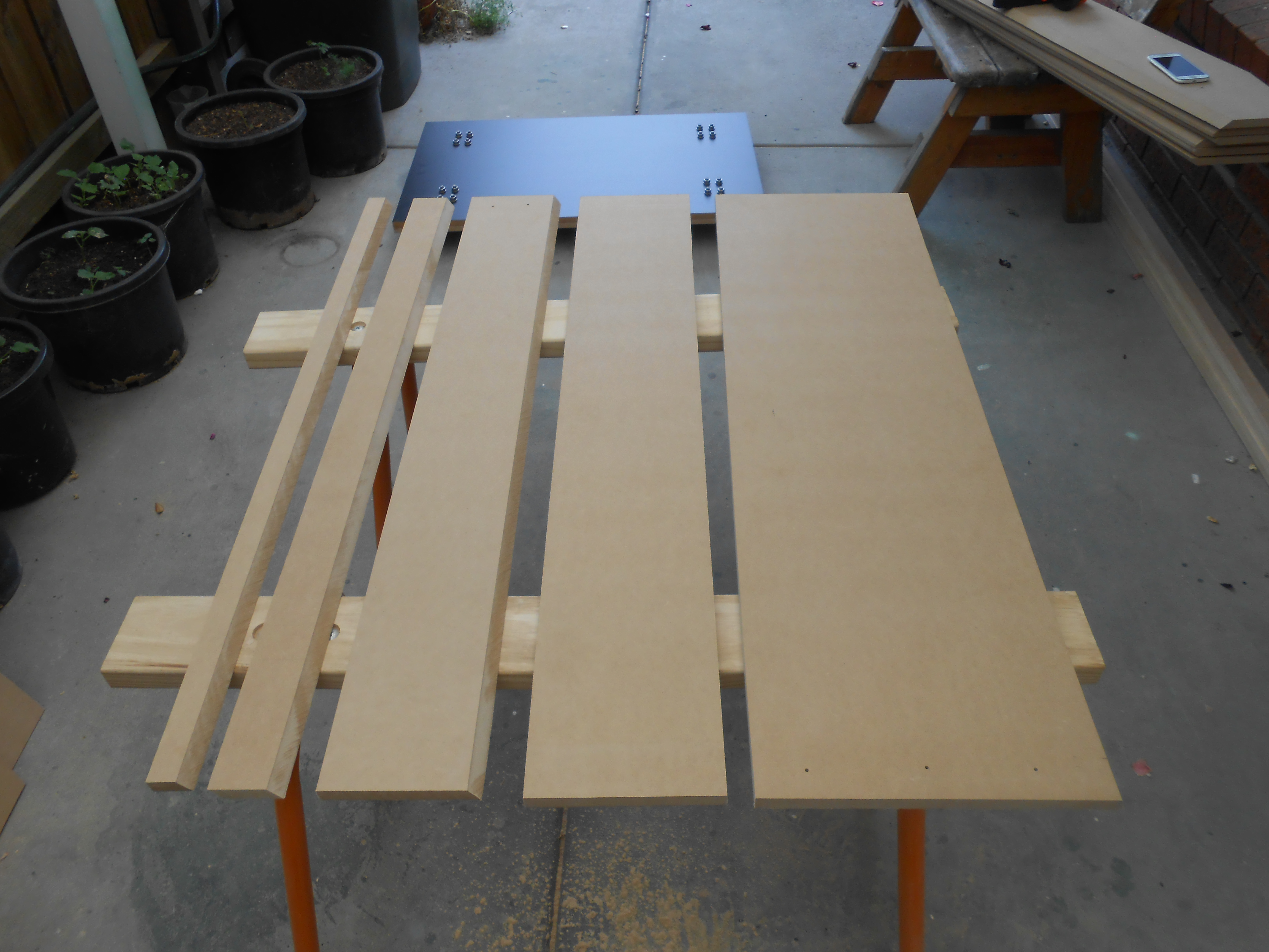

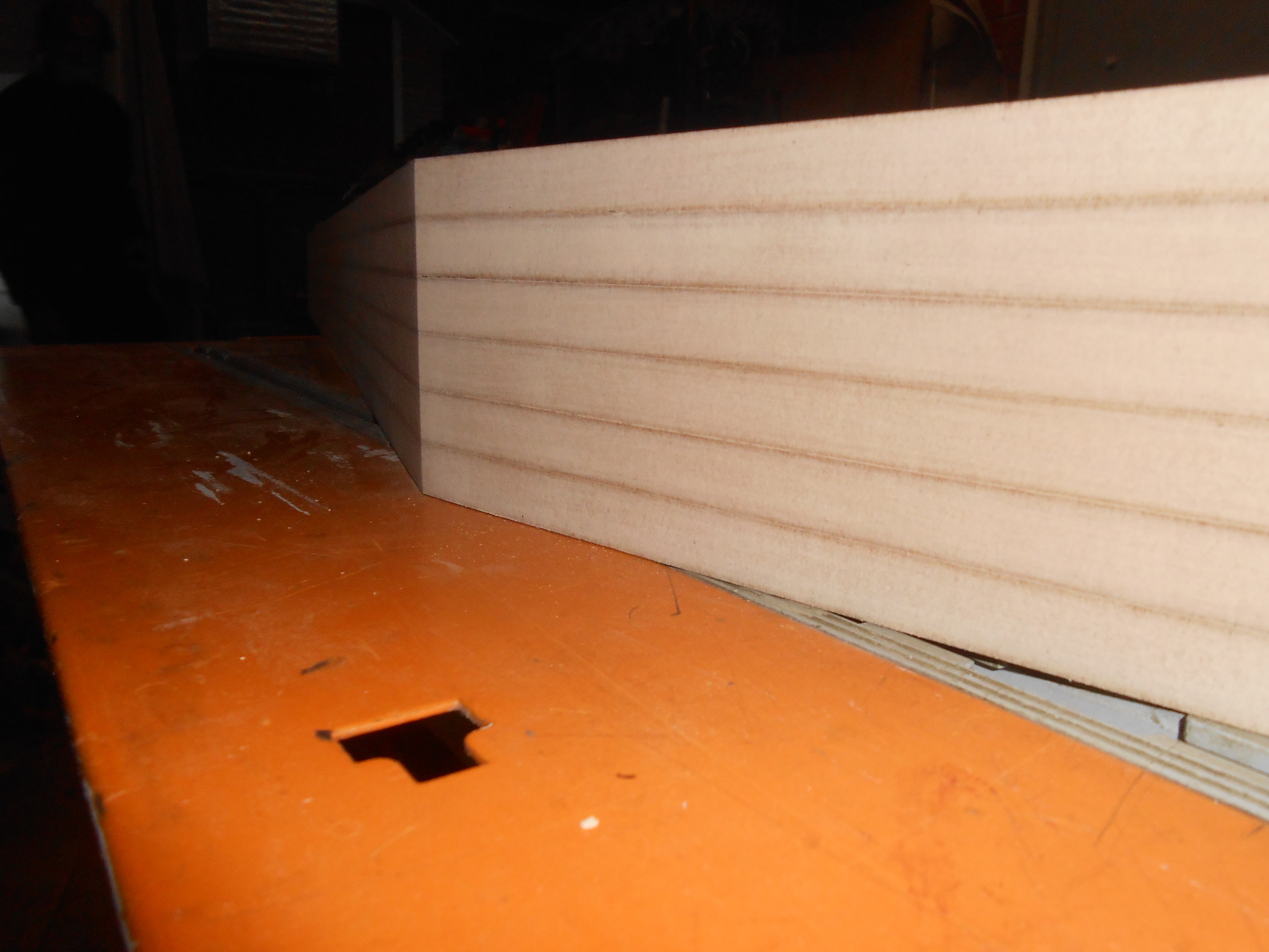

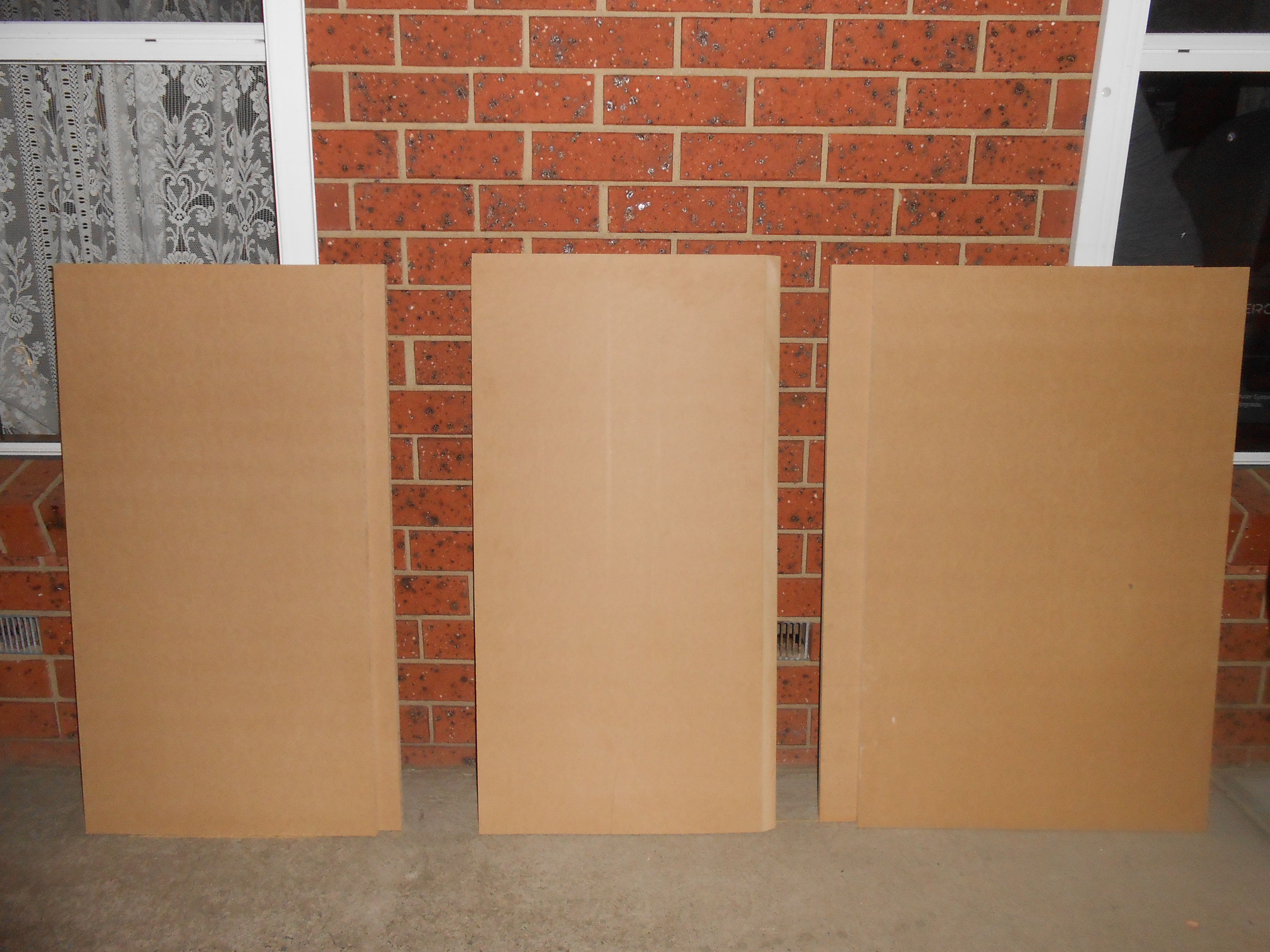

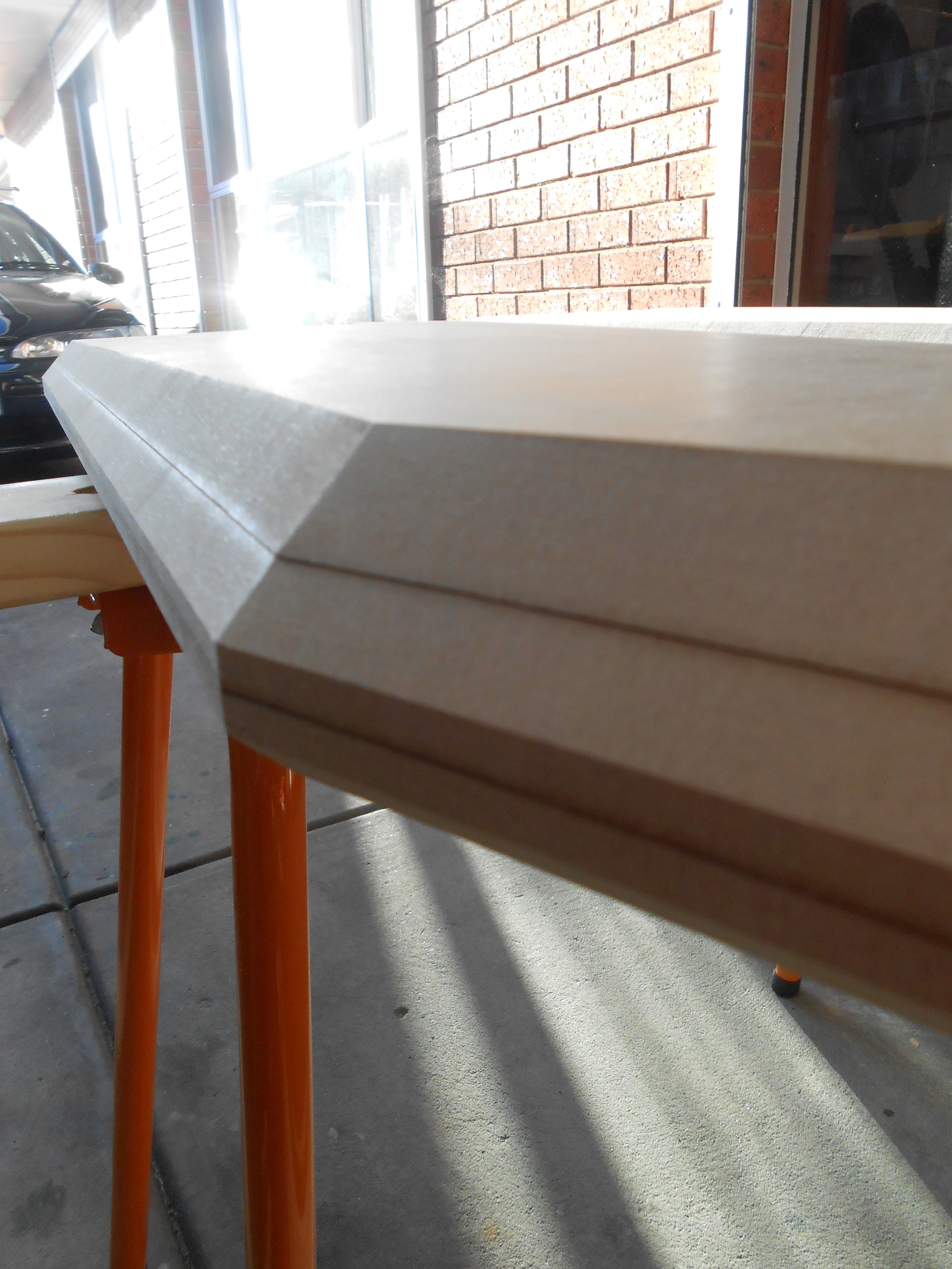

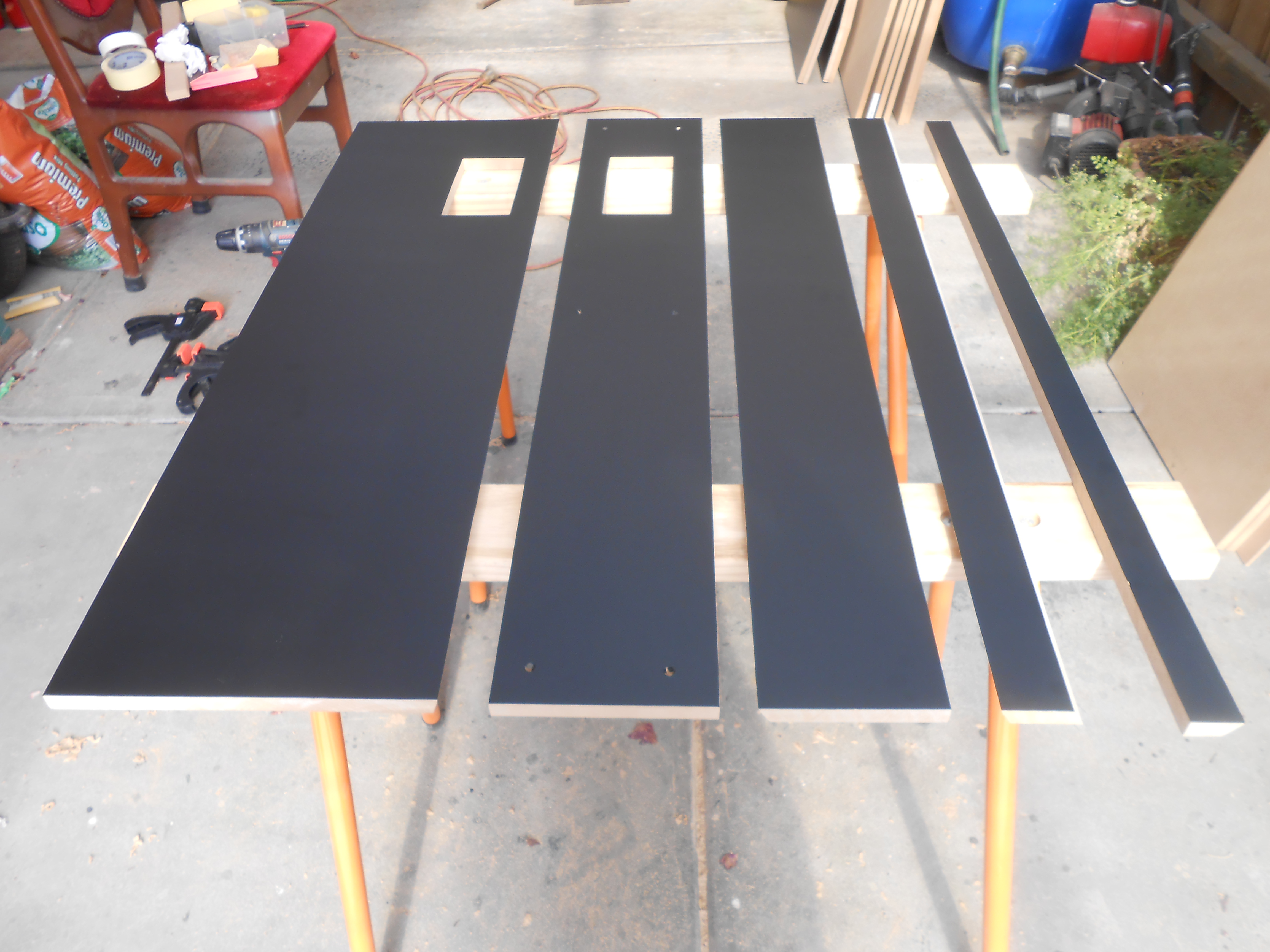

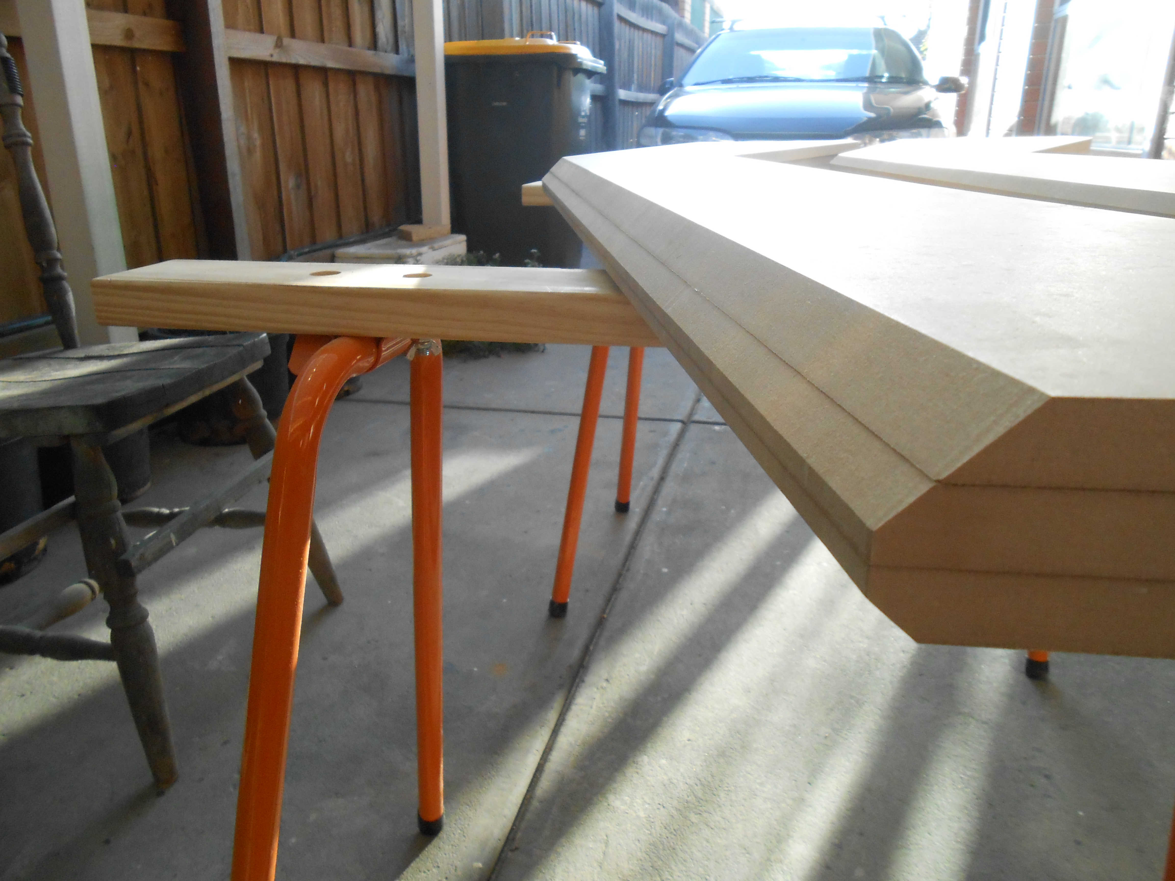

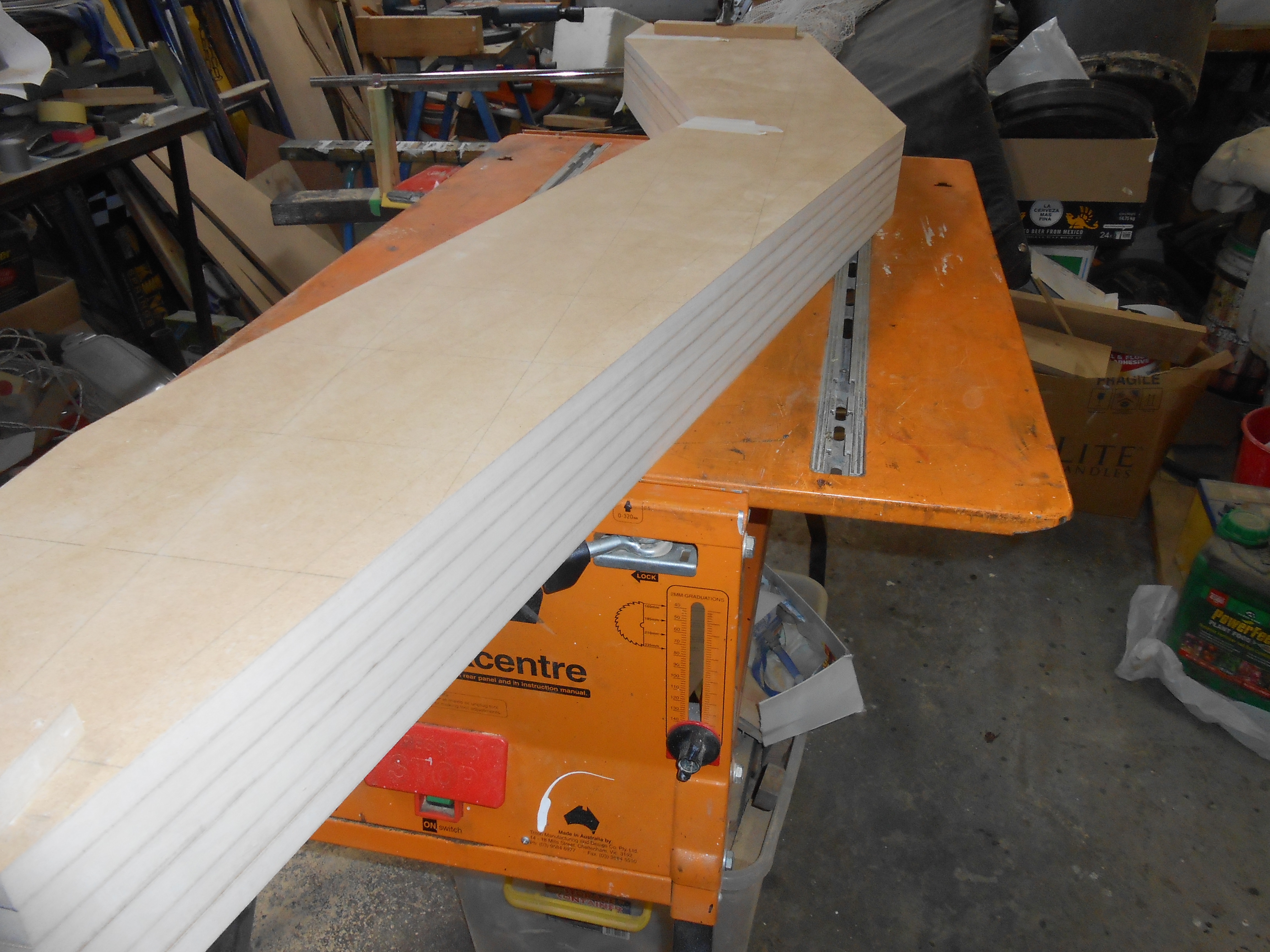

Another little update. Cut the pieces for the base so I can join the two pieces in the above image. I also cut two pieces for the control panel, this was cut now so I have the same measurement from the bottom to the top.
The two pieces on the left are for the control panel.
The one in the middle is to hold the box at the top.
The two on the right are for the base.
Just need to glue and drill the pieces tomorrow after work and hopefully it will start looking like something!

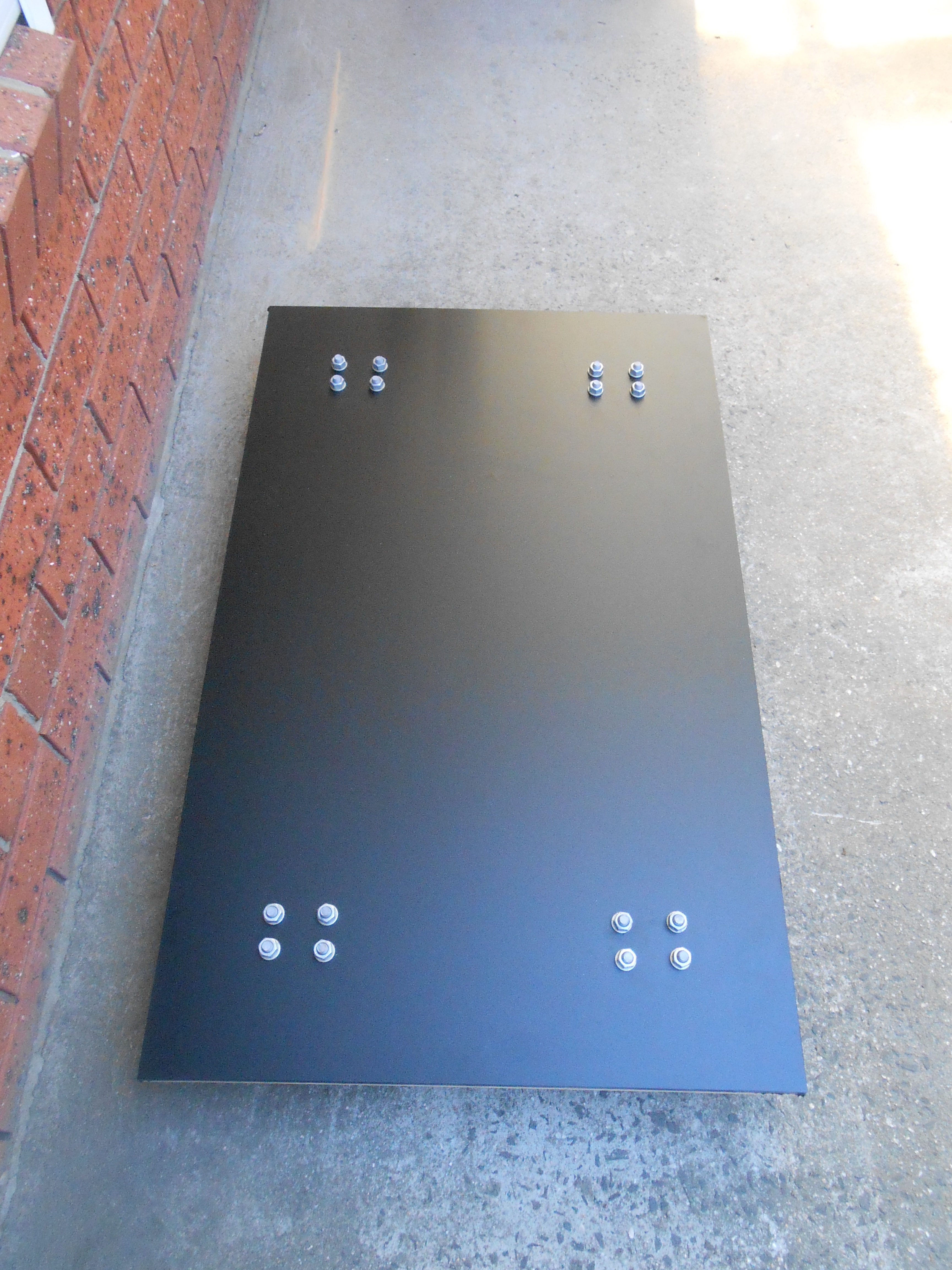

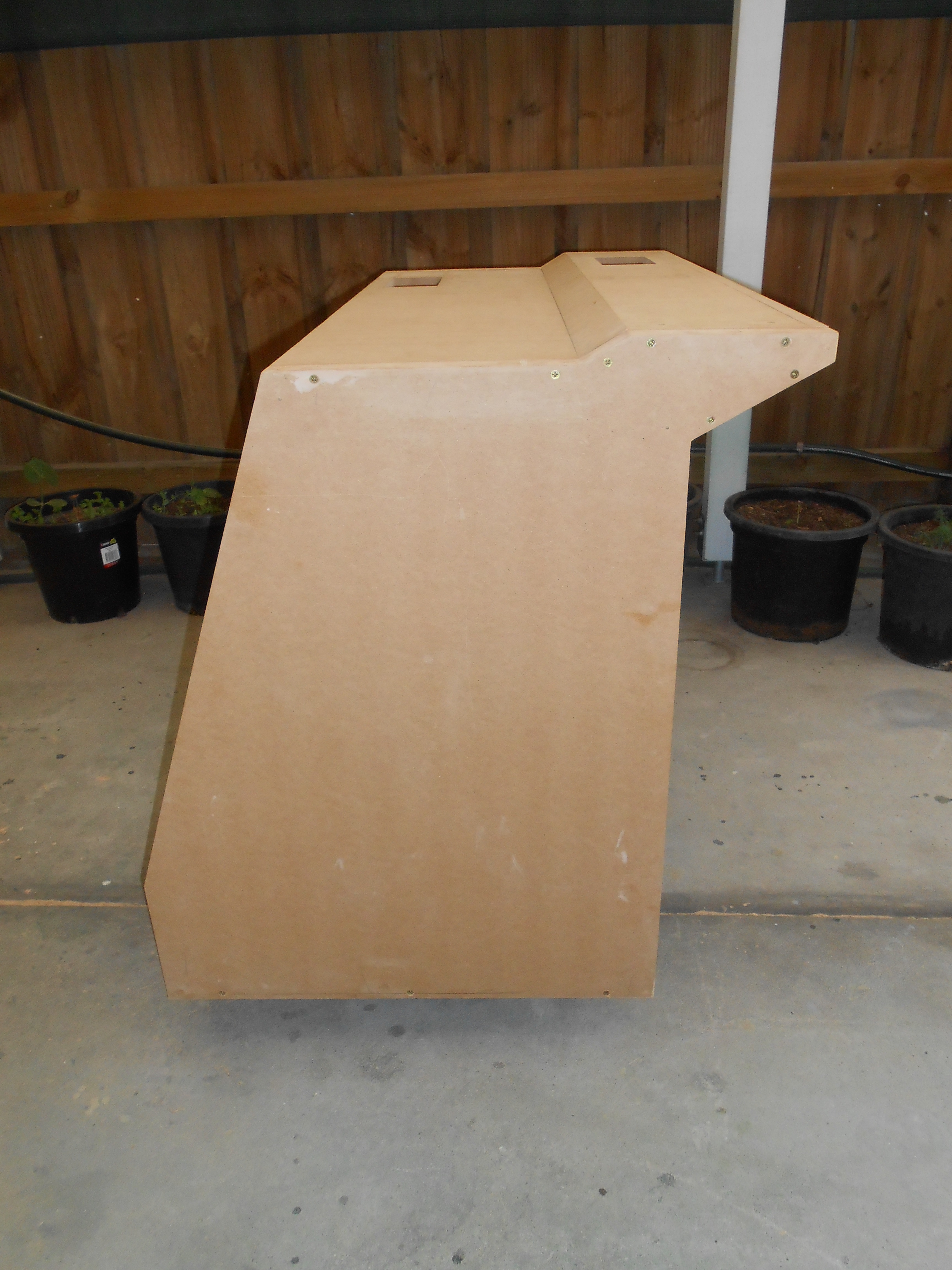

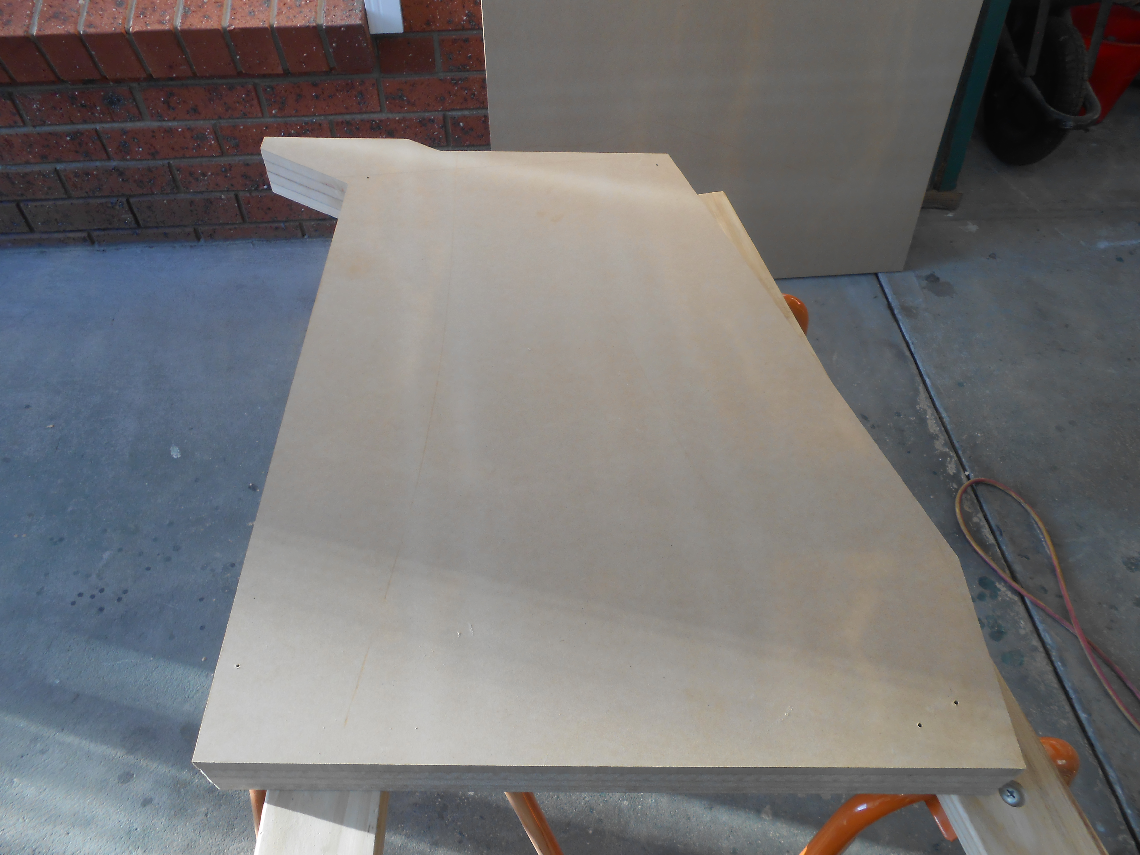

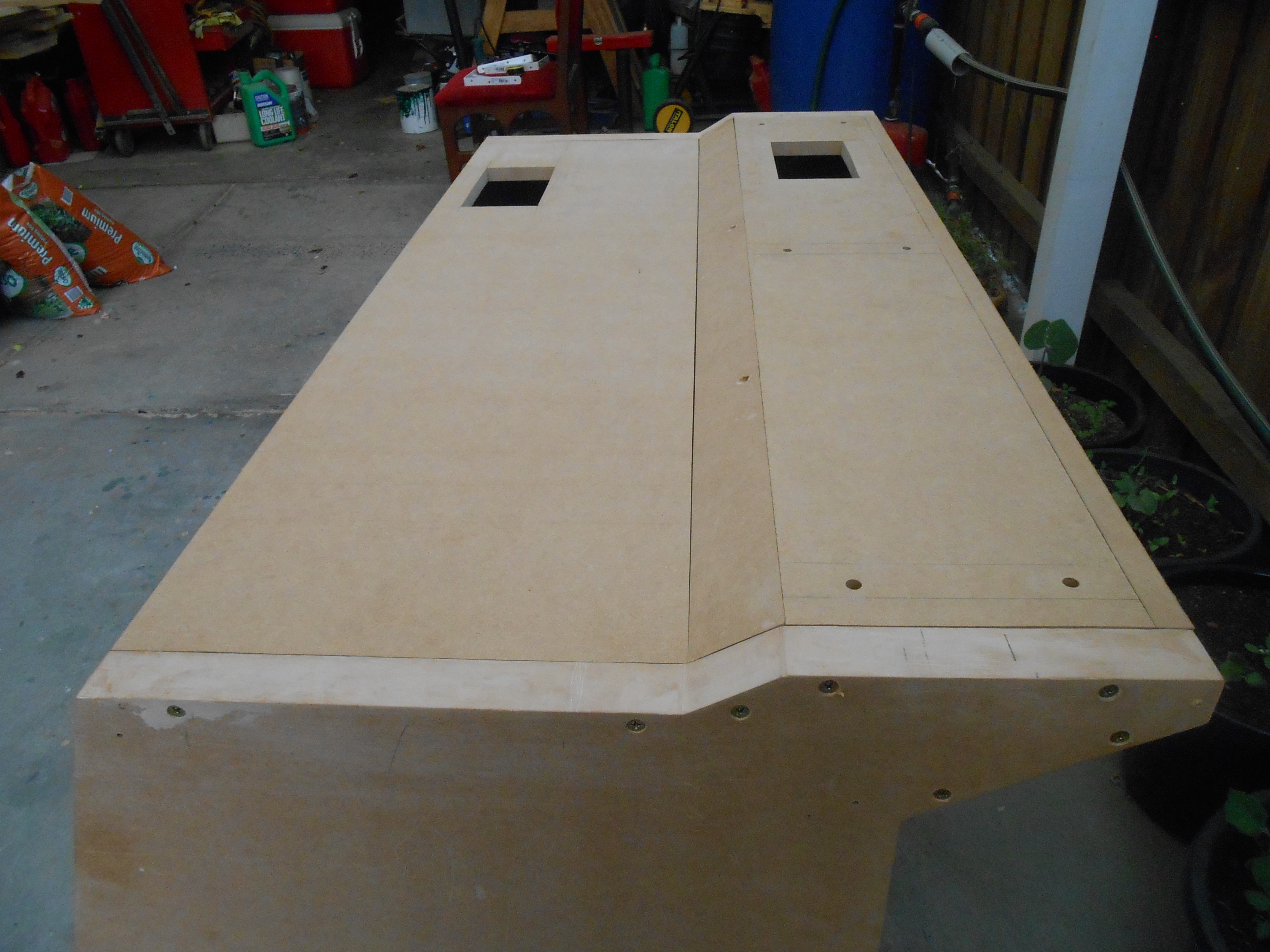

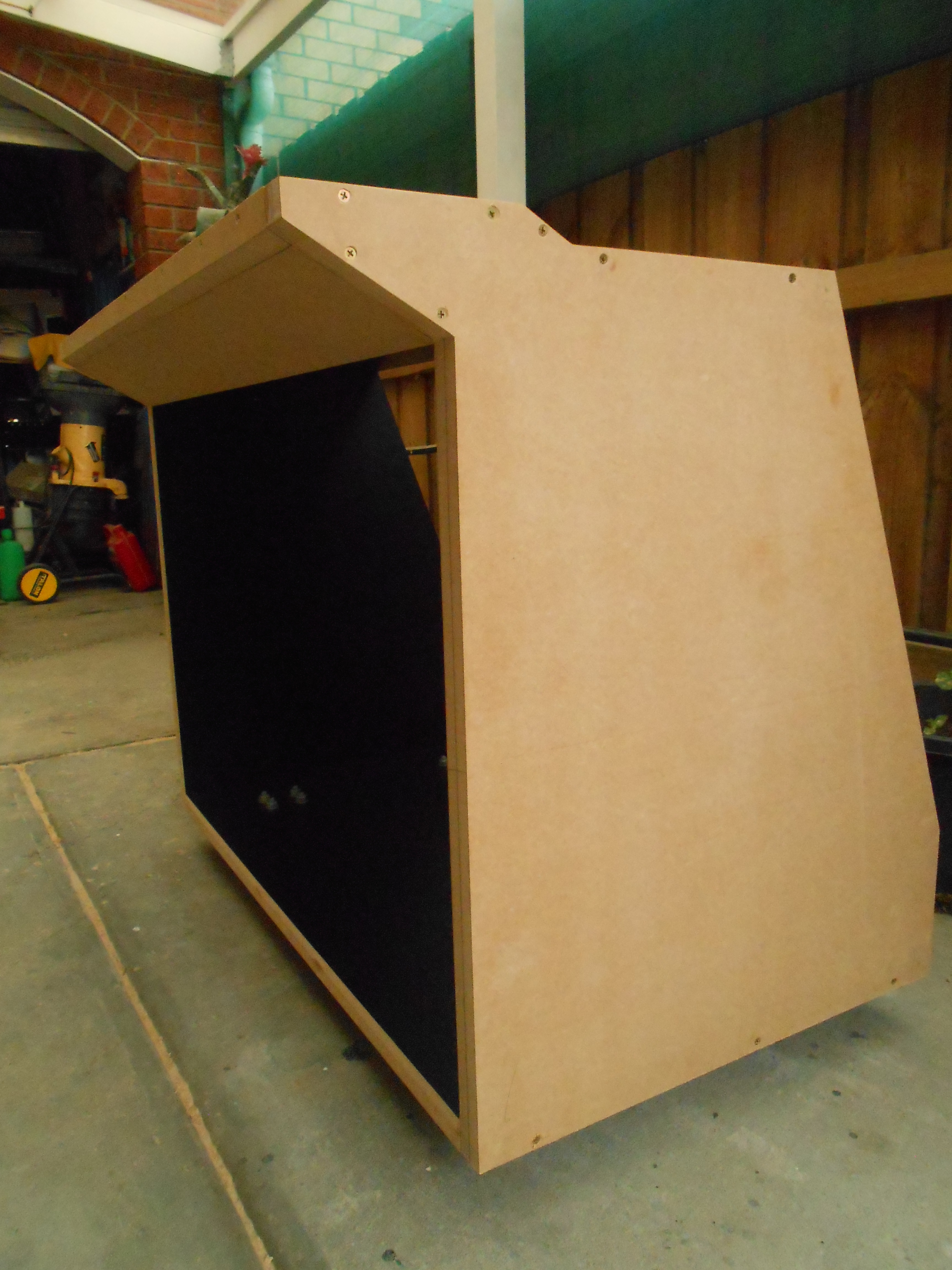

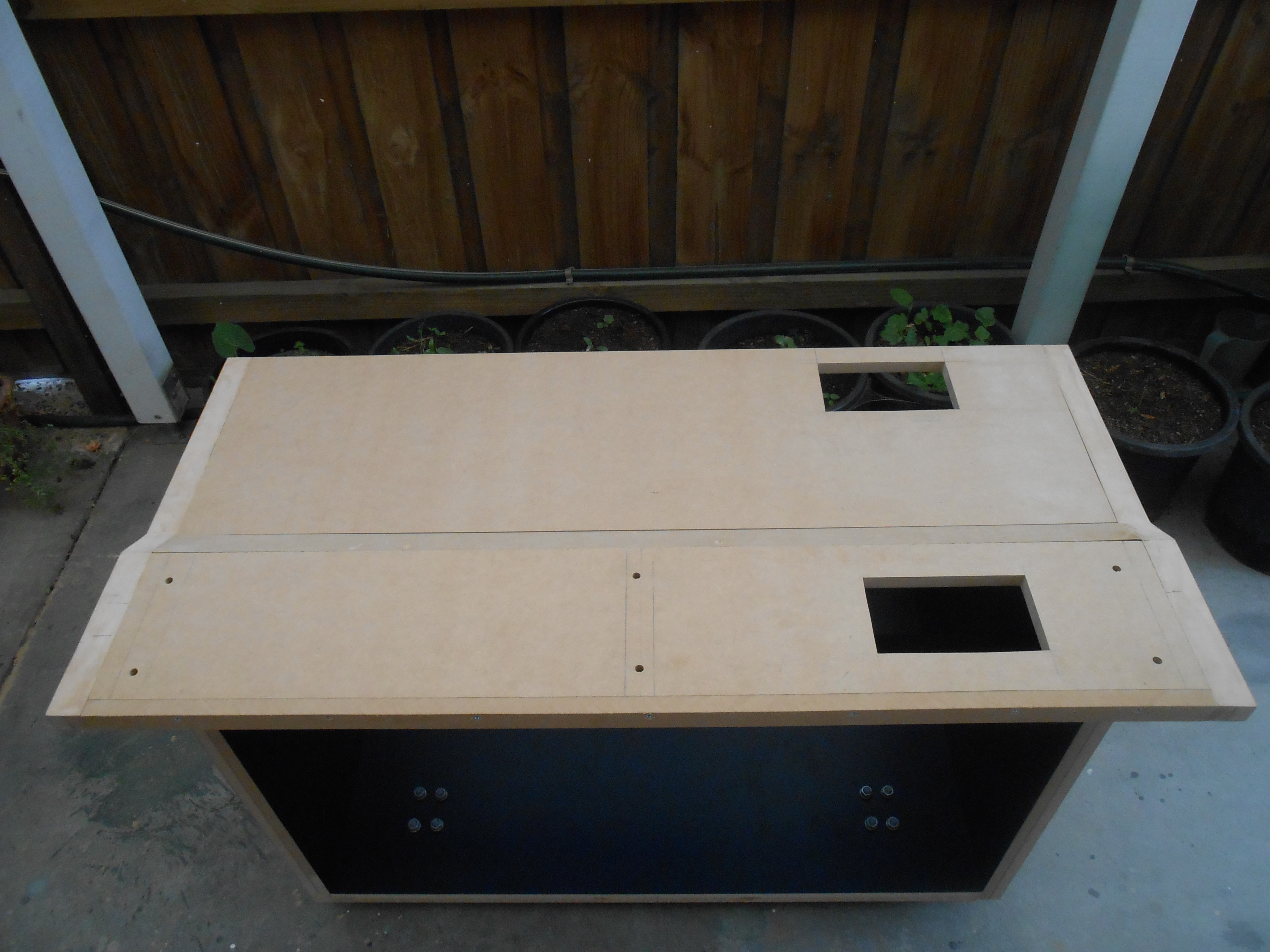

So I worked on the base this weekend and its about half complete now... Just got some touching up to do on the base then i'll connect the sides. Didn't realise how much work this would be :(

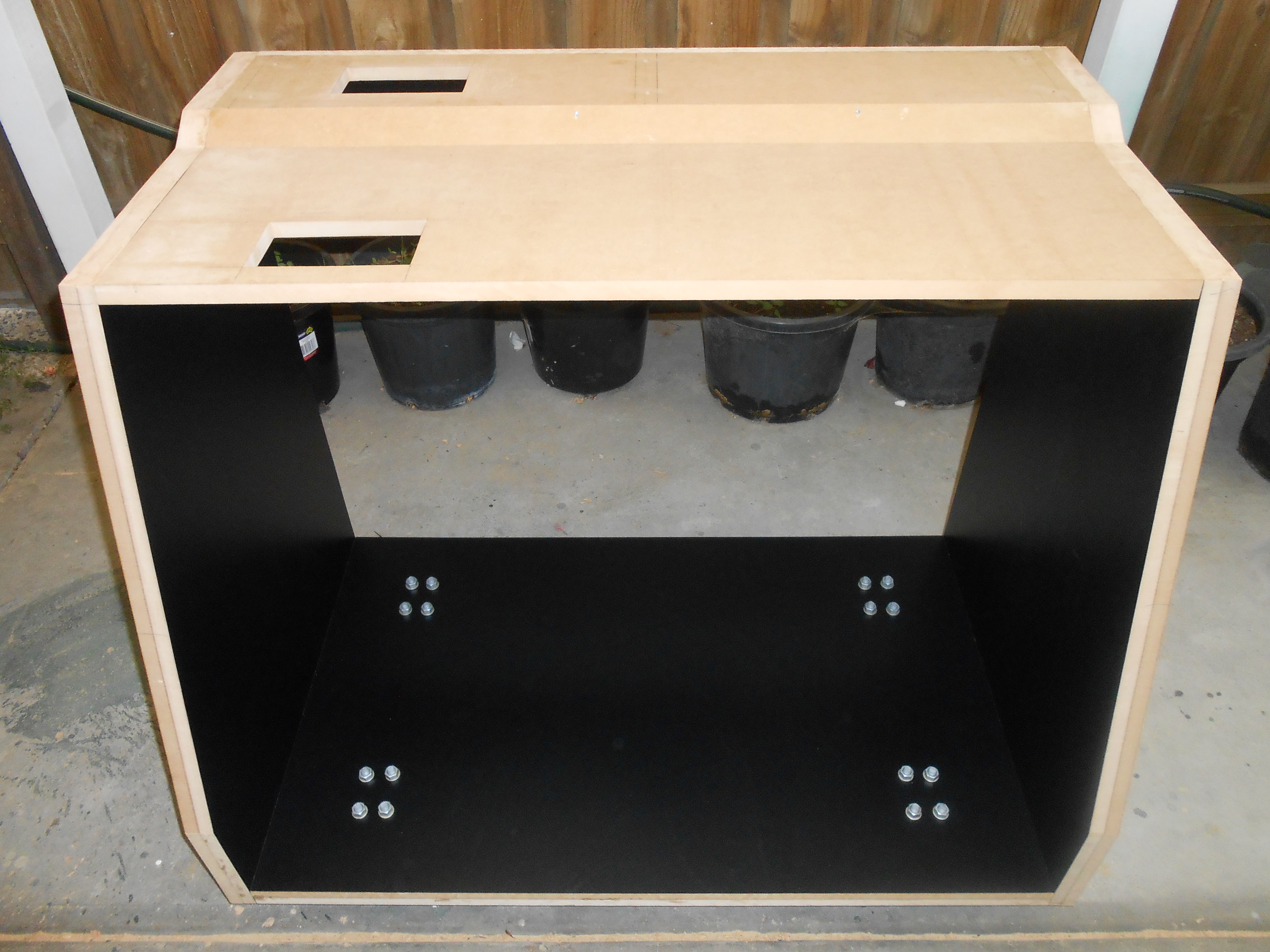

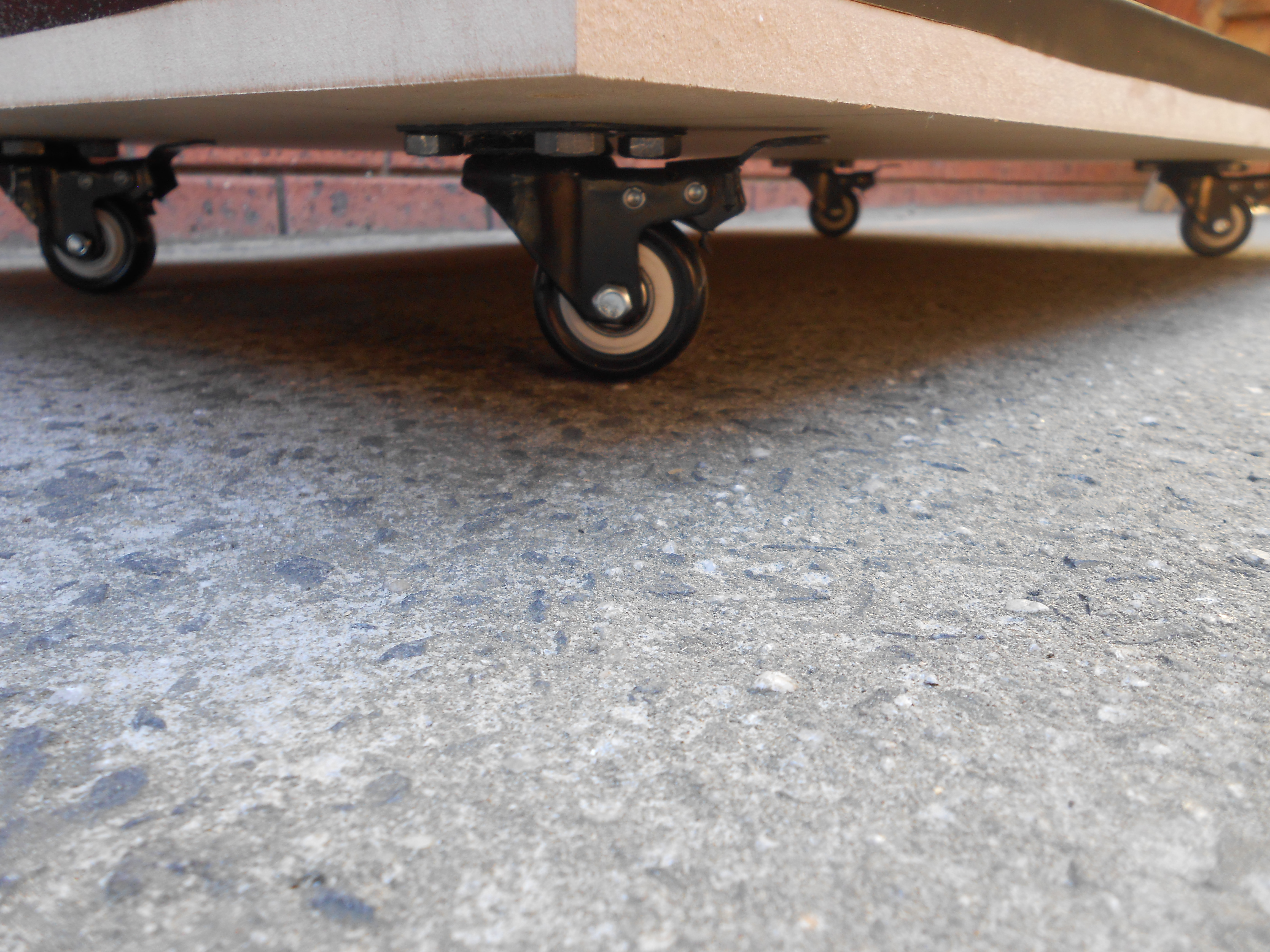

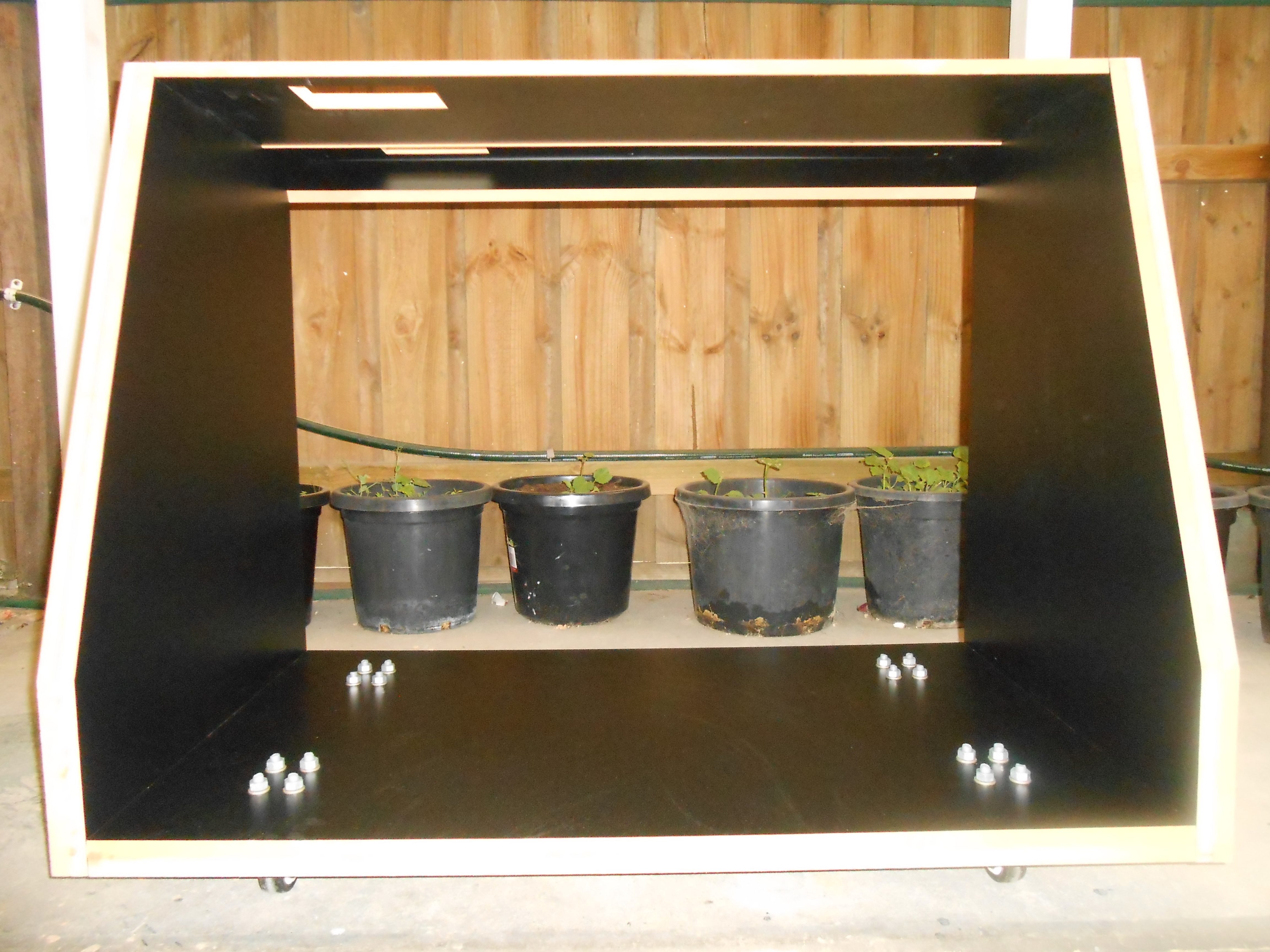

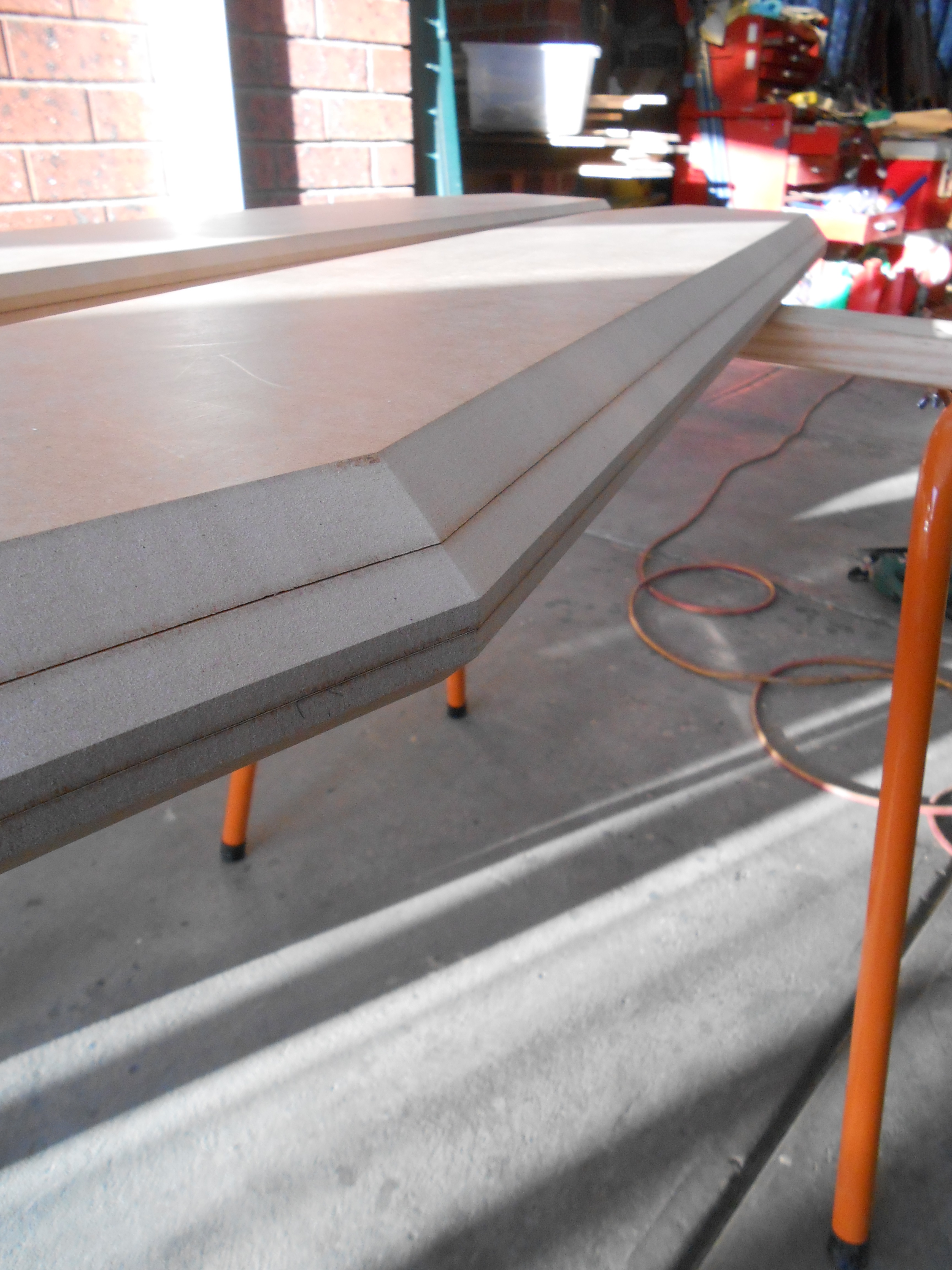

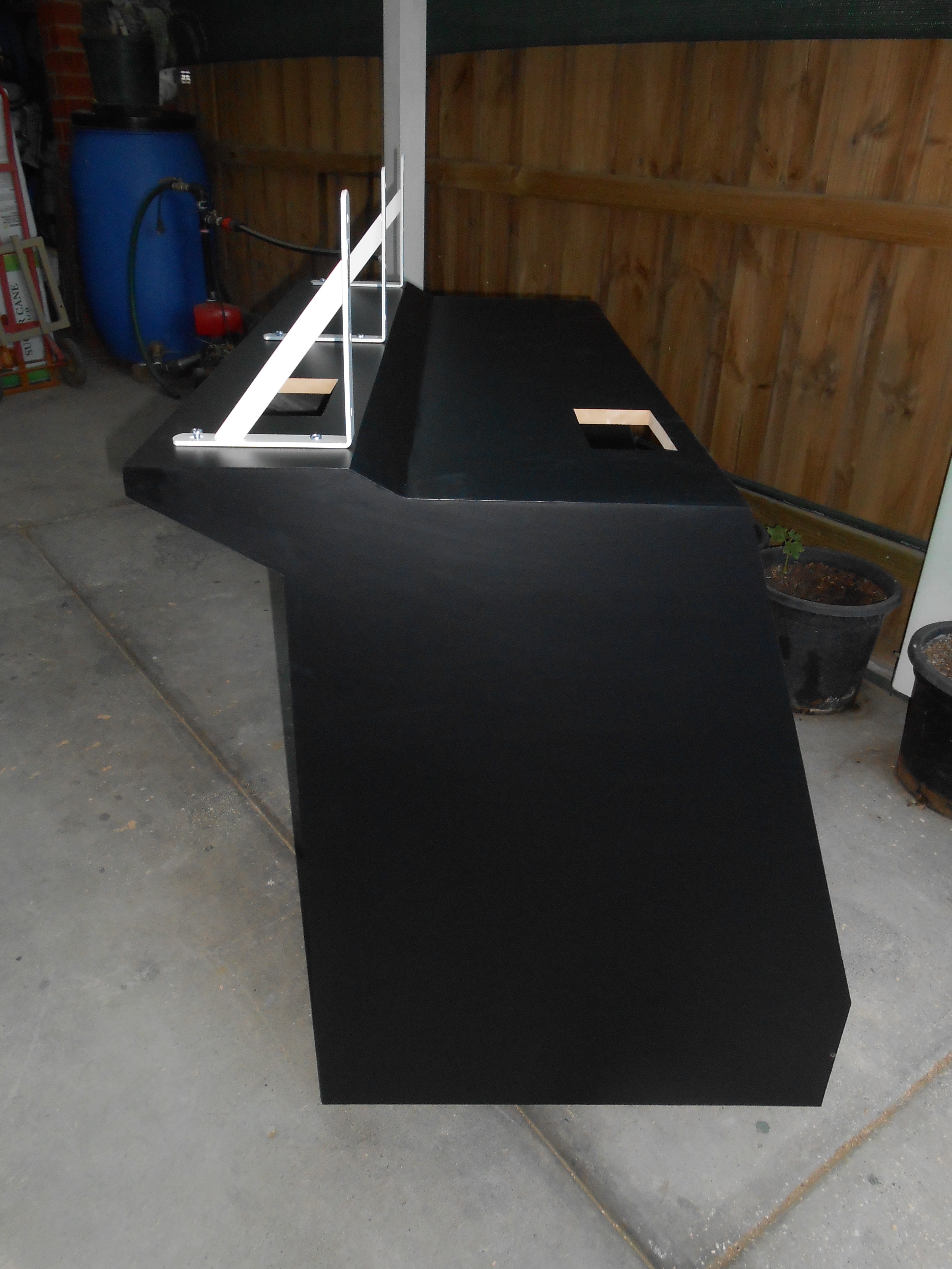

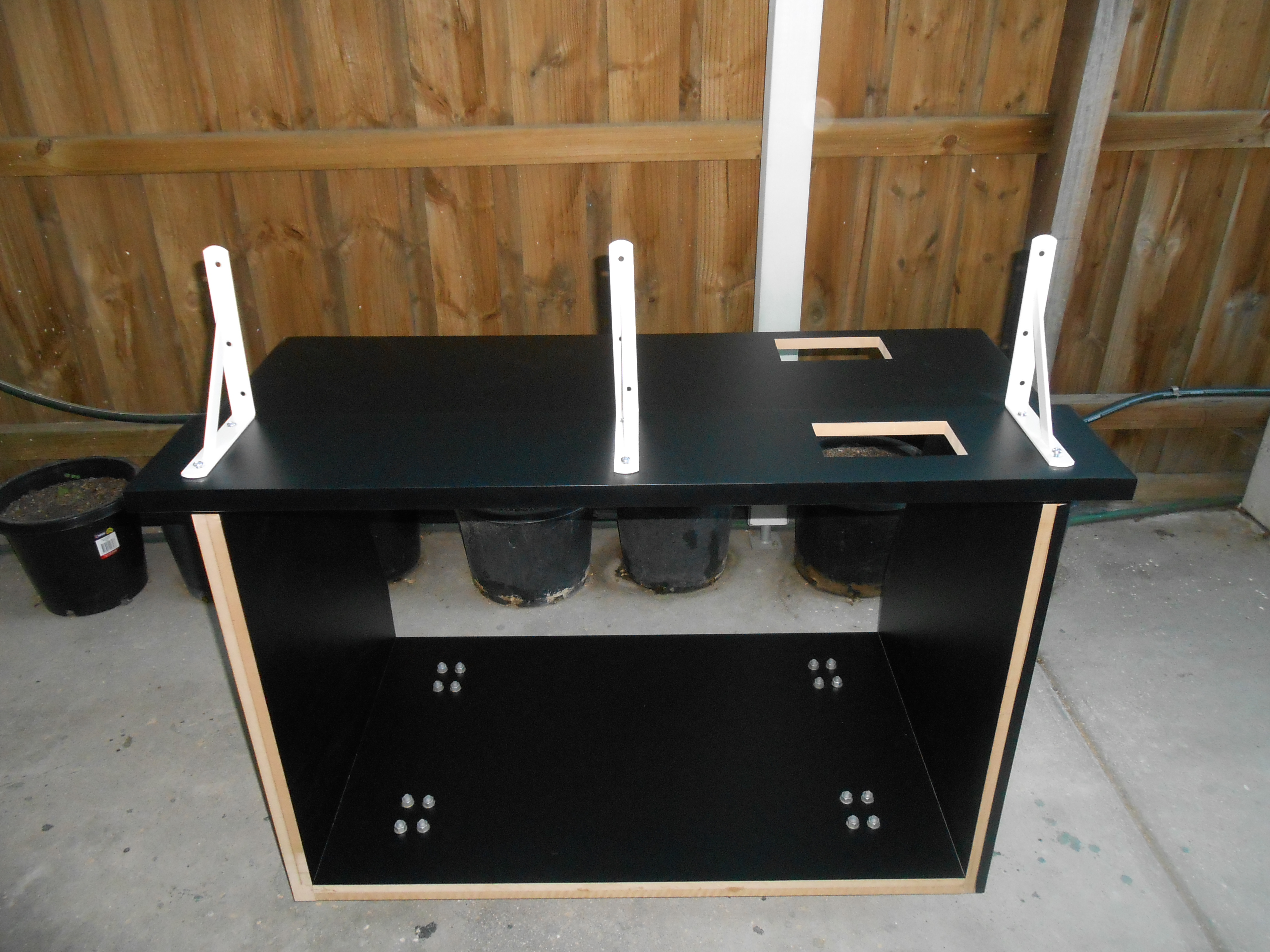

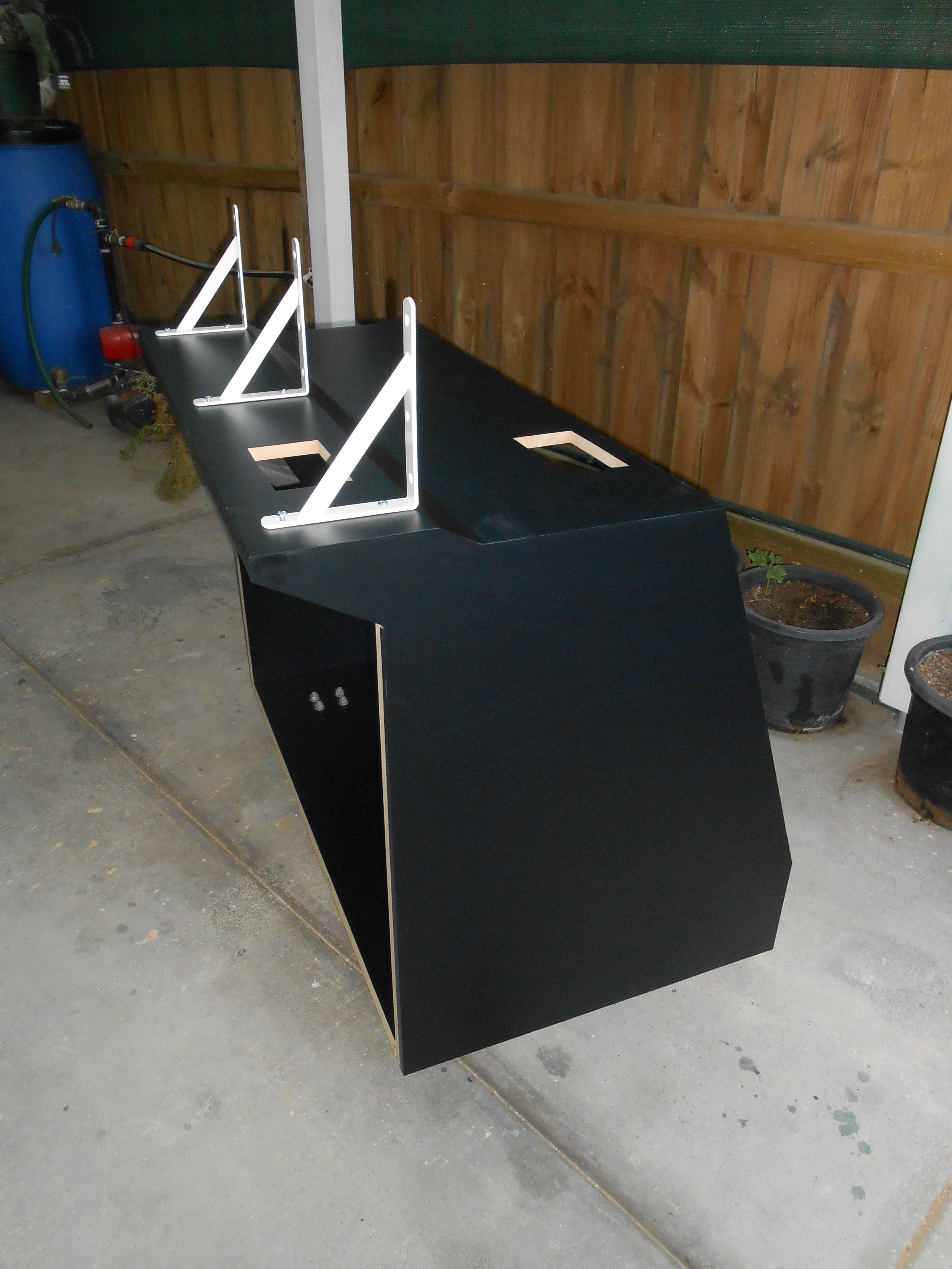

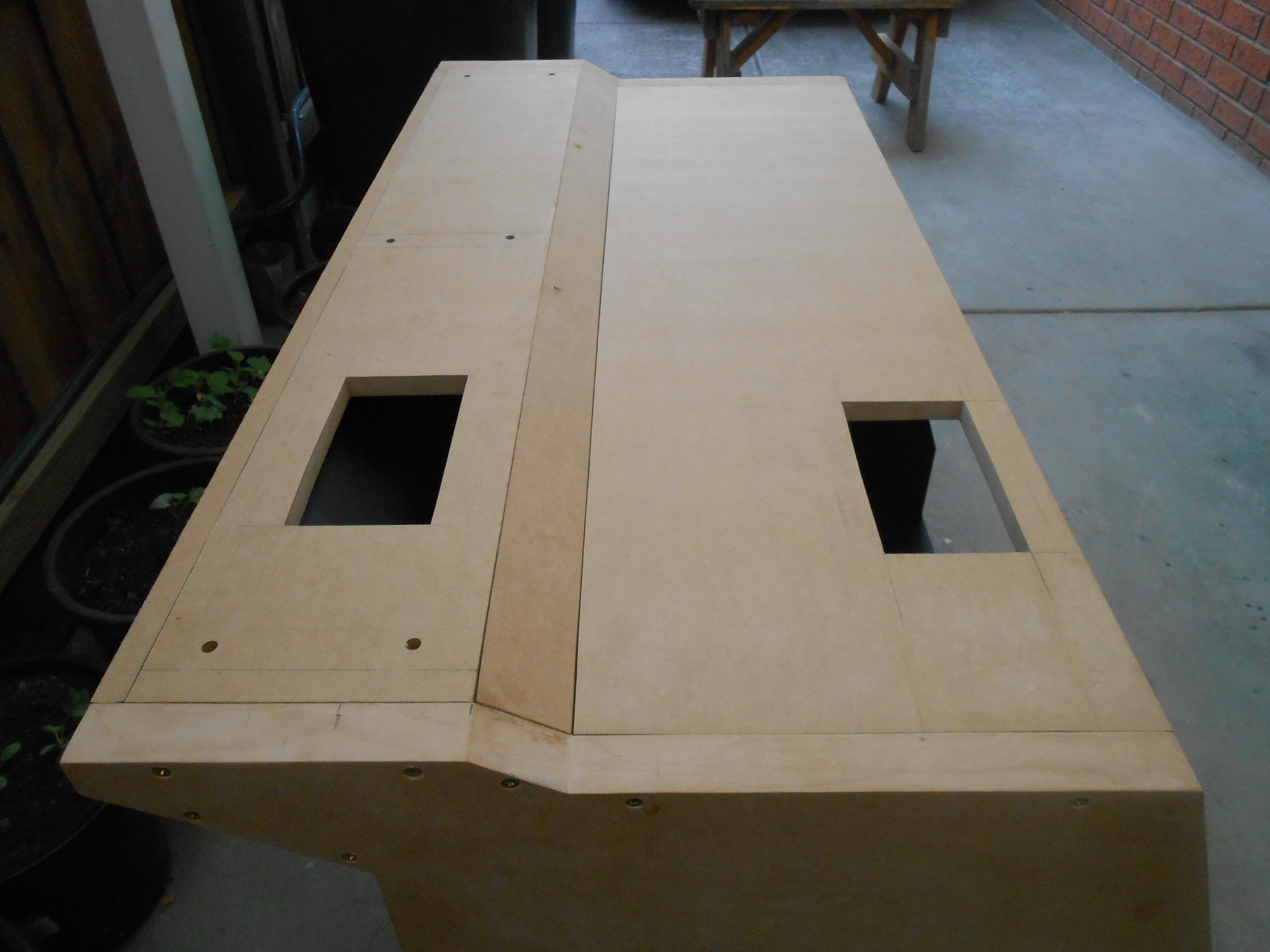

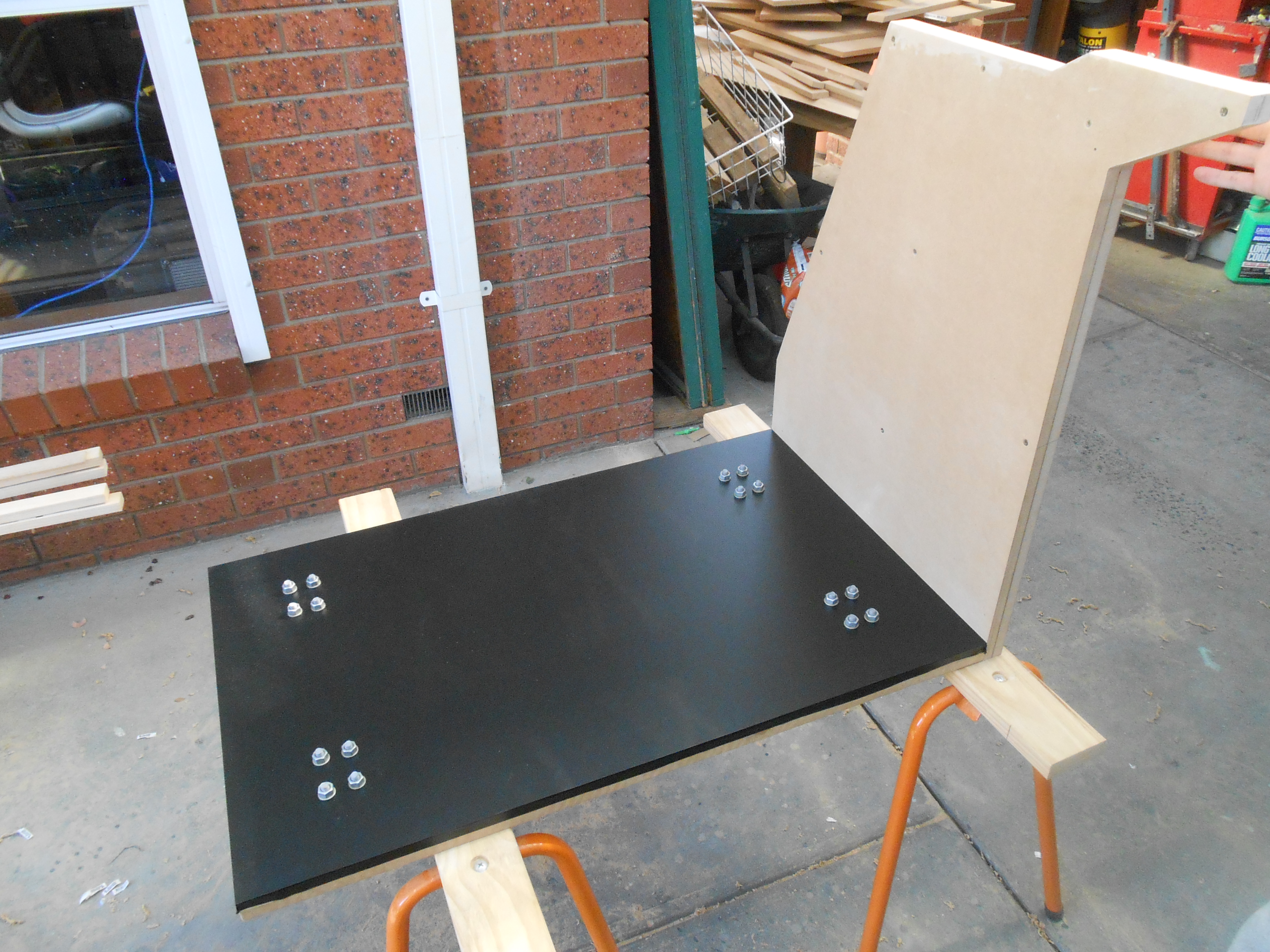

Been a bit busy the last 2 weeks so I haven't had any time for the cabinet :( but today I fixed up gaps, covered screw holes and added threaded inserts to the wood so the control panel can be screwed into it without constantly screwing into the MDF which will loosen the holes not good! Also I'll be using the white brackets so that I can face the control panel upwards so I can move this through my doors :D and traveling and finally I got the rest of the base covered with vinyl!
