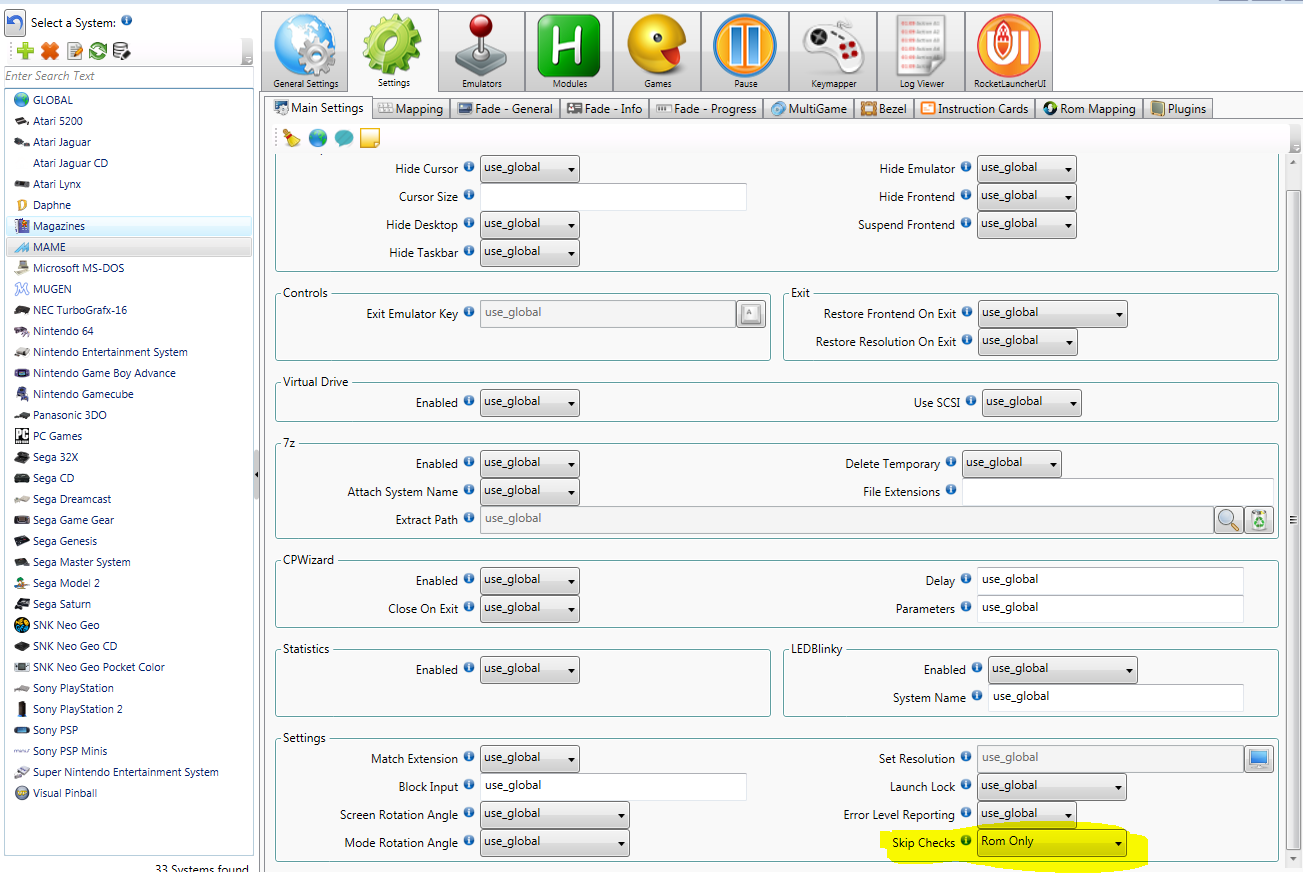

LarryLaffer75 Posted March 23, 2018 Author Posted March 23, 2018 Ok, Mame is now running well. So I want to add more Roms. I copy the roms in the mame Rom Folder, then I open RocketlauncherUI and Audit all games for mame and i get this. Why i cannot add games? What Did i wrong?
Spawk Posted March 23, 2018 Posted March 23, 2018 Judging by what's listed there, I would say you have a merged set (all clones are built into same archive with parent). All games should still work if you set "romchecks" to off in RLUI... they won't audit green though!
Spawk Posted March 23, 2018 Posted March 23, 2018 Heres the setting: If the red audit really bothers you, you can always get a split set.
LarryLaffer75 Posted March 23, 2018 Author Posted March 23, 2018 understand, give me a hint where i can turn it off?
