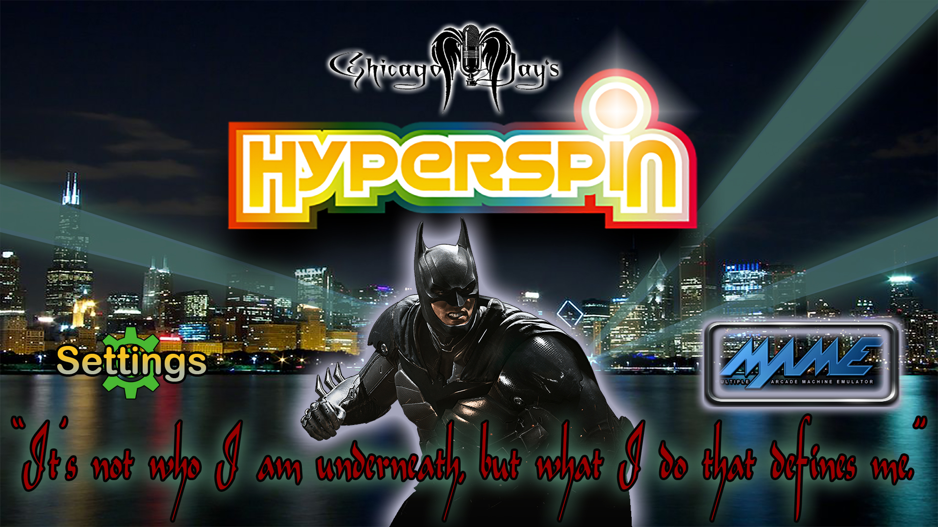

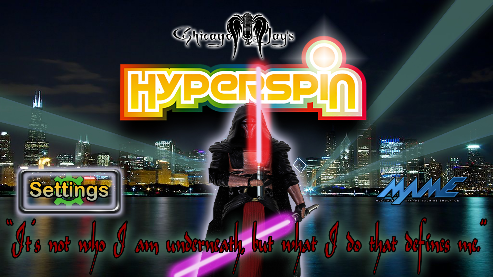

chicagojay Posted April 2, 2018 Author Posted April 2, 2018 Thanks guys.... Much appreciated..... For those who commented on this page, I wanted to give a visual of what I was trying to do.... I know some of you have seen it, and maybe some of you have not......But I did change it, with the tab menus.... but the background will be animated. It will morph into different characters. These two examples are what the morphing characters I have.... Once this is done, and you guys like the setup..... I will have this to download. I must admit, I tackled one hell of a project on this. I can see why people get carried away with customizing their own... I was involved about a year ago with this and kind of fell off for a while..... I run a pet sitting business, that keeps me quite busy.... Believe me, I am not one to complain about success, I am greatful that it has done well..... It does leave me at times, very busy.... It's slowed down some and I am very glad you guys are helping me.... I am going to look into the suggestions you guys made.... Thank you!
