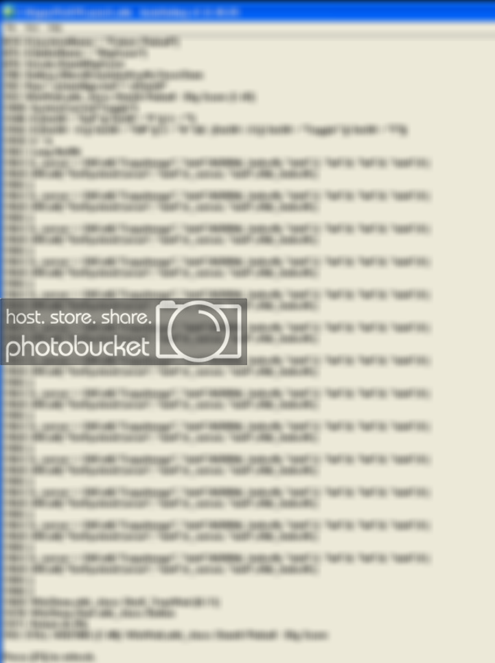

bent98 Posted November 14, 2011 Share Posted November 14, 2011 (edited) yup, no pause menu, it was confusing - no text what to press and how to exitnow pause is exit menu, you have text on menus and you know how to exit and how to return to game as for slamit pinball - it works for me double click fplaunch.ahk and run bigscore from there then press t to show taskbar and check ahk log in system tray When I run Slamit from FPlaunck.ahk i browse to Future Pinball and then Biscore. I run it and PF turns black. I Hit t and the have to run it again for the screen to clear up. I could not copy and paste the log file so I print screened it. I have my Bigscore in a folder off my c drive called slamit. I have a bat file which is named go.bat and inside bat file it points to bigscore.exe. IF I launch go.bat in windows it runs bigscore fine. Second question: How do I access pause menu graphic? If i escape it gives me that count down screen. Edited November 14, 2011 by bent98 Link to comment Share on other sites More sharing options...
blur Posted November 14, 2011 Share Posted November 14, 2011 you are launching go.bat from ..\slamit\go.bat where is your hyperpin? if your slamit is in c:\slamit then hyperpin should be in c:\hyperpin and go.bat should be in slamit folder Link to comment Share on other sites More sharing options...
bent98 Posted November 14, 2011 Share Posted November 14, 2011 it is. C:\hyperpin hyperpin.exe is in there c:\slamit\ go.bat and bigscore.exe are in there Link to comment Share on other sites More sharing options...
