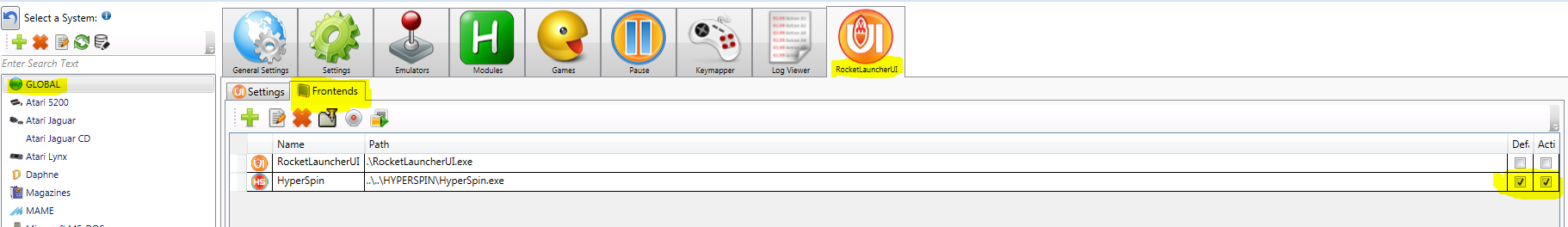

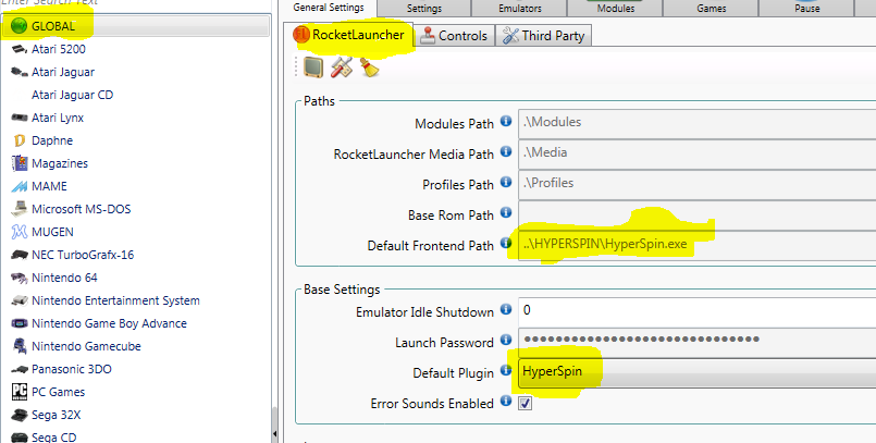

Spawk Posted August 11, 2018 Posted August 11, 2018 Hmmm... did you follow a tutorial to set up RL? Sounds like you don't have HS set as active and default profile... and/or set as default frontend path and default plugin.Both of these sets of options can be found in RL.Sent from my SM-A520W using Tapatalk

toto1974 Posted August 11, 2018 Author Posted August 11, 2018 it was set to ..... rocketlauncherui changed like in the screenshot and still same problem

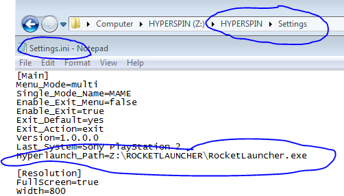

toto1974 Posted August 11, 2018 Author Posted August 11, 2018 so i tried using this guide and the pcs below show his setting - my setting - my error dont know how i should set this up to launch different - using rocketlauncher and hyperspin hq 06:14:36 PM | HyperSpin Started 06:14:36 PM | Going FullScreen 06:14:36 PM | Checking for updates 06:14:36 PM | Update Check Complete 06:14:36 PM | Startup program unavailable 06:14:36 PM | Error intializing joysticks 06:14:36 PM | Menu Mode is multi 06:14:36 PM | Loading Main Menu.xml 06:14:36 PM | Main Menu.xml successfully loaded 06:14:37 PM | Main Menu wheel loaded successfully 06:14:38 PM | Loading Daphne.xml 06:14:38 PM | Main Menu.xml successfully loaded 06:14:39 PM | Daphne wheel loaded successfully 06:14:40 PM | Launching Game 06:14:40 PM | Using HyperLaunch 06:14:40 PM | Getting HyperLaunch path 06:14:40 PM | HyperLaunch located at G:\Hyperspin\RocketLauncher\hyperlaunch-3\HyperLaunch.exe 06:14:40 PM | Running HyperLaunch.exe 06:14:40 PM | HyperLaunch Command Line is: G:\Hyperspin\RocketLauncher\hyperlaunch-3\HyperLaunch.exe "Daphne" "astron" 06:14:47 PM | Loading Main Menu.xml 06:14:47 PM | Main Menu.xml successfully loaded 06:14:48 PM | Main Menu wheel loaded successfully 06:14:49 PM | Exit program unavailable 06:14:49 PM | Quiting Hyperspin 06:14:49 PM | Bye!
gigapig Posted August 11, 2018 Posted August 11, 2018 Your Hyperspin log shows that you are using Hyperlaunch not RocketLauncher unless you renamed it. Open the settings.ini and change the path to your RocketLauncher install.

gigapig Posted August 11, 2018 Posted August 11, 2018 It is a confusing system with vid files, framefiles and command line crap. Spawk showed you in an earlier post where to change the ini file which is located in the settings folder. Did you get the games running in Daphne loader first? If you did you must close Daphne loader after as it stays active in your system tray. If the games run it should then be a matter of pointing RocketLauncher to the framefiles which are the ROMs in this case.
