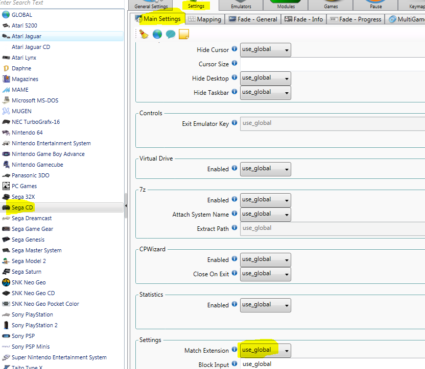

Spawk Posted August 26, 2018 Posted August 26, 2018 10:38:54:107 | MD | ERROR | +0 | ScriptError - Could not find "AH-3 Thunderstrike (USA)" inside the archive with any defined Rom Extensions. Check if you are missing the correct Rom Extension for this rom for Fusion's Extensions, enable Rom_Match_Extension, or correct the file name inside the archive. This tells me the .cue file is not named exactly "AH-3 Thunderstrike (USA)". You can either rename it to this or use "Rom_Match_Extension" like it suggests. You can find that setting here:
lopez888 Posted August 26, 2018 Author Posted August 26, 2018 Changed the settings>match extension> True + use_global = loads up and sends me to the CD Tray still False gives me could not find Rom extension ,enable Rom_Match_Extension
Spawk Posted August 26, 2018 Posted August 26, 2018 Ok if the file is not named exactly AH-3 Thunderstrike (USA).cue then leave it on "True" and new error log please.

lopez888 Posted August 26, 2018 Author Posted August 26, 2018 Thunderhawk folder has the files as : (Europe) (En,Fr,De,Us) unzipped everything from the Thunderstrike zip and renamed it exactly (AH-3 Thunderstrike (USA) matching the database (track 1-12 and the cue file ) , changed the setting back to original state, but still the same problem
