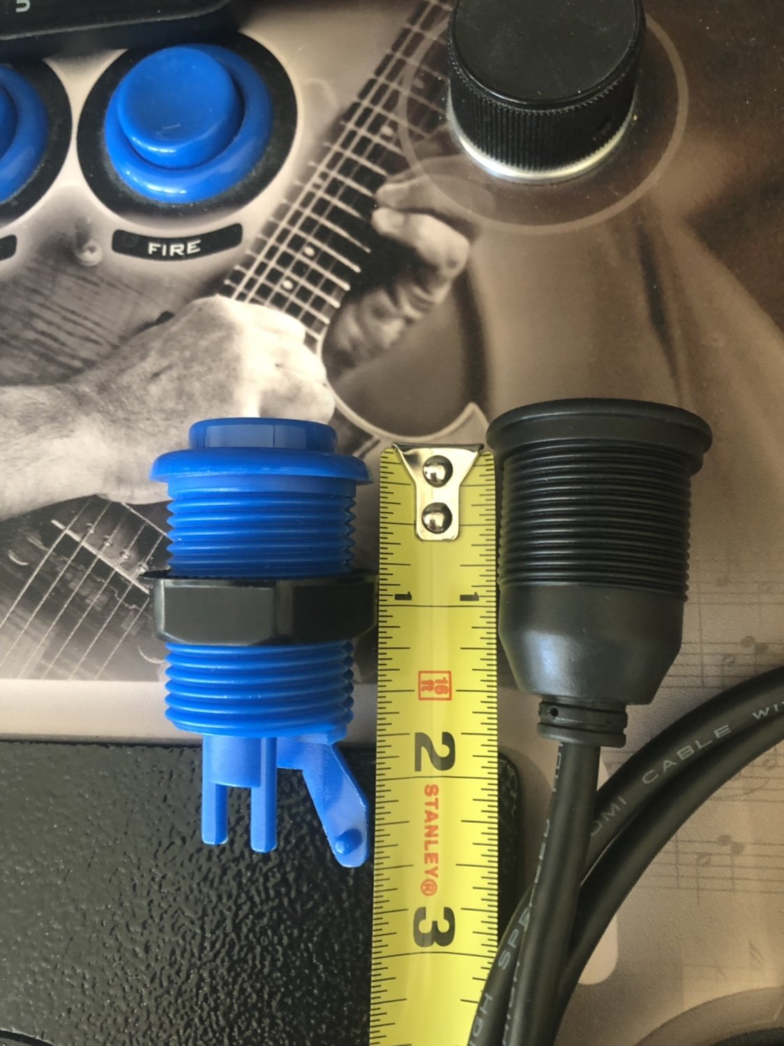

ninja2bceen Posted February 25, 2019 Posted February 25, 2019 So I have a panel that is 1 inch think and I hope to get the gold leaf led buttons from ultimarc. The problem is the buttons are like .75 long so there is no way for me to secure the buttons. I’ve already got a panel with buttons on it. What tool do I use and how do I make an impression so that I can screw on an arcade button nut when there is already a button hole here. I’m currently using happ standard buttons and they fit fine. I’m pretty sure the led buttons are as long as the black plug here which is also a tad too short Sent from my iPhone using Tapatalk Advance the cause to 100%. http://hyperbase.hyperspin-fe.com/ Planet Geekdom, Subscribe for Tutorials! https://www.youtube.com/channel/UCdcby-s2GwriaOHGmVC2vGA?sub_confirmation=1&app=desktop
Chillijason Posted February 25, 2019 Posted February 25, 2019 your best bet is to remove all the buttons and the panel, take it to a wood shop and have the underside of the panel recessed to reduce the thickness of the panel around the buttons. You could do it yourself with a router if you can get your hands on one. I did this to the underside of mine to suit the joysticks and trackball which needed less thickness to mount.

Chillijason Posted February 27, 2019 Posted February 27, 2019 no, i wouldnt worry about ruining the holes, it just takes material off the underside face, like the picture i attached, it just munches the face off down to a preset depth. For the led buttons you want about 19mm (3/4"). My deck is 19mm and they fit just fine. (other pic is underside of the deck of my 2player machine) .Any wood shop should be able to do it for you if you cant borrow one from someone.
