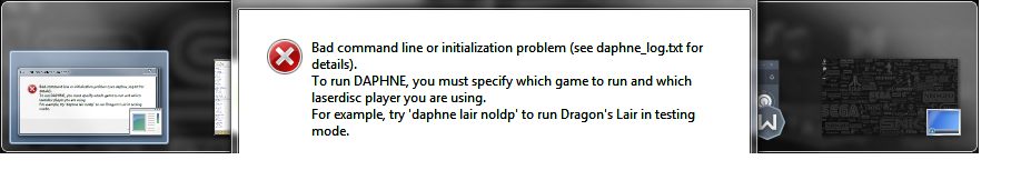

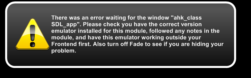

juicelee Posted February 28, 2019 Posted February 28, 2019 hi guys, the problem i have is , i had daphne and singe setup and working properly in my old hyperspin set up. the new setup i am working on has combine time gal ,ninja h,time traveler into the daphne xml. but i dont know how to set these up. i have the american laser games running fine and daphne running fine in rocket launcher and hyperspin, but cant get these other games working, can anyone help thanks( i think it looking for the singe emulator ) please help as i would like these working in the daphne wheel instead of american laserdisc, thanks guys

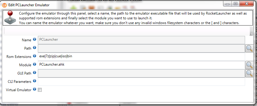

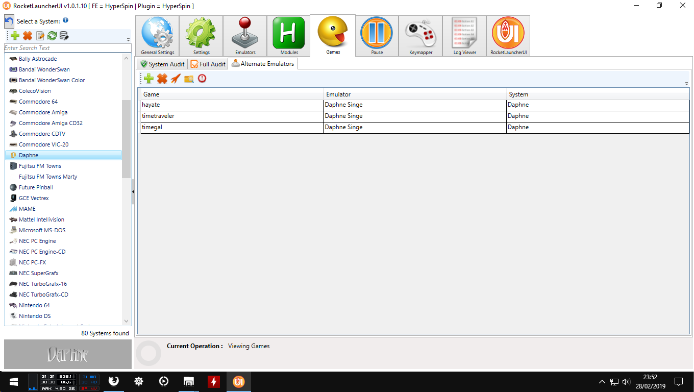

32assassin Posted February 28, 2019 Posted February 28, 2019 those 3 games need to be set up how you set up your american laser games or daphne singe the only thing you do in RL when you add the 3 games to your Daphne wheel is you need to set them in the ALt emulator I launch those games with a batch file, so I have them set up to launch with the PC games launcher, so set whatever you used
juicelee Posted February 28, 2019 Author Posted February 28, 2019 thanks for getting back to me super fast, those 3 games are in bat files. what do i fill out in pc launcher.
dark13 Posted February 28, 2019 Posted February 28, 2019 Do you have .singe files in your download? You can also use daphne singe to load those games instead of the .bat. I have the 3 games included in daphne's database mapped into daphne singe module. Automatizing infopanels creation from .csv files for HTPCs themes (look at infopanel tutorial.zip on the ftp in dark13 folder) PNGs to SWFs automatized flash scripts Hyperspin Wheelset automatized template (photoshop's variables + batch) Aeon nox 4.13 W.I.P. hyperspin skin
juicelee Posted March 1, 2019 Author Posted March 1, 2019 thanks alot guys that sorted the problem ,i followed your path dark13. i really want to make a laser disc wheel so if i wanted to add firefox and qube quest to this list do i follow the same path ,but use mame for emulator and add games to the xml file. thanks
