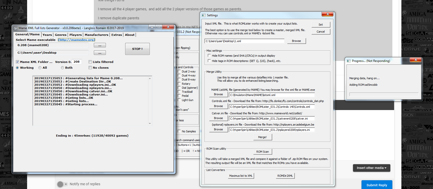

SpatzST Posted March 27, 2019 Author Posted March 27, 2019 4 minutes ago, thatman84 said: Drop your mame.xml in this thread i can test it. What filters you using? I don't get that far. When you open filterlist it asks you to locate your mame.xml, then in the second box it says link to mamelist.xml where you can browse to one or press the "Generate" button. Clicking the generate button opens up a cmd prompt that sifts through thousands of lines... is that generating through mame64.exe or my mame.xml? I made my mame.xml with r0man0s xml generator. I will attach it in another post, give me a few minutes... I need to remote in. Anyhow, I never actually get to the part where I press "Scan" at the bottom since it never creates a mamelist.xml that I can use.

SpatzST Posted March 27, 2019 Author Posted March 27, 2019 Thanks. I actually have nplayers and catver for .207. When you boot up r0man0s "mame xml list generator" it automatically downloads these files... are they truly .207? I'm not sure, but inside the ini file it does say mame version .207 so I'd believe they are. Controls.xml i'd have to find. But you're saying with RomLister I could use this data to generate a proper mamelist?

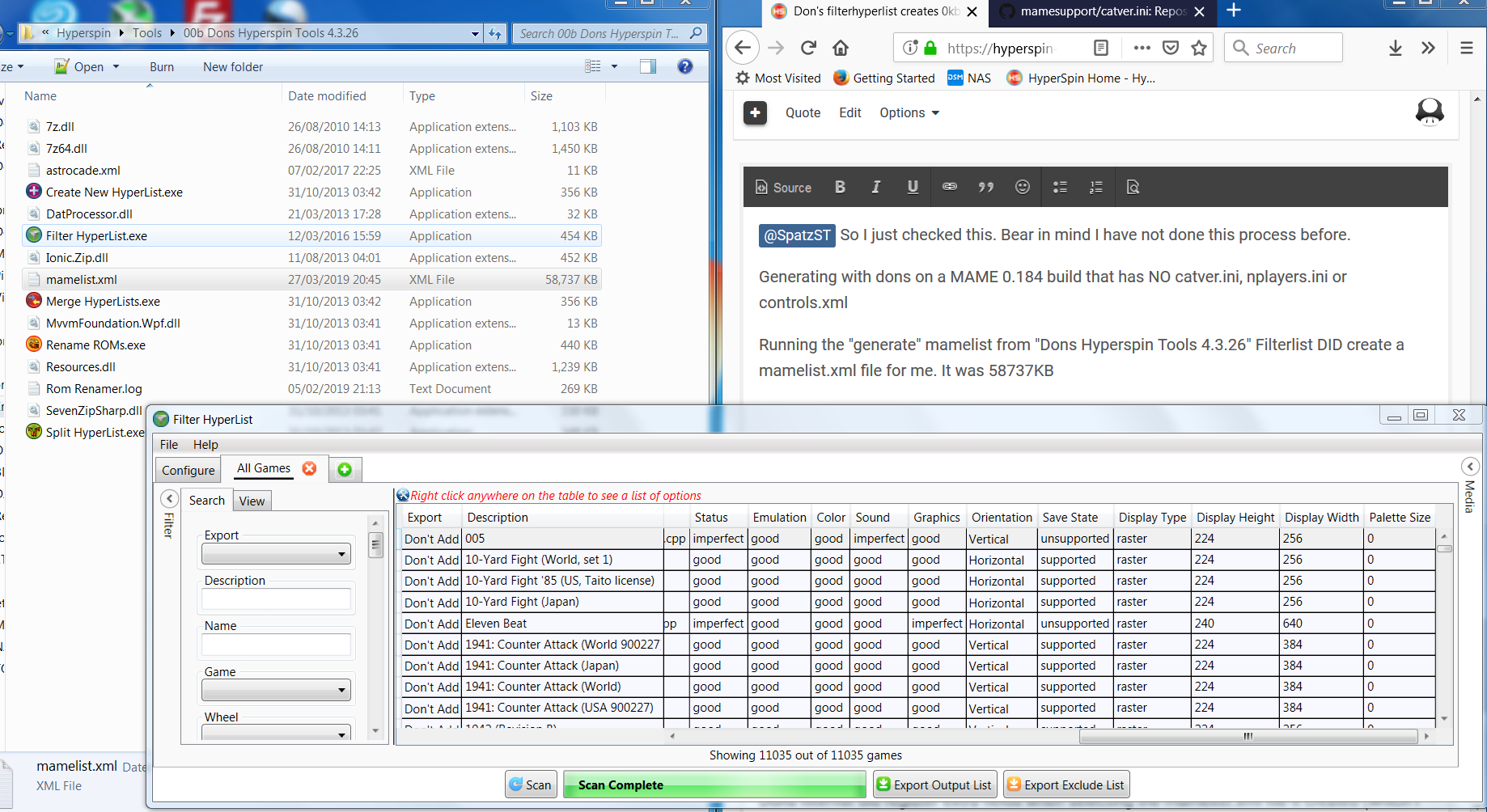

thatman84 Posted March 27, 2019 Posted March 27, 2019 @SpatzST So I just checked this. Bear in mind I have not done this process before. Generating with dons on a MAME 0.184 build that has NO catver.ini, nplayers.ini or controls.xml Running the "generate" mamelist from "Dons Hyperspin Tools 4.3.26" Filterlist DID create a mamelist.xml file for me. It was 58737KB I tried the same process on a clean MAME 0.195 emulator I had on my PC with the command line. Produced a much bigger file (212254KB) I used "Shift+right click" in the mame emulator director to "Open command window here" Typed "mame64 -listxml > mamelist.xml" This produced a file in a few mins. Using refresh I could see when it was completed as cmd did not show any activity!. Maybe the supporting files 32assassin mentioned add more information idk Maybe try generating the mamelist xml from command line and pointing FilterList to it. Also check you have the last release of Dons Tools. The picture above shows the Viersion ending .26 in my folder path. Good luck Hyperspin 2.0 Latest Download Hyperspin 2.0 Documentation -------Pre Hyperspin 2.0 Below---------- HS Android Overview & Install HS Android Base Pack Download My Tutorials

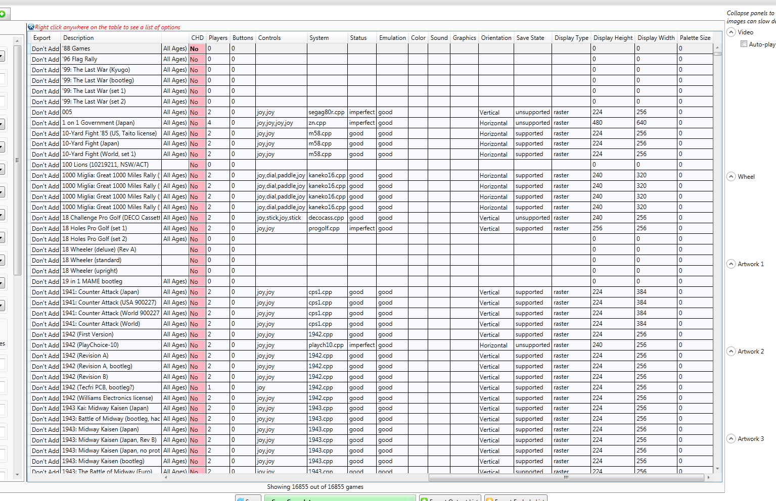

32assassin Posted March 27, 2019 Posted March 27, 2019 well all I can say is have fun you are going to need it as I stated the only thing the MAMEList.XML does is add extra info to the generated list info such as type of controls, number of players, monitor type you will have to manually add and remove each game you don't want from the list. easy task but you will have to do this every time you updated your MAME XML pic of generated list with all the extra info using MAMElist.xml
