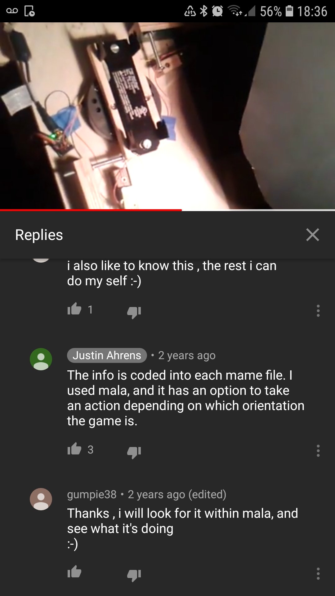

Youngjedi2001 Posted April 9, 2019 Author Posted April 9, 2019 THere is a video i saw once of someone going from a capcom fighting game to ms. Pacman. The trigger seems to happen before the Mame load of the game. Somewhere between "leaving the Hyperspin and entering the Mame. I found the Video. I am not sure what front end is used. The rotation happens at a point where the Front end says "Get Ready To Play". None of the comments in that vieo explain how he is putting the code in. I understand the code and what will be needed, just not sure where it will go in the setup. I plan on using a Raspbery Pi, but that might change.
thatman84 Posted April 9, 2019 Posted April 9, 2019 Seems he replied to a comment with this info. Its an action in the mala frontend Hyperspin 2.0 Latest Download Hyperspin 2.0 Documentation -------Pre Hyperspin 2.0 Below---------- HS Android Overview & Install HS Android Base Pack Download My Tutorials
