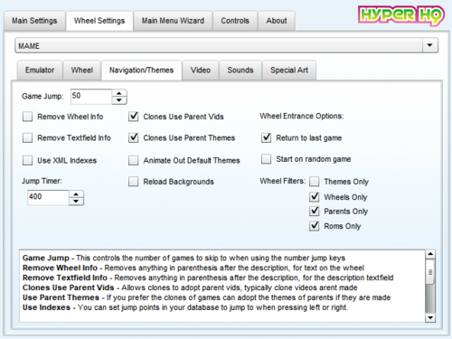

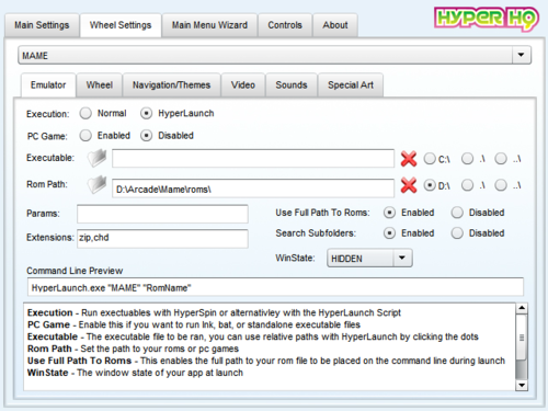

1: Have you set Hyperspin.exe to run as admin ?
2: Set RocketLauncherUI.exe as admin
3: See images below for settings in HyperHQ
2020-03-17_14-49-31.thumb.png.21bd92af46451935c98e5e34e099149d.png2020-03-17_14-49-13.thumb.png.d836141e5b10e48c21c232e7feede3f1.png

That did it. First it kicked me out like before, but then I chose Roms only and unticked wheels and parents and heureka! It works. Thank you so much!
