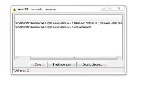

djreddog Posted March 28, 2020 Author Posted March 28, 2020 OK I got MAME and NES working ok. I tried to setup Amiga but failed, I'll come back to that later. My next step in this rebuild process was to download and run HyperSync, but no luck. Are there issues with HyperSync? First issue is when I extract it, I got an error "unknown method in HyperSync Cloud.exe. I tried to ignore the error and launched the Cloud.exe and I get Cloud.exe is not a valid win32 application. Any help appreciated.
gigapig Posted March 28, 2020 Posted March 28, 2020 Get the latest Hypersync from here. It must be installed into an empty folder.
djreddog Posted March 28, 2020 Author Posted March 28, 2020 That's the version I've been trying to install. Empty folder, but when I extract it errors out. I've tried it on multiple computers too.
gigapig Posted March 28, 2020 Posted March 28, 2020 I have tested myself and it's fine. You either need to try a different browser or Windows Defender is quarantining it so add it as an exception.
djreddog Posted March 28, 2020 Author Posted March 28, 2020 Just disabled Defender. Tried to download it from Chrome, Firefox, and IE, all same results when extracting.
djreddog Posted March 28, 2020 Author Posted March 28, 2020 Looks like the issues was related to WinRAR somehow. I installed 7zip and we are back in business. Thanks!
