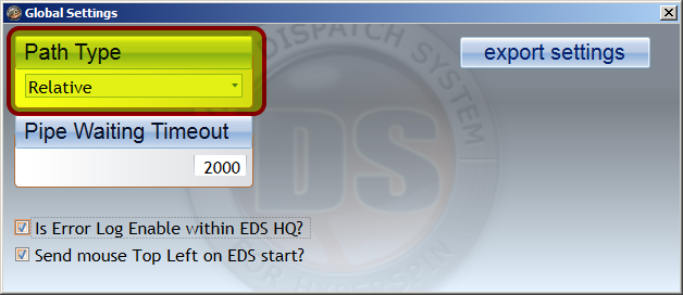

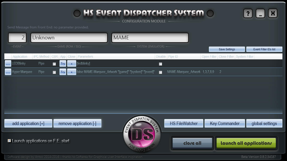

schmucm Posted January 28, 2021 Posted January 28, 2021 I attached my HS and EDS log as well to see if there are any similarities. My time is also off on the EDS log which makes it a challenge. I noticed mine is calling Event 4 (even though I never selected game) and yours doesn't seem to have that. What setting did you change to make your path relative instead of absolute? I can try that on mine and see if it also fixes it. In my case, I can't set CLI to pipe because when EDS crashes, it doesn't bring the programs back up when it restarts. log (2).txt Event Log - EDS (2).txt

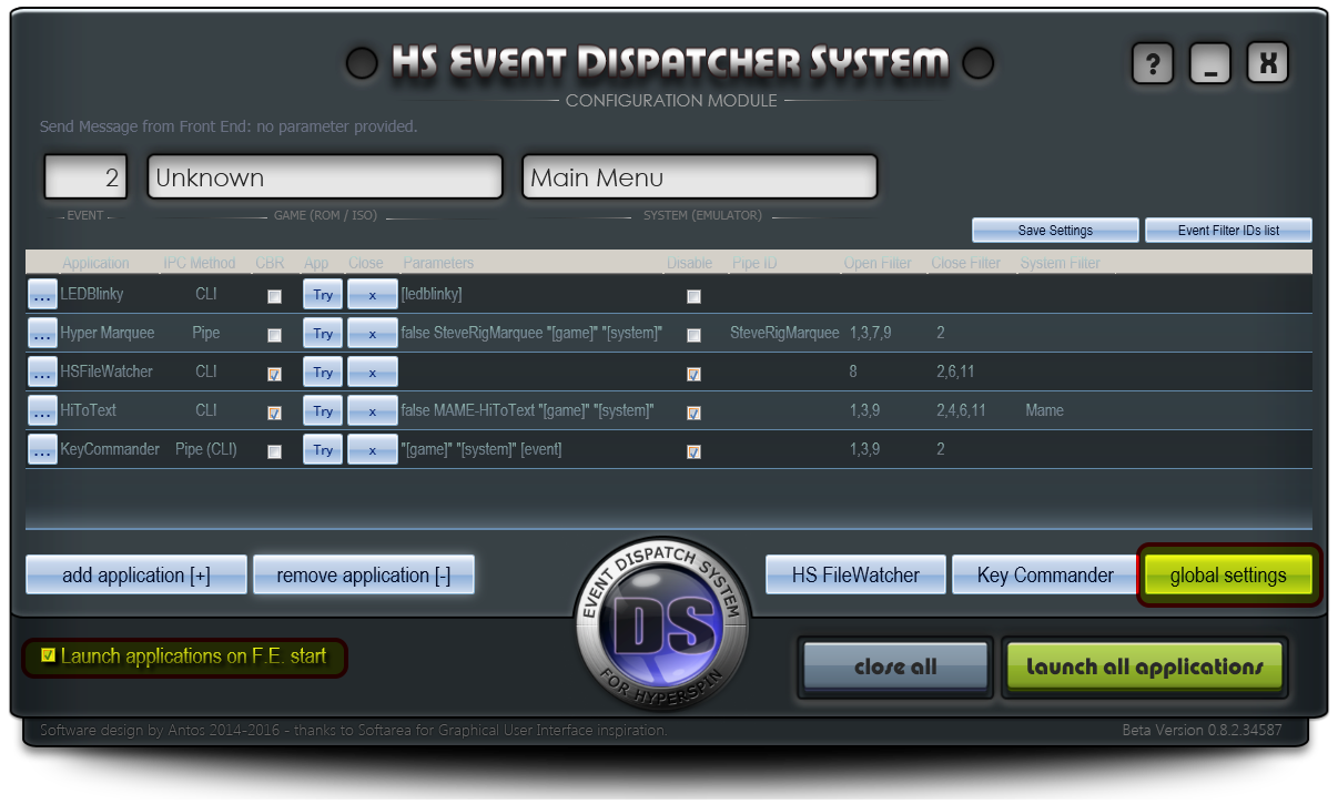

stevepel Posted January 29, 2021 Author Posted January 29, 2021 Appreciate all of the responses. @Spawk: Agree I seem to have the best results with launching all programs with FE start and have that option selected in EDS. I've been using pipe IPC for HM and CLI for LEDBlinky but am going to try switching HM to use Pipe (CLI) per schmucm's recommendation to see if that helps HM restart when EDS gets confused. Also the remaining EDS icons in the system tray appear to be just orphaned as they disappear immediately when I hover over them and I don't see any EDS processes running in Task Manager after exiting HS. I see in the EDS Read Me that it's an old bug the developer has been trying to fix for several releases and assume it's not related to my issue, but does give a sense for how many times EDS is restarting. @schmucm: The configuration for EDS to use relative vs. absolute paths is in global settings. I attached some screen shots of my exact setup. Thanks for attaching your log files. Definitely some differences which I'm going to dig into, probably in the way we have our events configured in EDS. In my case I want HM to change the displayed marquee when scrolling through systems and games. Part of what's making it difficult is EDS overwrites instead of appends the log file on each restart, so I'm trying to catch any errors real time by Alt-Tabbing out of HS. BTW I did some quick math and determined that the EDS log file timestamps are set to UTC, so you can correlate to the HS event log by applying your timezone offset (i.e. I'm in EST so had to subtract 5 hours). Not sure if relevant but also wanted to specify that I'm running on Windows 7 (64 bit) with HS 1.5.0 (the 1.5.1 update seems to have broken HyperHQ under Win 7) and the latest versions of EDS, HM, and LEDBlinky. Will keep playing around with this and post any additional findings.

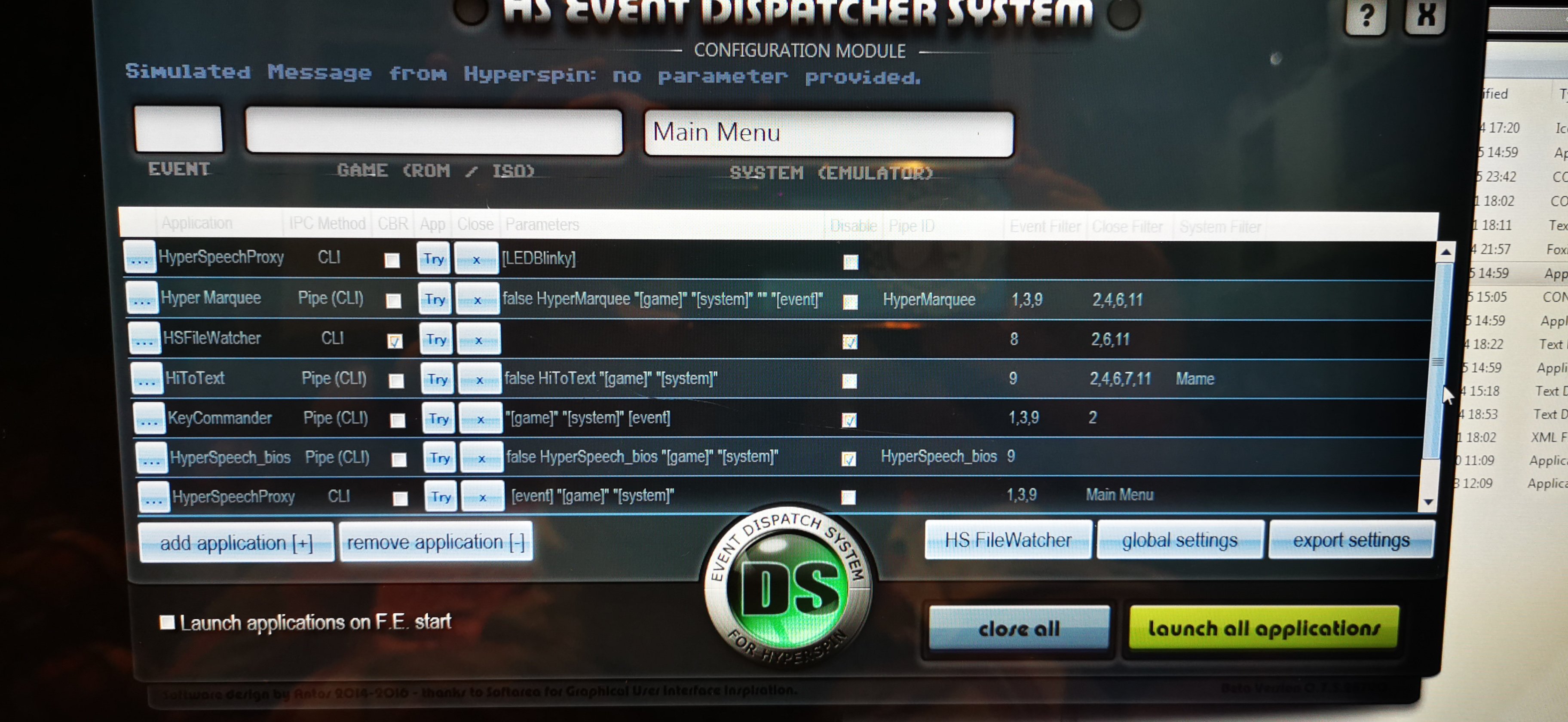

Spawk Posted January 29, 2021 Posted January 29, 2021 I run Win7 with 1.5.1 and yes I do notice that HQ will not always exit correctly. The UI disappears but if you check taskmanager the exe is still running. Not entirely broken though, just end the process and you can start HQ again. I guess I don't open HQ often enough to worry about it. I also just watched Ninja2bceen's video from his awesome "Planet Geekdom" youtube channel: He has HM set to CLI and the CBR (close before re-opening) checkmarked. I also notice he does not have "7" (system select) listed in the "Open Filters". Perhaps the "[event]" parameter handles this already?

stevepel Posted January 29, 2021 Author Posted January 29, 2021 So playing around with this a bit more it does seem the crash is happening shortly after game exit. Changing the IPC method for HM to Pipe (CLI) and increasing the Pipe Waiting Timeout from the 2 second default to 4 seconds seems to have helped. I'm running an i5 system at 3.2 GHz and 6 GB RAM and didn't think it was particularly slow but there doesn't seem to be any adverse effect of increasing this timeout (marquees still change quickly when scrolling or selecting a game). Will keep testing but after starting and exiting several games I haven't been able to reproduce the crash in a while. Plus when I exit HS normally I'm only seeing one "orphaned" EDS instance in the system tray. @gigapig: Thanks for that tip about the EDS_Settings.config file. I don't think mine has become corrupted but I have been changing settings quite a bit (which recreates the file) so maybe I've just been lucky. In any case, I made a backup and will try your suggestion if I see the crash again. Again - appreciate all of the help!
schmucm Posted January 30, 2021 Posted January 30, 2021 @stevepel, I had to laugh when I read your trouble with the logs. I was doing the exact same thing. As soon as it crashed, Alt+Tab to file explore to copy the log file. You and I are after the same thing: marquee changes as someone scrolls through the systems and games. I tried changing my path to relative and extending the pipe time like you suggested. I was still able to crash it after some scrolling. I am also running Windows 7. My settings look very similar to yours except I pass the [event] as well. I also have Open Filter 8 but that shouldn't be too big of a difference. @gigapig Thank you for sharing your setup. Do you know the significance of the 5th parameter? The ""? I thought I read HyperMarquee only takes in 5 parameters so am curious about passing 6th and what the "" signifies. Maybe it's one of those cases where it just works so don't touch it. I will also try replacing the EDS_configuration file.
