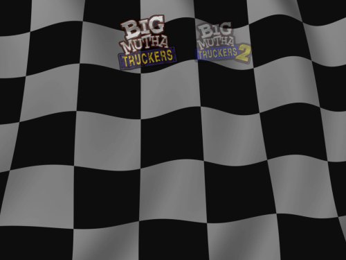

Andyman Posted January 8, 2024 Author Posted January 8, 2024 I had some free time today, so I updated the default theme on my Cruis'n World cabinet to match the one I'm using in my Mortal Kombat II cabinet. Having the wheels spin horizontally at the top and then stay visible on-screen while the preview video plays really completes the look and ties everything together nicely. I opted for a darkened checkered flag background to be displayed during attract mode and when scrolling through the collection. I really like it. I've included the theme and MAME.ini for anyone that wants this look in their setup. Enjoy! Default.zip MAME.ini
brudibru Posted January 8, 2024 Posted January 8, 2024 Nice effect, thanks for the share ! Playing the videos full screen is also a good idea for this collection with games from so many different systems. By the way, if you are willing to add some games to your setup, Xenia has made some good progress lately and along with X360CE the forza games could be playable with your cabinet : 2
