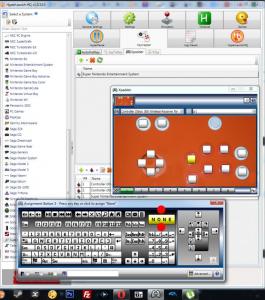

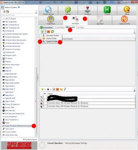

gigapig Posted July 13, 2014 Posted July 13, 2014 I'll fill out what Marxkemp has already said. 1. I'm not sure why you would need 2 controllers set up just to navigate HS, but in HyperHQ you can set up keyboard controls for the second player, so perhaps you set up the second player in xpadder and HLHQ. 2. It's a good idea to set up an exit emulator key or key combo, As you can see from this screen, I use Back & Start on the 360 controller and C & 1 on the keyboard (not at the same time of course.) Some emulators use esc to switch between full and windowed. There is also some good recent info here. So will you be launching Steam games from Hyperspin or Hyperspin from Steam BP? I'm sure you've seem Steam wheel creator etc, but here's something you may not have seen which may be of use. The link is for Balderdashians' latest ahk, you will probably need to read further back to see what it does. I'm not sure what djvj is planning for the next module release. but it may be something similar. http://www.hyperspin-fe.com/forum/showthread.php?26175-PCLauncher-Module&p=328036&viewfull=1#post328036 3. Answered by Marxkemp. http://www.hyperspin-fe.com/forum/showthread.php?28986-HyperSpin-Startup-Script

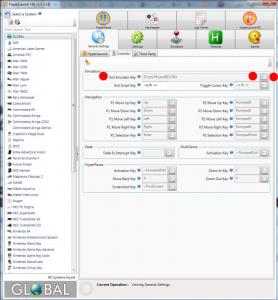

gigapig Posted July 14, 2014 Posted July 14, 2014 Here's some of my settings. For the Startup script I have this. [settings] HyperLaunch_Path=O:\HyperLaunch Hide_Cursor=false Hide_Taskbar=false [Keymapper] Keymapper=xpadder Keymapper_Enabled=true keymapperAhkExternalEnabled=false [Programs] Minimize_Background_Windows_Enabled=false Window_Classes_To_Not_Minimize=Shell_TrayWnd,Button Program_To_Run_Target_1= Program_To_Run_Working_Dir_1= Program_To_Run_MaxMinHide_1= Process_Name_To_Close_1= Xpadder options. You may want to mess with "Auto Open Last Profile" And adding a blank profile to a System. Firstly if I'm doing this wrong please someone let me know, I also find this a little tricky. Select your system from the left pane and select the Keymapper tab then the xpadder tab. From the top section click the green + You have 3 choices here, System, Game, and emulator. 1. System will load a profile for the whole system even if you are using multiple emulators for that system. This would be recommended for you unless you use more than one emu. 2. Emulator will load a profile for that emulator. 3. Game will load a profile for a chosen game. From the lower profile creation section click the green + and choose "1" for player 1 Xappder should pop up, make sure your controller is on and also xpadder is in the systray. click any button on the picture to assign a key, and this next menu should pop up. Here you can add a key you want to map or just click "None" if we are creating a blank profile. Finally click the save icon and your done. You can then test it by clicking the "Edit Selected profile" button.
