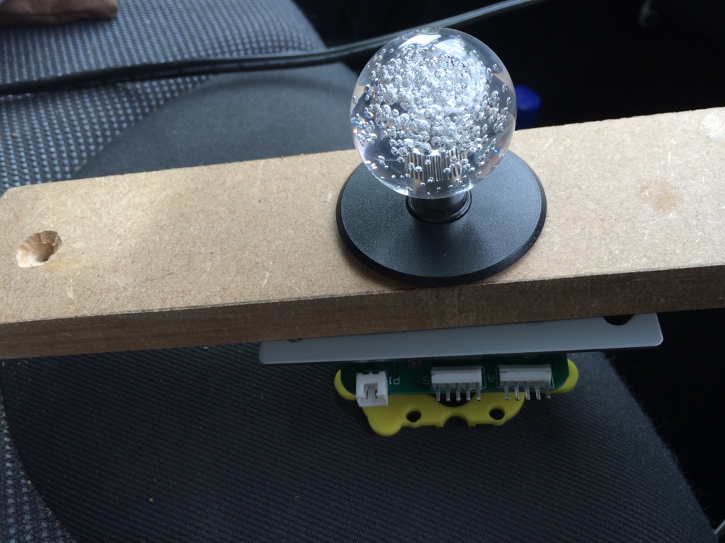

monkeychunkuk Posted July 20, 2014 Posted July 20, 2014 So I picked up these joysticks in a swap I want to mount them in one of my bartops The problem is I use 18mm mdf and as you can see by the picture the come up a little short I know some of guys mount them from the top but because of the artwork I don't want to go that route. So what are my options? Many thanks in advance Sent from the smut hut

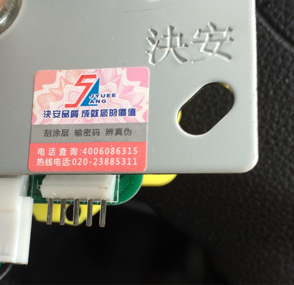

monkeychunkuk Posted July 20, 2014 Author Posted July 20, 2014 Yer I thought of that but the guy can't remember where he got them and I don't lniw the brand maybe Someone knows the make Sent from the smut hut

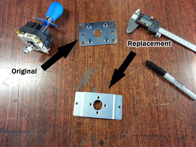

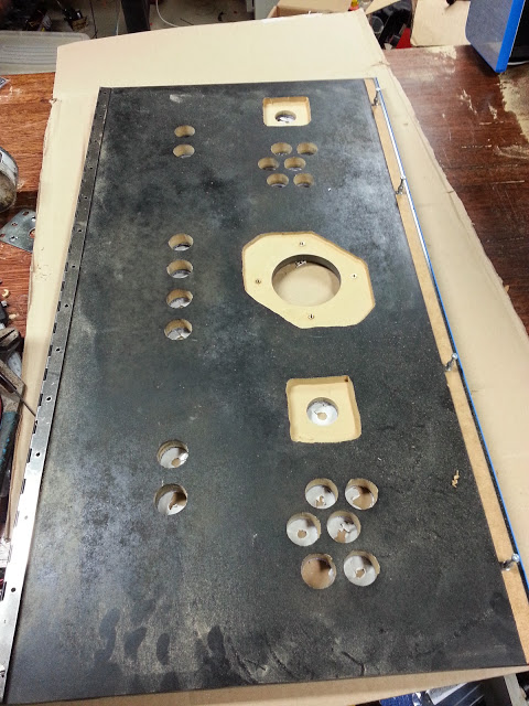

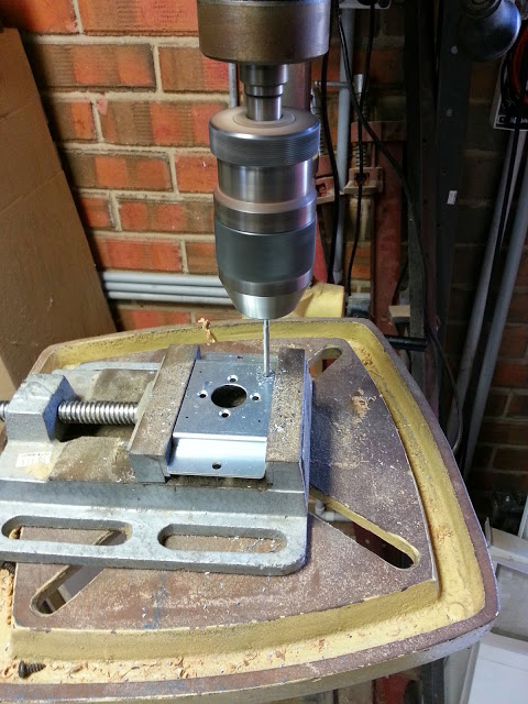

maxxsinner Posted July 21, 2014 Posted July 21, 2014 I had the same drama with my joysticks Monkeychunkuk and ended up rebating the back of the control panel to suit - Then I swapped the bracket over with ones from ebay the had an offset on them - I had to redrill the holes to line up but you can see the 6-8mm off set on this pic better - Which made it so I could use decent length screws into the panel to hold the joystick in place and still screw them in from the back. Hope that helps. Electropin - Enough lights to land a jet on an aircraft carrierHigh Voltage Pinball - Cause one build just wasn't enough Voltek Arcade - Funglo pedestal style mame cabinet Pinball Electrical Tutorial - Wire All Your Bling With Confidence and Fewer House Fires
monkeychunkuk Posted July 26, 2014 Author Posted July 26, 2014 That helps loads you did loads of work !! Thank you for your pictures Sent from the smut hut
