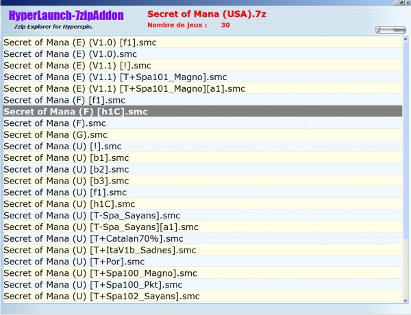

So now, when i add a "Secret of Mana.7z" instead of "Secret of Mana.scf" in my rom folder.
If i launch the rom with hyperspin i got this screen :
I can select the game with the arrow key, and launch it if i press ENTER.

Ok, i just make a new version.
The code is still ugly, but it work well. Better than expected.
Edit : New version with rar/zip support.

from your roms (I had to fix two things in the generated list, though. I had to add the header of the .xml file and I had to remove .7z
and something with (DES) from every game)
http://www.mediafire.com/?hjljgkmmmz4
You can just as well rename your roms to match your xml entries...
next, you have to rename your real hyperlaunch.exe to the fake name you set in the settings\_starter.ini (default: hyperlaunsch.exe ) and
extract hyperlaunch.exe, 7za.exe and settings\_starter.ini to your hyperspin directory.
Do _not_ just overwrite your hyperlaunch.exe - it's still needed to run the roms.
it's done - launch and enjoy the robust beauty of a white screen with black text and a blue selection line ^^
future versions:
*Guess and select the best match (U) is better than (J) and [!], etc...
Mark and save an even better match
*Don't show up if only one file in archive
!only show up if button is held down! -This is actually really difficult. Java will only tell me when someone presses a key, not if the key is already pressed at program startup. I guess I'll have to postpone this one until I have a better idea...
hide entries from the list
show hidden entries
change fonts, colors, etc.
possibility to prettify and soundify it
special thanks:
the hyperspin guys, the emulator guys, the hste guys and so on...
those ini reader guys are awesome, too!
known bugs:
when I run hyperlaunch 2.25, the exit-key only works for my snes emulator but is ignored for everything else. But it _does_ get caught since I don't see the emulator's menu appear. But it could also be an error in my modules.ahk or something - I just downloaded them and didn't play around with anything and it also happens if I just use the new hyperlaunch with normal name and everything...
