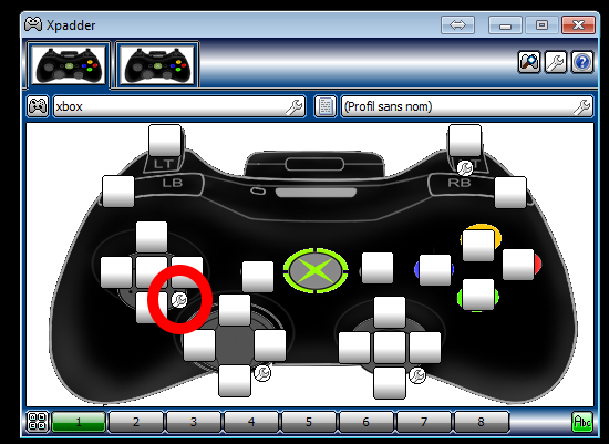

blaudo Posted July 31, 2014 Author Posted July 31, 2014 Not necessarily problems, but lets say in order to allow NullDC for dreamcast to work with both xbox360 controllers and the joystick buttons, i had to set my joystick buttons as the controller for NullDC, then use xpadder to emulate keyboard keys with my 360 controller. I just found that doing this through xpadder made the analog stick on the 360 extremely sensitive as opposed to connecting it directly to NullDC and not having a connection with my arcade buttons.

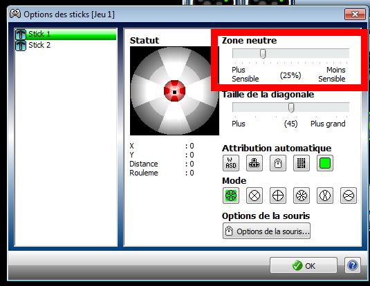

BassSpleen Posted July 31, 2014 Posted July 31, 2014 I just found that doing this through xpadder made the analog stick on the 360 extremely sensitive What if you use the xpadder sticks settings ? Select Options Try to move that setting the way it's best for you.
blaudo Posted August 1, 2014 Author Posted August 1, 2014 My joysticks are connected to an ipac. I tried adjusting the dead zone, but that just makes my xbox controller less sensitive in the middle.. which is still problematic for driving or shooting games when i only need to move the left analog stick only slightly.
