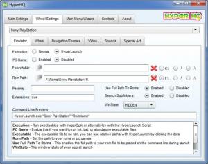

gigapig Posted August 13, 2014 Posted August 13, 2014 What extension are your Roms, are they archived? What extension did you add in HyperHQ

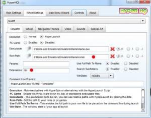

gigapig Posted August 13, 2014 Posted August 13, 2014 So it should look like this if your Images are archived (zip or 7z) If they are extracted and in separate folders then you might have a problem unless everything is in 1 folder. That being the case you would then use the "cue" extension. Your other option is to create an xml based on the Rom you have, using Hypertools.
muppets4 Posted August 13, 2014 Author Posted August 13, 2014 You are sure you set the rom path in hyperhq for sony playstation? I am sure it is correct. It's like the picture from gigapig. And everything works through HyperLaunch AND if I uncheck the 'roms only' option also in Hyperspin. That leads me to the conclusion that I have the correct settings.

ghutch92 Posted August 13, 2014 Posted August 13, 2014 I am sure it is correct. It's like the picture from gigapig. And everything works through HyperLaunch AND if I uncheck the 'roms only' option also in Hyperspin. That leads me to the conclusion that I have the correct settings. Can you post a screenshot of the settings that you have in HyperHQ (not HyperLaunchHQ)? Sometimes it's as simple as removing periods from the file extension or adding a missing backslash. How to Install HyperSpin and more RocketLauncher HyperSpin Startup Script
