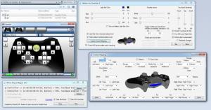

zero dreams Posted September 5, 2014 Posted September 5, 2014 Just wanted to add that I use two Dualshock 4's with my setup and there are two programs you can choose from to emulate the 360 controller. You have the DS4Windows & DS4Tool. I believe the most common is the DS4Tool but the DS4Windows is pretty extreme in terms of what it's capable of. It includes button mapping in the same fashion as xpadder that do automatically layout on program launches. I did not set this feature up but it's there. My HyperSpin profile was just simple and plain keyboard to xpadder profile that I set as my frontend profile in HyperLaunchHQ. HyperLaunch | HyperWiki | HyperSearch | Intro | Evolution | FadeProject | Checker | Steam Wheel
guyverjay Posted September 6, 2014 Posted September 6, 2014 Just wanted to add that I use two Dualshock 4's with my setup and there are two programs you can choose from to emulate the 360 controller. You have the DS4Windows & DS4Tool. I believe the most common is the DS4Tool but the DS4Windows is pretty extreme in terms of what it's capable of. It includes button mapping in the same fashion as xpadder that do automatically layout on program launches. I did not set this feature up but it's there.My HyperSpin profile was just simple and plain keyboard to xpadder profile that I set as my frontend profile in HyperLaunchHQ. Do you have any problems with input lag or the loss of blutooth connectivity??? I seem to have this annoying issue all the time with DS4's
zero dreams Posted September 6, 2014 Posted September 6, 2014 I've never experience any lag with either program but I my bluetooth does dropout after about 20 minutes with DS4Windows. I'm using the free 1.4.40 version and I also suspect that my bluetooth might not meet his specs being the culprit. Having it drop out constantly I reverted back to the DS4Tool which works perfectly. HyperLaunch | HyperWiki | HyperSearch | Intro | Evolution | FadeProject | Checker | Steam Wheel
guyverjay Posted September 6, 2014 Posted September 6, 2014 I've never experience any lag with either program but I my bluetooth does dropout after about 20 minutes with DS4Windows. I'm using the free 1.4.40 version and I also suspect that my bluetooth might not meet his specs being the culprit. Having it drop out constantly I reverted back to the DS4Tool which works perfectly. Do you use xpadder or map the emu directly?
zero dreams Posted September 7, 2014 Posted September 7, 2014 Xpadder and my profile for both controllers is just the duplicate of keyboard commands set for player 1 in HyperHQ. As far as I'm concerned, joystick support for HyperSpin doesn't exist without Xpadder. Controllers through the DS4Tool to all emulators is how my setup is configured. Even though Xpadder works great, I still want to limit how may time my key presses are getting mapped over so I try to use it as little as possible. The ability to map the PS button to any key is an excellent feature to use with DS4 windows as I mapped it to esc to exit emulators and then had very little need to ever use Xpadder. Edit: Just wanted to make sure, they both can map the PS button to esc. Just now tried it out. HyperLaunch | HyperWiki | HyperSearch | Intro | Evolution | FadeProject | Checker | Steam Wheel
guyverjay Posted September 7, 2014 Posted September 7, 2014 Xpadder and my profile for both controllers is just the duplicate of keyboard commands set for player 1 in HyperHQ. As far as I'm concerned, joystick support for HyperSpin doesn't exist without Xpadder.Controllers through the DS4Tool to all emulators is how my setup is configured. Even though Xpadder works great, I still want to limit how may time my key presses are getting mapped over so I try to use it as little as possible. The ability to map the PS button to any key is an excellent feature to use with DS4 windows as I mapped it to esc to exit emulators and then had very little need to ever use Xpadder. Edit: Just wanted to make sure, they both can map the PS button to esc. Just now tried it out. I use xpadder for all my emus. Not sure what's going on, my ds4 will stay connected indefinitely when I'm not using a emulator but as soon as I do it will begin to lag more and more until it disconnects completely. Driving me nuts
zero dreams Posted September 8, 2014 Posted September 8, 2014 My process was to have the DS4Tool on at all times while using the controller so the red & blue lights could easily distinguish between p1 & p2 controllers and also allow me to map the emulated 360 controller to all emulators. Even if controller ids were to reverse on the controllers the affect would still be the same as blue is p1 and red is p2 which the emulators would still recognize. This gives me only a single application between my button press and the response. Unless there is a special function I need to map from the emulator, PC related, or has multiple controller layouts like MAME and other arcade type systems, the only reason keymapper is enabled for all of my systems is the HyperLaunch profile which controls HyperPause. Below is a snap to show a couple things: 1.) HyperPause layout which controller 1 & 2 are using the same exact controls like I did with my HyperSpin profile. Using the 360 controller image also keeps everything in mind that I'm emulating the controller when mapping. I created one with the Dualshock 4 image and it just fits better this way. 2.) I'm using the DS4Tool and I've mapped the PS button to escape and the Multitouch touch to NumpadAdd for HyperPause activation. This effectively allows me to map most emulators directly and still keeps the fuctionality of HyperPause and and exit method. At the same time I can still use the touchpad as a mouse perfectly and left click with it, which is nice for DS, Steam, etc. 3.) Somebody somewhere can figure out how to use the gyro thing with Dolphin as a Wii controller. HyperLaunch | HyperWiki | HyperSearch | Intro | Evolution | FadeProject | Checker | Steam Wheel

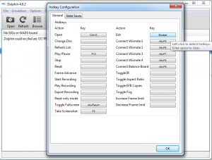

zero dreams Posted September 9, 2014 Posted September 9, 2014 Ghutch is right again but I had to change the hotkey to exit for Dolphin. I'm using Dolphin 4.0.2 and I went to options>Hotkey Settings>Stop and cleared it and then mapped Exit to Escape. HyperLaunch | HyperWiki | HyperSearch | Intro | Evolution | FadeProject | Checker | Steam Wheel
Mister Squirrel Posted September 9, 2014 Author Posted September 9, 2014 I've even tried that but still doesn't work
