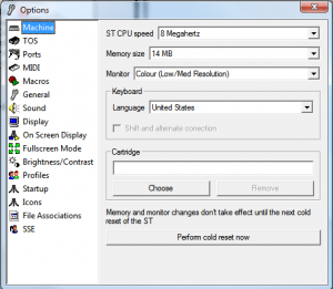

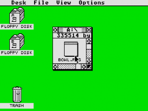

Emu54 Posted September 23, 2014 Posted September 23, 2014 Hi trying to set up Atari ST tried both steem and hatari getting really bad lines down screen and loads Atari ST desktop not sue if that bit is right out of the 2 what do u think is best and an one seen a guide to setting it up thanks.
rfancella Posted September 23, 2014 Posted September 23, 2014 Emu54 said: Hi trying to set up Atari ST tried both steem and hatari getting really bad lines down screen and loads Atari ST desktop not sue if that bit is right out of the 2 what do u think is best and an one seen a guide to setting it up thanks. I have it running using Steem. I could not get Hatari working and Steem was easy, so I chose that one. Some of the games do not boot directly to the game. Some you have to double-click the icon to start them. But the game icon should be on the screen when it boots: Also, launch the emulator and go to the Machine Options. Be sure the Monitor is set to Colour (Low/Med Resolution): If this does not resolve the issue, please post your HyperLaunch log as described in this post: http://www.hyperspin-fe.com/forum/showthread.php?31072-The-HyperNoobie-Guide-For-Posting-To-The-Fourm Thanks, Ron Code Monkey and all around Command Line geek!If you like what someone has said or done for you, be sure and 'Thank' them. And if they changed your life, send them a Beer!

Emu54 Posted September 23, 2014 Author Posted September 23, 2014 Getting there running steem not in hyperlauch I tick v sync and display is sorted no sound and joy stick was working must of messed that up I have xbox controller
Emu54 Posted September 23, 2014 Author Posted September 23, 2014 Getting there running steem not in hyperlauch I tick v sync and display is sorted no sound and joy stick was working must of messed that up I have xbox controller and as always thanks rfancella Sound sorted controller sorted I think is there only 1 firebutton for Atari ST
SIMPLYAUSTIN Posted September 23, 2014 Posted September 23, 2014 I just seem to get the ST desktop. I think its something to do with the file type? Simply Austin's YouTube
rfancella Posted September 23, 2014 Posted September 23, 2014 austin585 said: I just seem to get the ST desktop. I think its something to do with the file type? Could be. If your roms are zipped, be sure and enable 7z in HLHQ. What are the file extensions you are using (inside the zip files)? Thanks, Ron Code Monkey and all around Command Line geek!If you like what someone has said or done for you, be sure and 'Thank' them. And if they changed your life, send them a Beer!
Emu54 Posted September 24, 2014 Author Posted September 24, 2014 My roms zipped all works in HyperLaunchHQ odd game goes to atria st desktop the only thing now is the joystick I have xbox controller but only allows 1 fire button I had this prob when I tried Amiga years ago that is my next emu for hyperspin. Games like Turrican (1990)(Rainbow Arts) think only way to play is keyboard and joystick unless any one no of a other setting

SIMPLYAUSTIN Posted September 24, 2014 Posted September 24, 2014 Mine are in .ipf format. I think they need to be in .st format to work ok? I have .st type games too but they are not labeled correctly Simply Austin's YouTube
rfancella Posted September 24, 2014 Posted September 24, 2014 austin585 said: Mine are in .ipf format. I think they need to be in .st format to work ok? I have .st type games too but they are not labeled correctly ipf should work just fine. Most of mine are .st, but I do have some that are .ipf and they work also. Just be sure and add that extension in your GLOBAL Emulator settings. Thanks, Ron Code Monkey and all around Command Line geek!If you like what someone has said or done for you, be sure and 'Thank' them. And if they changed your life, send them a Beer!
