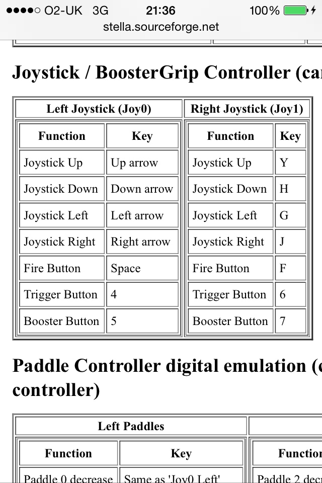

potts43 Posted October 22, 2014 Posted October 22, 2014 In stella it was possible to select the difficulty level - anyone know which keys do this in RA stella core?

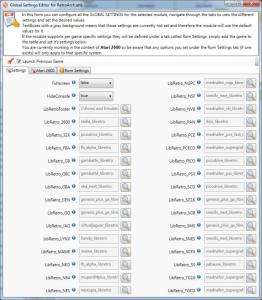

klizine Posted October 24, 2014 Posted October 24, 2014 gigapig said: What I do is.Start RA, go to "Core" and choose the the required core. Back out and then save the new config and then close RA. Go into the config folder and find the config that was just created and rename it to the system name. I then fire up HLHQ and double or change the path to the core. Sometimes 2 or more are available, (like for Atari Lynx you can use the Mednafen core or he Handy Core; the Mednafen core crashes for me) so point to the core in the core folder. Also check you have downloaded or the cores, as some could be missing from your install. Once a game loads you can press F1 or the Xbox button and mess with shaders etc. Change which path?
potts43 Posted October 24, 2014 Posted October 24, 2014 klizine said: Change which path? Think gig means in global module in HLHQ
gigapig Posted October 24, 2014 Posted October 24, 2014 klizine said: Change which path? Potts is correct I meant these, at least double check them.

gigapig Posted October 24, 2014 Posted October 24, 2014 potts43 said: There is a feature to select game difficulty a or b on an Atari 2600. It is clearly definable in Stella's options. However, in Retroarch only "difficulty a" is defined for the q key but it took me quite some time to work out the difficulty b was set to "nul". The player 2 controls are all nul. I've searched but can't find any reference documentation for controls defined/available per core. Many thanks By default for me at least the level or difficulty select button is defined to the Back button on the 360 controller and Start is the Start button. The keyboard controls for these are Start=Enter and R Shift is Game select. input_player1_select = "rshift" input_player1_select_btn = "nul" input_player1_select_axis = "nul" input_player1_start = "enter" input_player1_start_btn = "nul" input_player1_start_axis = "nul"
potts43 Posted October 24, 2014 Posted October 24, 2014 gigapig said: By default for me at least the level or difficulty select button is defined to the Back button on the 360 controller and Start is the Start button.The keyboard controls for these are Start=Enter and R Shift is Game select. input_player1_select = "rshift" input_player1_select_btn = "nul" input_player1_select_axis = "nul" input_player1_start = "enter" input_player1_start_btn = "nul" input_player1_start_axis = "nul" Thanks for that. You would think that there would be documentation for each core to show what features/key bindings are available. Seems very scarce.
gigapig Posted October 24, 2014 Posted October 24, 2014 potts43 said: Thanks for that. You would think that there would be documentation for each core to show what features/key bindings are available. Seems very scarce. As I may have already mentioned the key bindings only change when I edit the dll.cfg (stella_libretro.dll.cfg) I have just changed rshift for select to "q".
potts43 Posted October 24, 2014 Posted October 24, 2014 gigapig said: As I may have already mentioned the key bindings only change when I edit the dll.cfg (stella_libretro.dll.cfg) I have just changed rshift for select to "q". I'm not sure I'm being understood...if you go to the stella home page and look at the user manual it clearly shows all of the features and key bindings. Without knowing what features are supported by Retroarch stella core how do you know if you can bind a key to do the same thing in RA as in stella. Here are 2 demo pics Eg without having ever played a real 2600 or using stella I wouldn't even know there were two difficulty levels in RA stella core never mind the other options. Does this make sense now?
